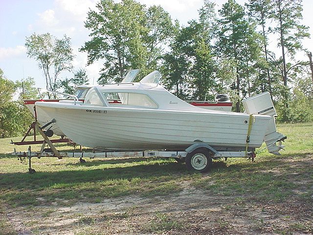

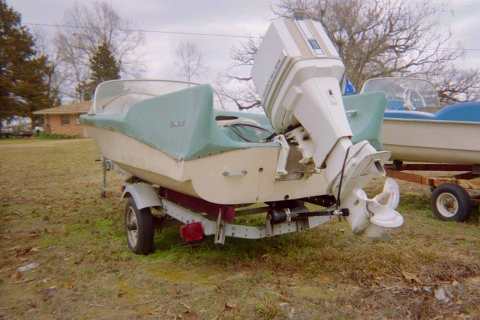

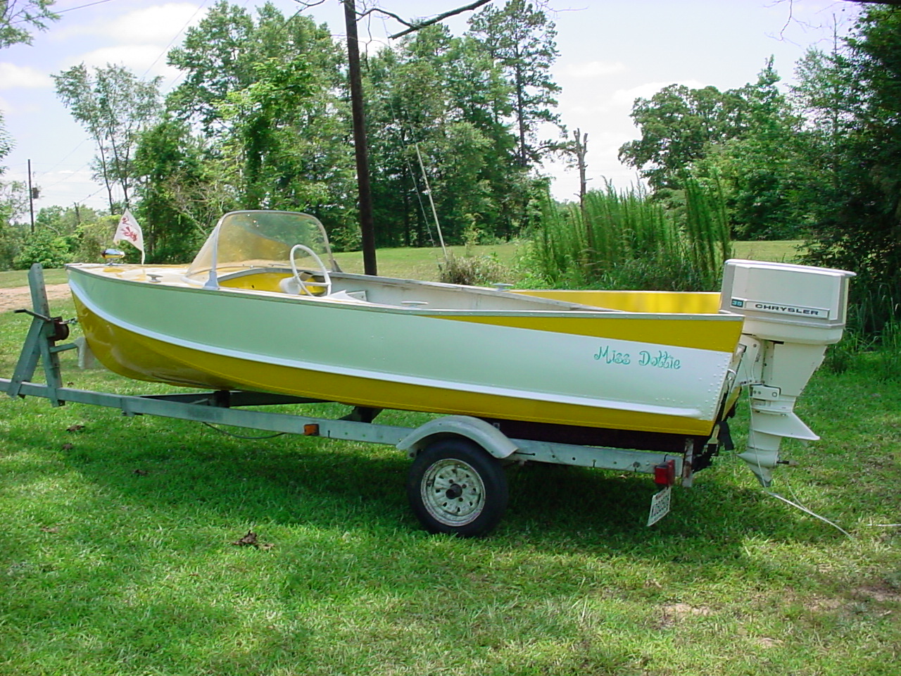

Re:Chrysler motor? Are they good? 16 years 7 months ago #2905
LakeLBJ TX Maid wrote:
Hey doug are all those your boats or ones you have worked on . Well there very nice looking ones anyways.
Thanks again
Matthew
They are all mine.. just a few of the heard unfortunately. lol BTW, here's a great source for anything Chrysler marine related... www.chryslercrew.com/
