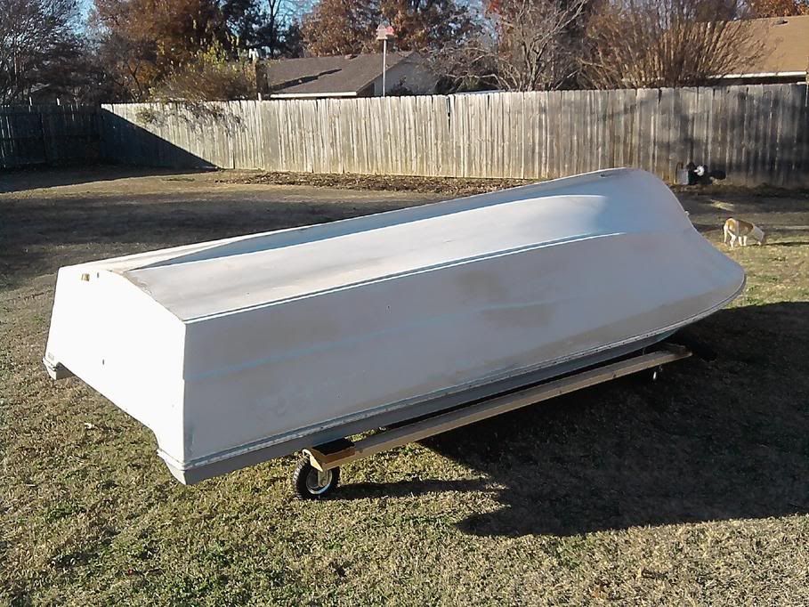

I built this cradle for my boat so I could work on the bottom of the hull. I works great! Rolls easily around the back yard. Total cost was $50.00
