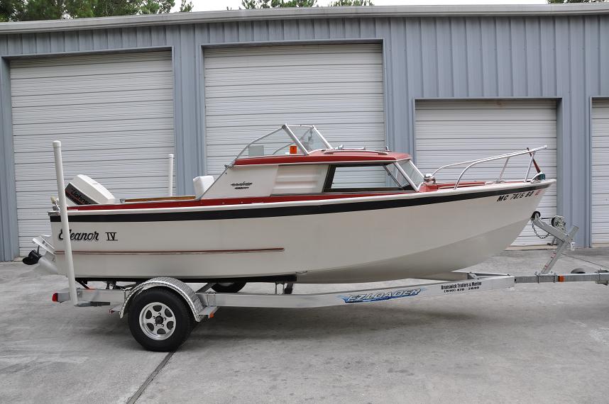

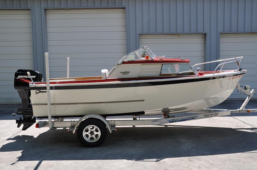

Here are some BEFORE and AFTER photos of our 1960 Glasspar Seafair Sedan which had a complete hull restoration this past year:
BEFORE:
AFTER:
