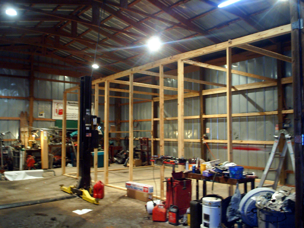

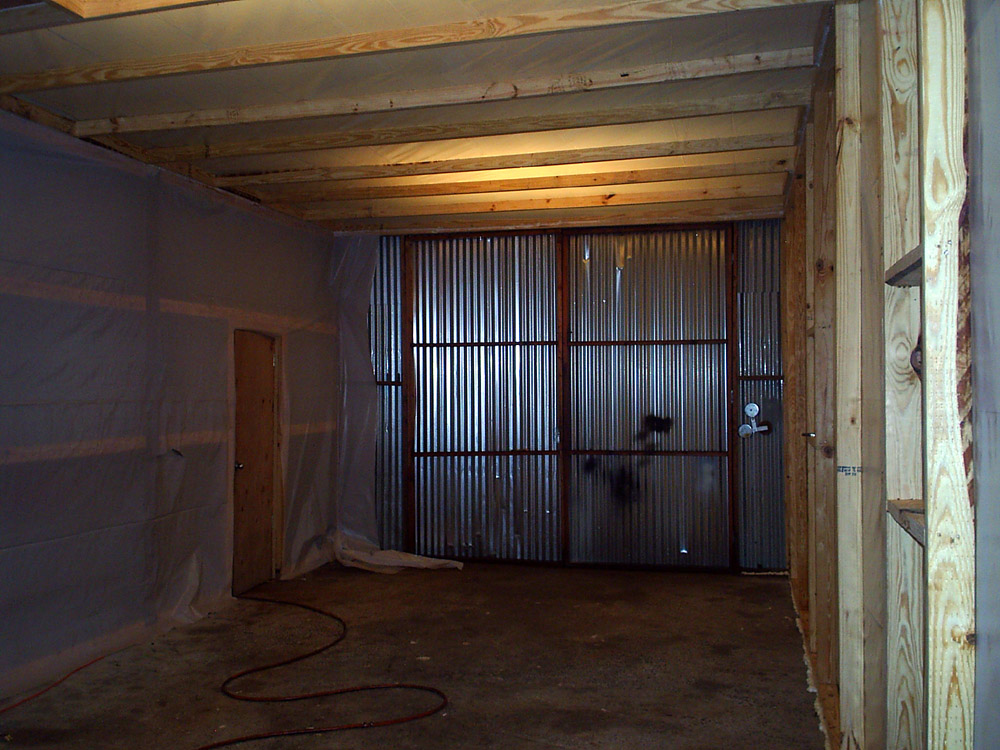

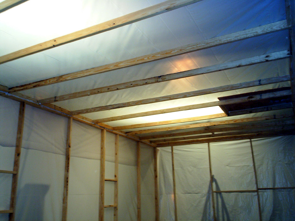

Spent the last few days building a 30-L x 10-H x 15-W spray booth at our shop.
Still some work to go and should be finished up and trimed out by weeks end.

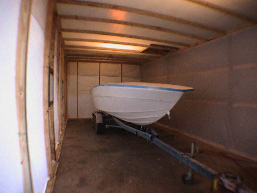

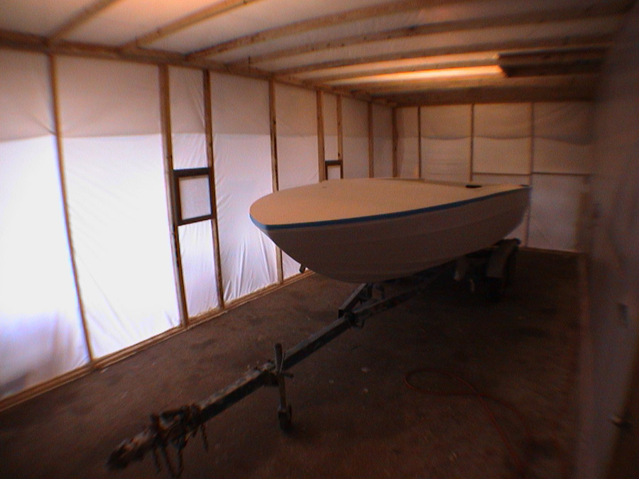

Thanks every one. Well I am set to paint a project. Did some touch up primer work just to see how the up draft was.. It's good. All the over spray just lifts right up and out. I am going to be enclosing it in something more permanent than plastic very soon. Just needed to get it operational for a big paying job.

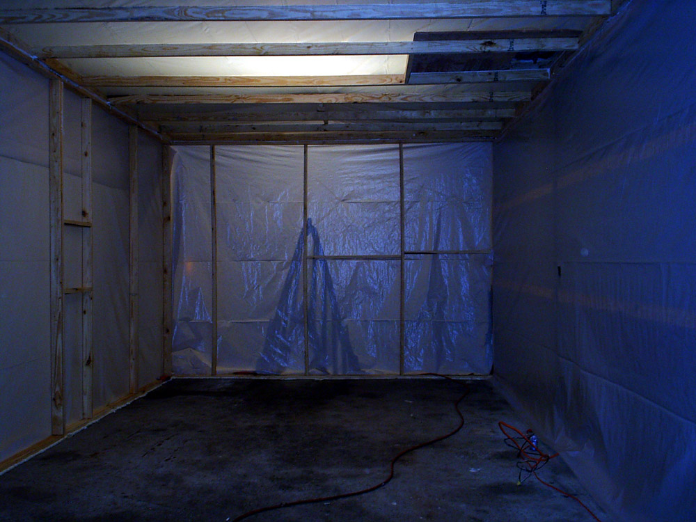

Re:Building a new spray booth. 16 years 7 months ago #2529
Couple of thoughts. You need strong lighting. Don't see any in the booth. I see a lot of booths with banks of flourescent lamps.That plastic will create a LOT of static charge and be a dust magnet, a paint jobs worst enemy. But the booth looks good. Suggest for ventilation you pull air OUT of the booth and have good quality inlet filters for air coming in.

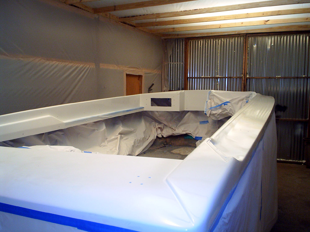

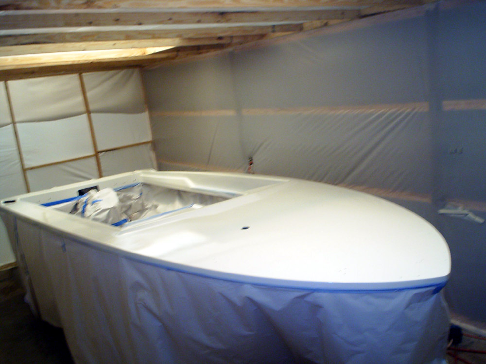

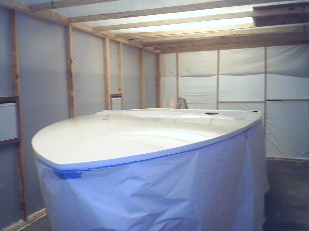

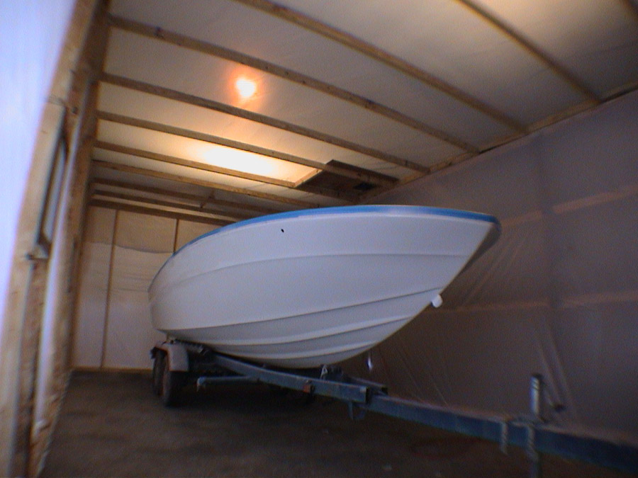

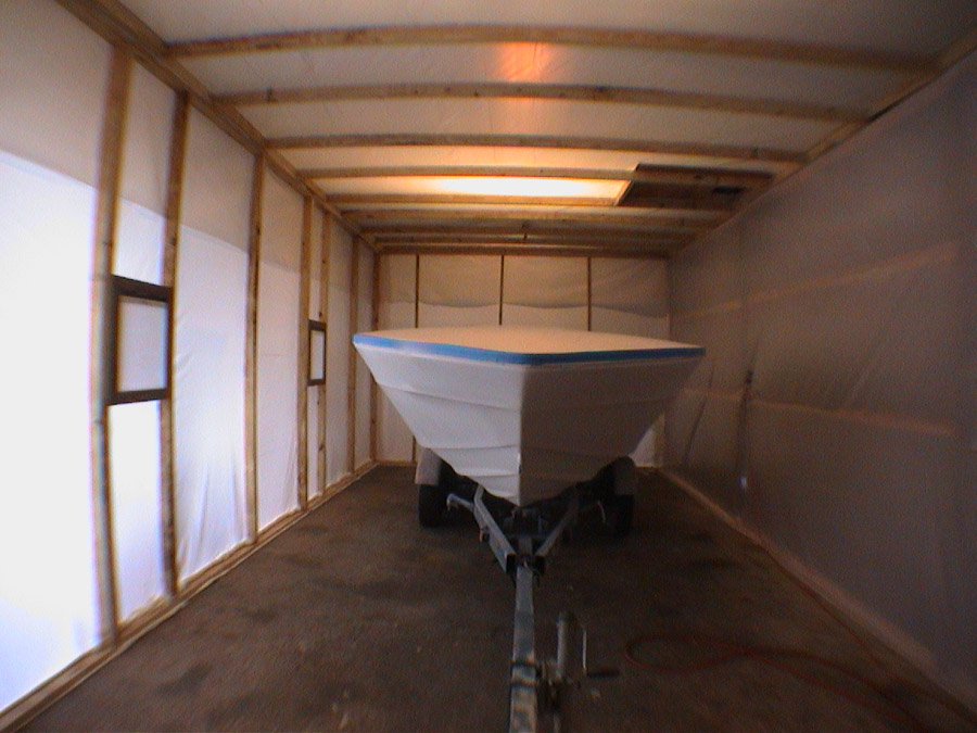

Thankyou for all the advise concerns and suggestions guys. This is not my first time at doing this. We have had a smaller 12x24 version of this same setup for years. Any way..... TO THE POINT!!!!
Today, We broke in the new booth. The updraft system worked flawlessly. Hardly a fog of over spray at all as we put down the last primer coats on the SRV-190. I think I need 2 more intake filters as I am still pulling a substantial vacuum once the door is close. I know, I want some but It's still to much I could put in 2 more filters and I think that will do it. Here are some photos of the primer just after getting put down tonight.
Mrs Spookeay Bird
