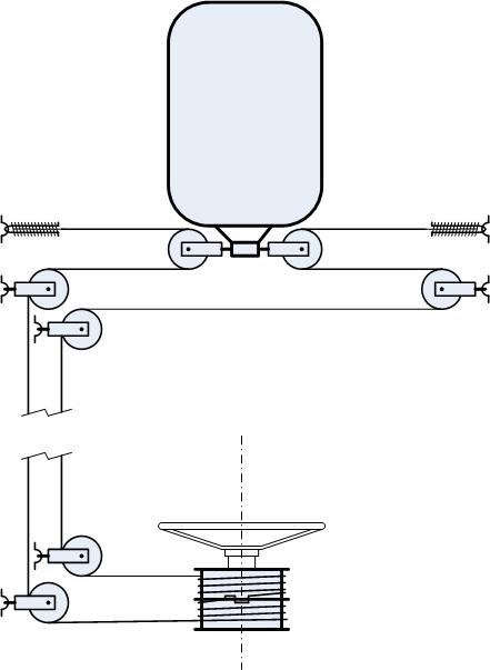

I'm thinking about sticking with my original cable and pulley steering system.
Before I settle on it, what do you guys think?
It isn't a matter of money but it may retain the original "feel" for the boat's 1960s handling and look.
What are the pros and cons between cable/pulley steering VS Uflex and Teleflex style Rack & Pinion?
Is there safety issues with the cable and pulley system? Or is the rack and pinion just a new fangled way of doing it? lol ;)

There is nothing wrong with the " tiller cable " system.
You need to use quality components like " tller cable " and not clothes line that looks the same.

You asked, so I'll toss my hat in here. At speeds below 15 mph, (which is just off-plane for most boats) cable & pully is swell. It is simple, original to many boats, nice and smooth, and you can use one finger to steer the boat.

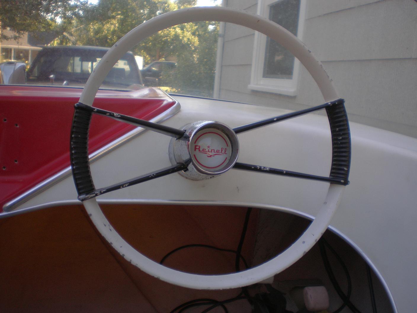

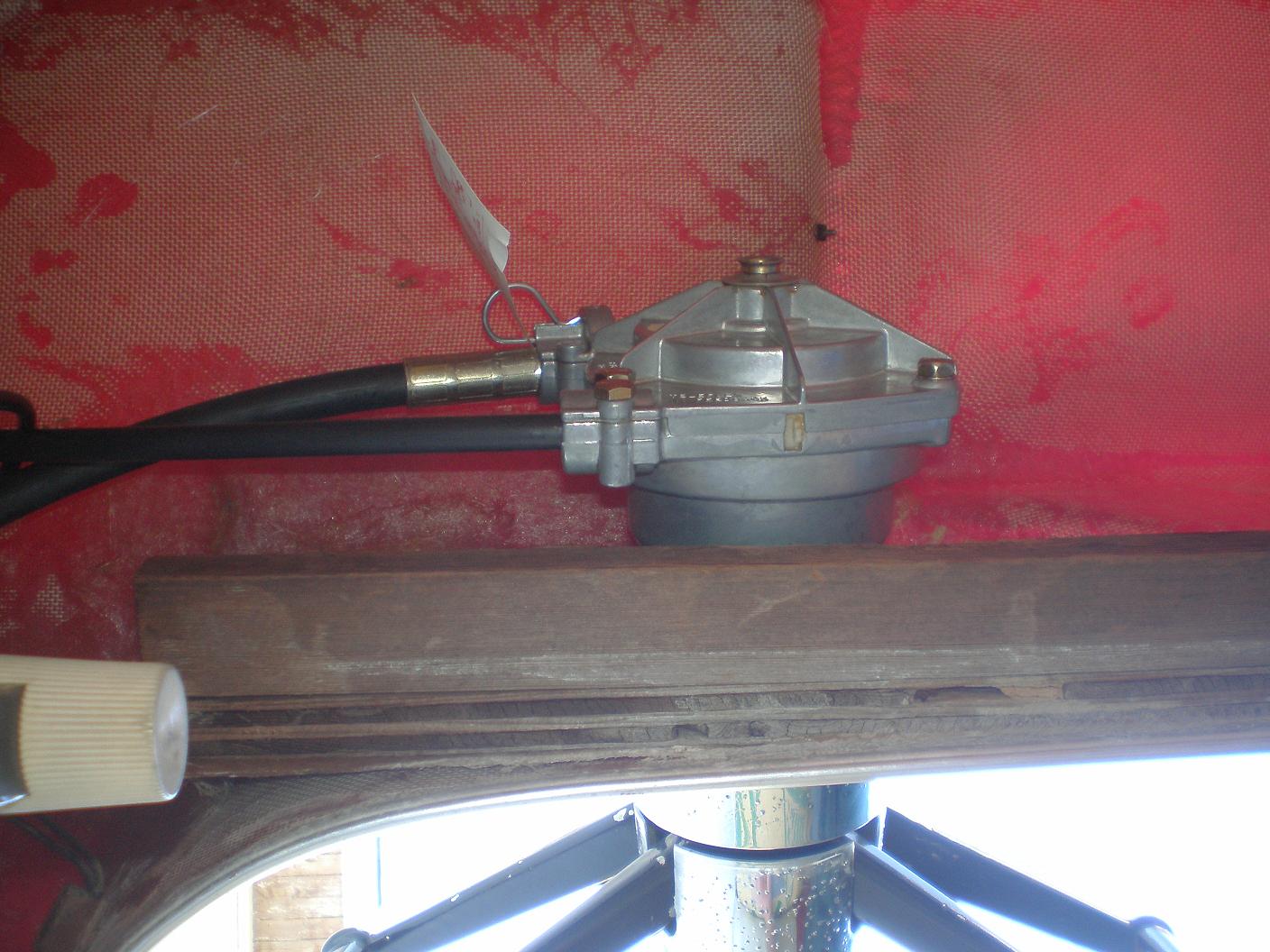

Push - pull systems are nothing new. Keikheafer started using them way back in the late 50s. They are better and safer - regardless of what anybody may claim. There is a reason the cable & pully system became obsolete in the 60s. Rack and pinion steering isn't the only option. You could also use a rotary helm, which is what I prefer. Either of these systems can be used in a boat that has the room behind the dash for the mechanisim. If you are clever, the old bezel and steering wheel can be used or modified to work with the new helm. That is how I do it. No plastic "smurf" wheels for my boats.
To be fair, torque steer will also happen to push pull systems. This is why "no feedback" systems have been popular as late. I put one on my Reinell, and it is amazing. Set the wheel & don't mess with it. The only complaint I & many people have is that the wheel can feel a bit stiff to turn. I'm getting used to it, and would never go back.
