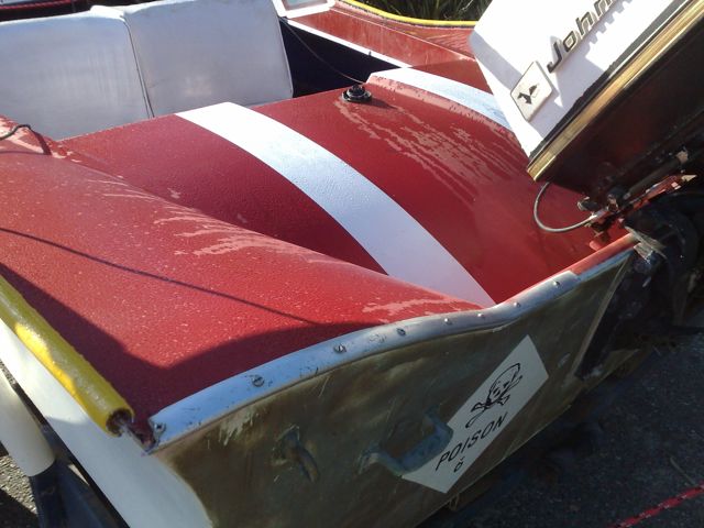

Hi all ,
My boats has had the gunnel rubber replaced with garden hose that has been split with a knife . I'm looking to replace it . I was wondering if anyone had a picture or the dimensions of the original rubber or moulding .
Is the original like what's on the transom , gotta get rid of the yellow stuff!
Cheers , Steve

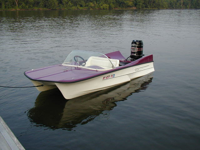

Re:American Marc Stardust/Heydon Hydrodyne 16 years 8 months ago #2394
Heres a picture

Re:American Marc Stardust/Heydon Hydrodyne 16 years 8 months ago #2400
It's difficult to see in the photos provided but the top to bottom joint appears to be a lip joint; essentially two flat surfaces that meet and are either stapled or screwed together. If that is the case, then WEFCO Rubber's die #1/2G should work. They have several different sizes they can fax cross sections to you. The 1/2G fits the Custom Craft Manta Ray, which is also a lip joint.

Re:American Marc Stardust/Heydon Hydrodyne 16 years 7 months ago #2552
You gotta' admit, the hose is an economical alternative!
Your Stardust originally had an aluminum U channel bump rail along the seam of the hull. This was a bullnose trim about 5/8" to 3/4" inches deep. There were barbs inside the channel to make it hold in place. The top and bottom hull are bonded, so the channel was not structural. The channel ran to the bow, and disappeared under the center bow aluminum casting. At the end of the hull, there were little cast aluminum caps that fit over the channel to terminate it. The upper portion of the boat had a molded cap that covered the top of the transom. at the outer edge the transom had a 90 degree corner bead of aluminum about 5/8" X 5/8" that was formed to the contour. This was held in place with rivits.
