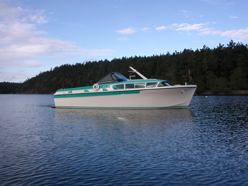

I launched my 1959 Skagit 31 Saratogan after 22 year restoration on October 4, 2010. It was actually 37 years on the hard. It's the third and last 31 built and the only restored Saratogan.
Her sister ship, hull one which was launched in 1957 was the largest all fiberglass production cruiser built at the time. Don't think the record stood for very long, though.
It's powered by twin Volvo Penta TAMD41 200 Hp turbo diesels. 2:1 reduction, 8 degree down angle reverse gears turning 18 X 21 Dynaquad propellers. She's fairly fast, 18 knot cruise and 28 knot tops. She'll plane out to 14 knots on one engine, pretty unusual! Very smooth and soft riding.
I posted some pictures in the gallery. Check it out.
More on this boat later.
Tim

Thank you for bring this beautiful boat back, and for the pictures.
Now for my ignorance, what is the function of the third prop coming from the keel?
Re:1959 Skagit 31 Saratogan launched after 22 years 15 years 9 months ago #22830
  • McSkagit
  • McSkagit's Avatar Topic Author
  • Posts: 15
  • Karma: 6
The third propeller is an electric "ghosting motor". Use it for trolling or silent running. I'll be taking people out on nature cruises, so will be able to shut down the diesels and make 4 to 6 knots on electric power. Propeller is variable pitch and full-feathering. Hydraulic ram is pitch control. Tim

The ghosting motor is my own creation. Prior to my ownership, the twin V-8s were removed and a single diesel bus engine was installed.
A center sterntube was installed and the keel lengthened. That repower was never completed.
I decided to go back to twins, which left the center sterntube unused. What to do with it? Ghosting motor was the answer. The motor is a WWII aircraft generator....makes about 10 HP on 24 volts.
