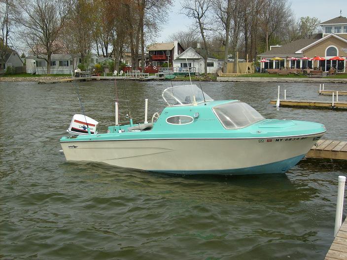

Im looking for the front windshield for the cabin for my 62 Arkansas Traveler Vanguard '17. It seems to be a rare boat to find and ive been searching for awhile for a replacement. Does anybody know where i might find one? Please email me with any information you may have thanks Jerry

Very good looking cruiser Jerry. Welcome to FG, and good luck with your search for a windshield.

Great boat! You probably won't be able to find a new one. What usually has to be done is to remove your current windshield and take it to a large plastic sign supplier that vacume forms signs. They can use the original as a mold and make a new windshield to match. Usually runs around $350 and up from what I've heard others say.
If it's just cloudy and not broken you should be able to polish it up fairly easy. Here's a link one of our members posted on the process he used for polishing.

thanks for the info, unfortunatly the windshield is cracked completly from one side to the other, ive polished it with mcguires 2 step polishing compound for lexon. Ive take it out when i first got the boat and took the windshield to two glass dealers in my area, they wernt able to help me, Ill continue my search thanks

Very cool boat...
A good resource for replacement windshields is UPD plastics-
www.updplastics.com/
If you can't find anyone local, they can probably help you out.
