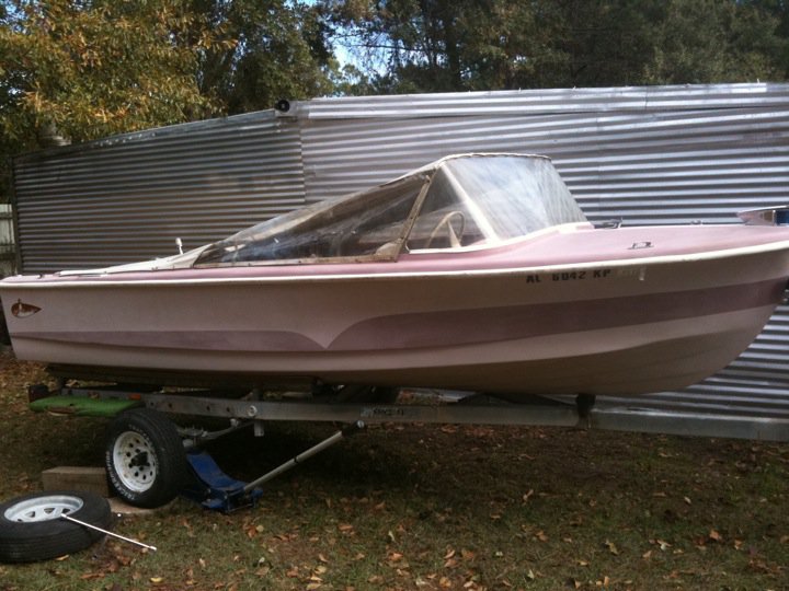

I recently purchased a 1961 Larson 16'. I have been trying to determine the recommend motor size for this boat. During the rebuild I and trying to keep most things traditional but with the engine I want to update with a 4 stroke outboard. I am thinking somewhere in the range of a 40 to 50hp.
Can anyone point me in the direction of hull specs and recommendations for this hull or has anyone repowered a similiar hull and have recommendations on size and hp.
Thanks
Randy

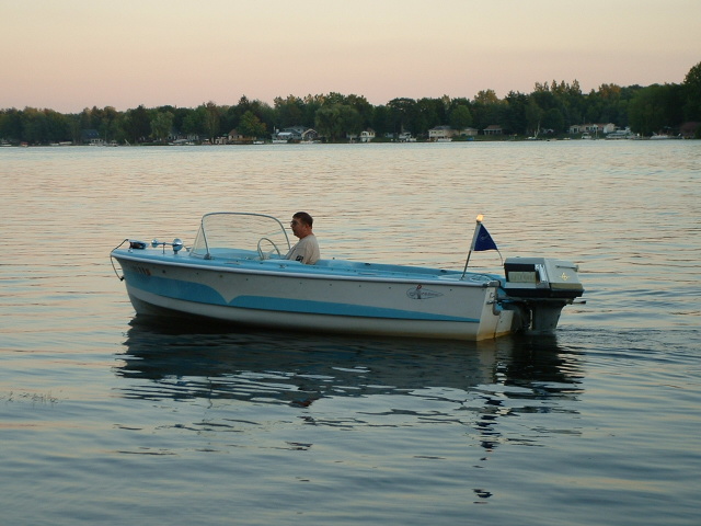

Is that the Larsom All-American? I have a 1960 All-American powered by a Evinrude Fat Fifty. I beleive they will handle up to a 75hp. Is it a 15" or 20" transom?
Power it with a 61 or 62 4 stroke Homelite 55hp.
I have some specs around here somewhere just can't find them.

I not sure about whether it is an All american or not. The guy I purchased the boat from did not know much about it. I actually discovered it was a 61 when I went to register it and they had it listed as a 61 instead of 68.
The hull is great shape and all the deck hardware is good but it requires new interior, motor and little details.
I have been reviewing the web trying to determine the different models and options for this boat but have not found much in the way basic specs and a major lack of interior pics.
Is there a way of determine the model type?
