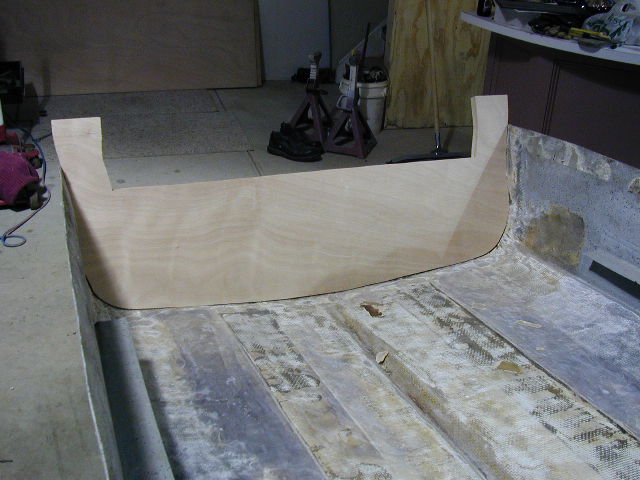

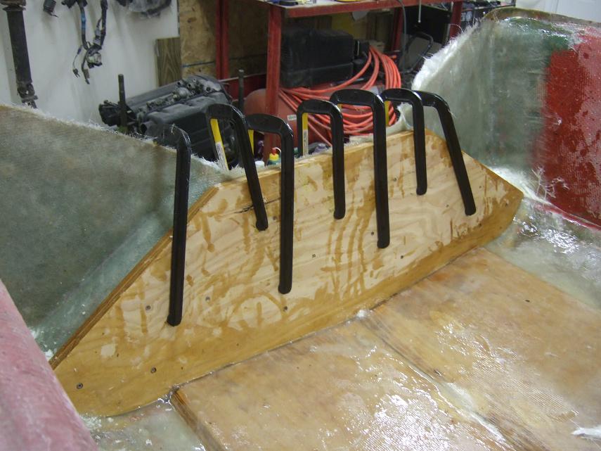

I made a second transom out of exterior grade plywood & clamped it to the outside of the hull. I figured this would give a smooth void free even surface when the cloth & resin dried. Harborfreight tools sells 12” deep metal clamps for $10.99 each. I used them on my boat. They worked really well!I also had cut the floor so the transom fit between the floor & hull that way it was tight to the bottom as well

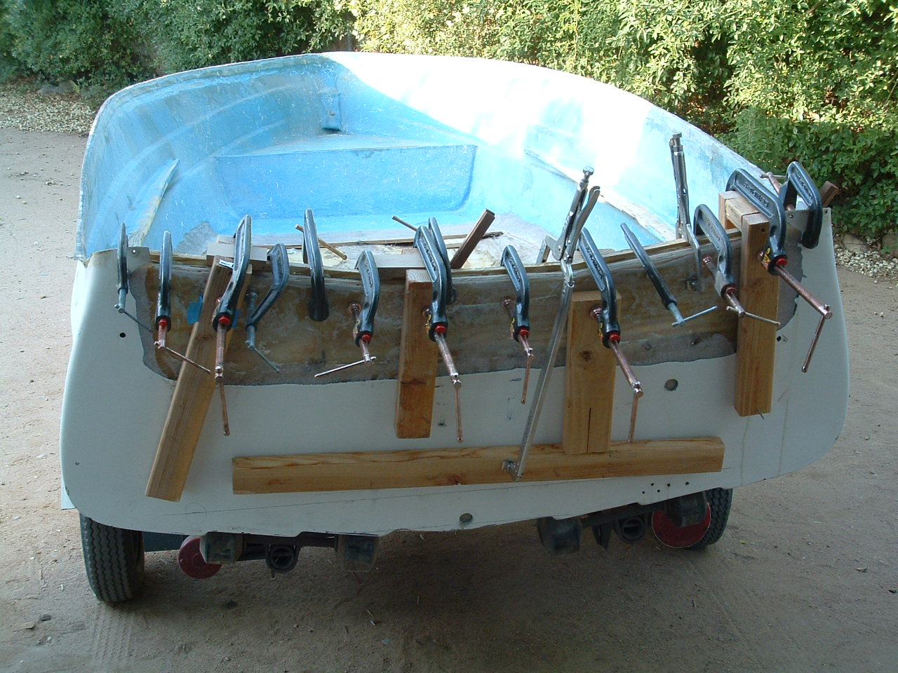

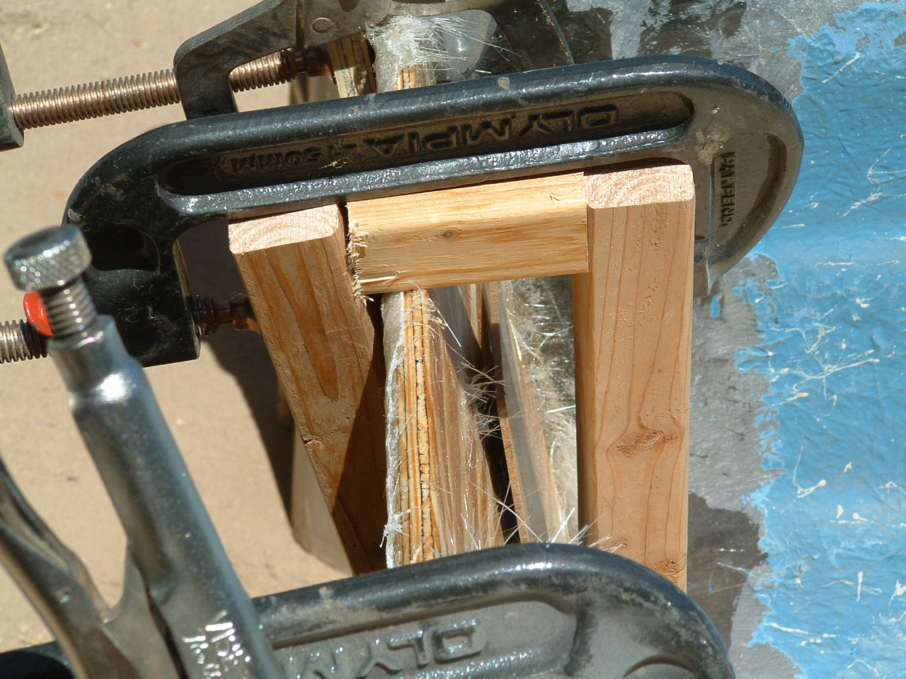

  • Karma: 22

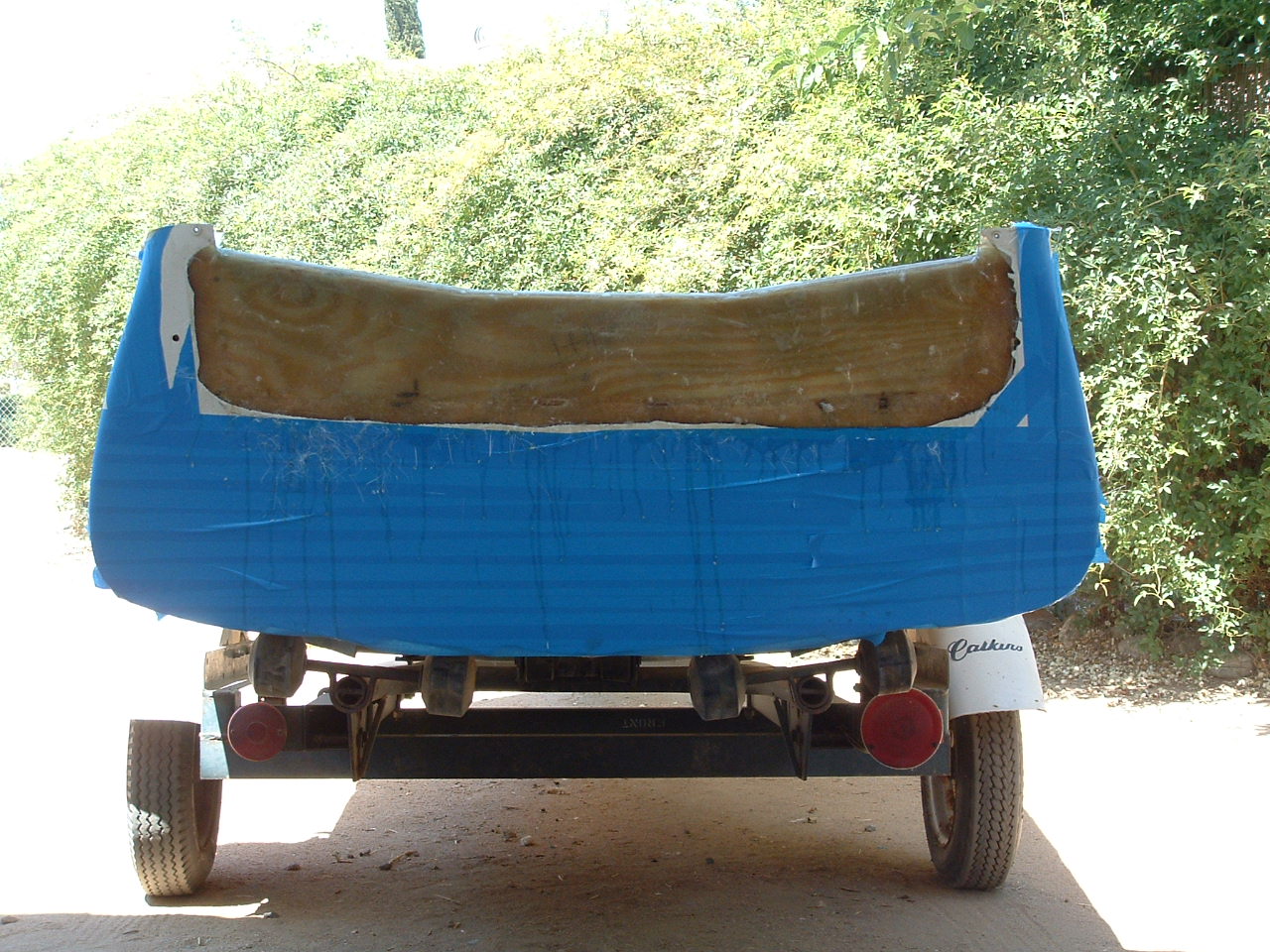

lets see if this will work, notice how I used 2x4 wood and c clamps to make the deep expention for the bottom, it was so strong then I had fire wood for winter,,,,,.......Mike PS i MADE IT INTO A LONG SHAFT TRANSOM TOOOOOOO....

Mike, have you figured out what you're gonna do for a splash pan or do you even need one? When I converted the Power Cat from a short to a long shaft transom I had to make a new splash pan. I put 2 horizontal cross braces across my transom and carefully rested a piece of 1/4" or 3/8" (I forget) in the remaining curve of the old cut-put splash pan, and then rested it on the top cross brace and glassed it all together. It seems to have worked great. I believe it will really give the transom a lot more strength.
Looks like you're doing great!
Frank

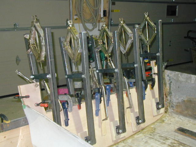

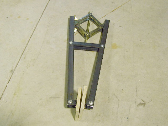

Re:Clamping a transom 16 years 8 months ago #2230
Here's some pics of the clamps that Bill ended up building. Very nice indeed!
Re:Clamping a transom 16 years 8 months ago #2231
I'll tell you what, "those clamps are killer."
Always thought scissor jacks were worthless.
They are perfect for this application
Nice work, and a great idea
lar
Re:Clamping a transom 16 years 8 months ago #2235
Just sat down to reply to this thread, and I see Doug beat me to it!! Thanks Doug ( I'm not being sarcastic)
The clamps worked very well. This is my first boat restoration, but looking in my back yard, it obviously won't be my last, so I thought it worthwhile to spend the time on some good clamps.
Added bonus, when I was done, I had a great piece of wall art!
