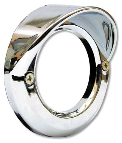

Hey, I just thought of something. If your bezel is pitted, go to a truck stop that has a chrome shop. You can buy chrome bezels for the taillights, etc that actually have an "eyebrow" over the top like the fender on a '55 chevy. They should have them to fit over your speedo, and they really look cool. I found this site that has them in different sizes. Not sure what diameter your speedo is...
secure.countywebsite.com/victorylane/index.php?cPath=61_103&osCsid=2e68e426422e69f470570d12bc815462

Holy Smokes that's cheap!!!
Re:Anybody have info on testing Speedo? 16 years 8 months ago #2064
Doug, that chrome Bezel is kool........
