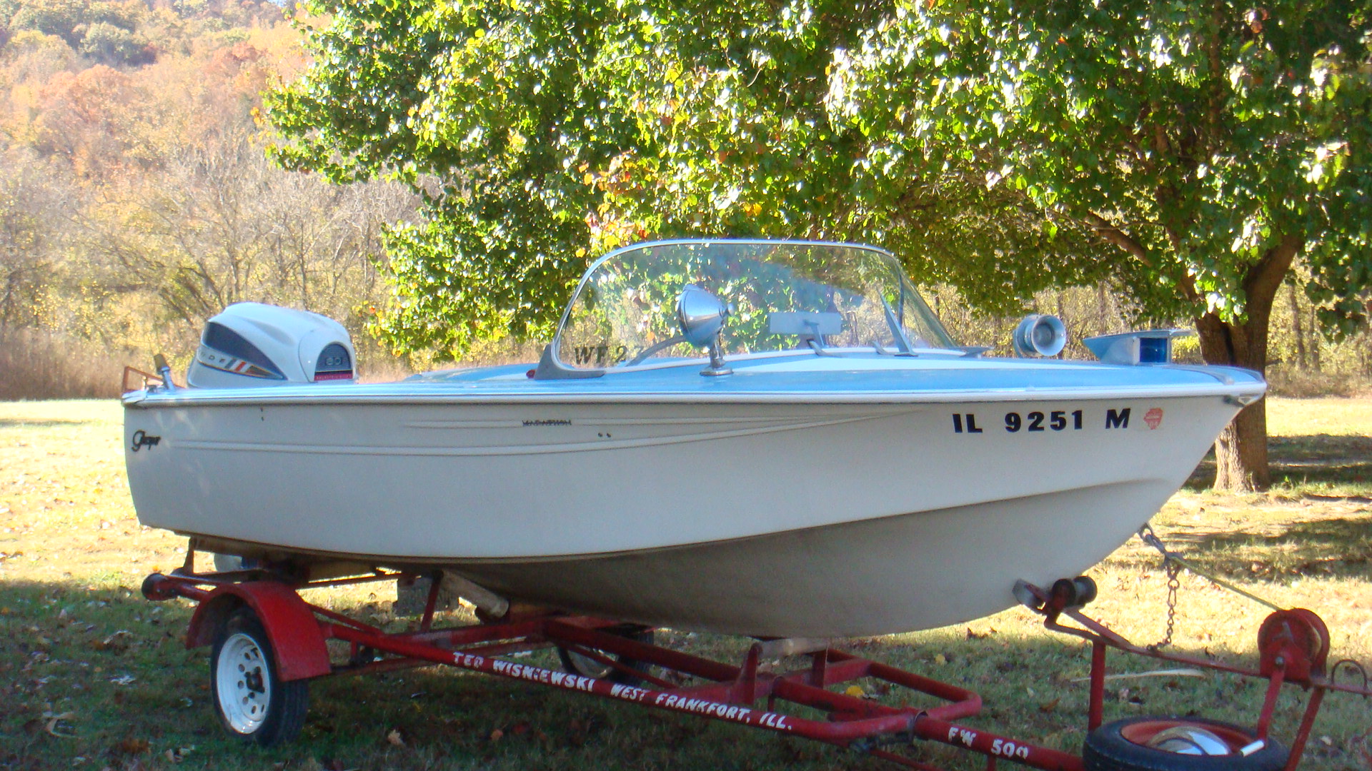

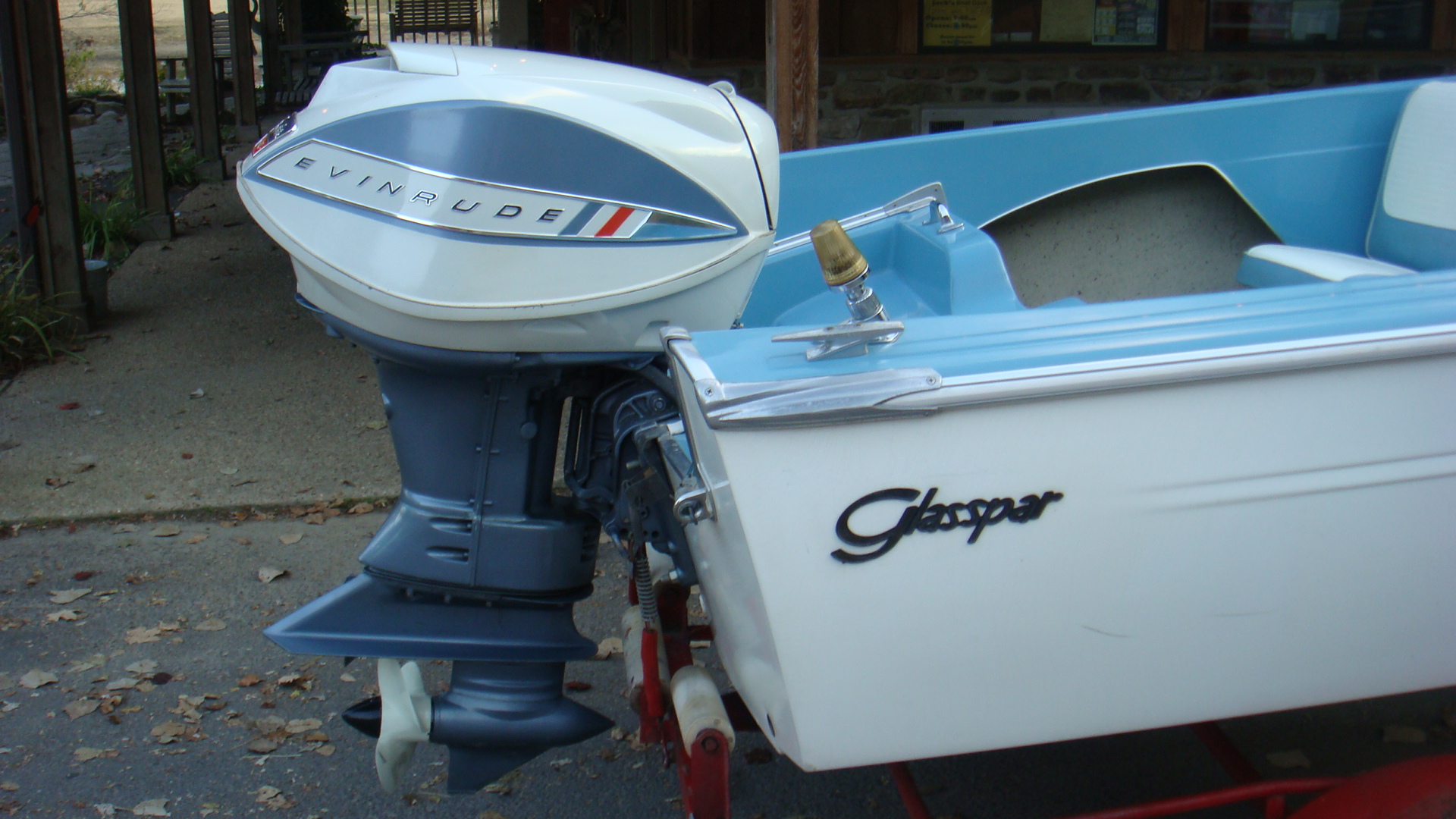

Very nice looking Glaspar and Starflite, AO! The JEGO (Johnson, Evinrude, Gale, OMC) forum would probably be more appropriate for the install instructions. (Thanks for sharing them with everyone, BTW.)

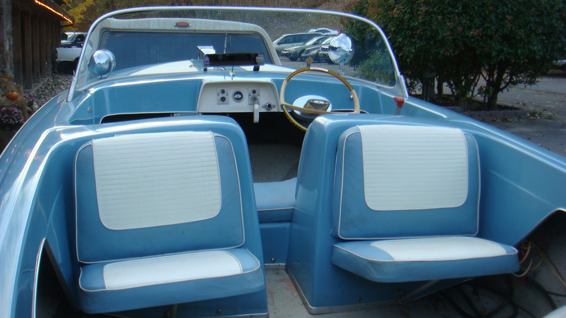

I love how the dash layout is. Are you going to change the radio to a AM/FM CD player or AM/FM 8 track of that era?
Re: Tachometer for 1966 Evinrude 80 hp starflite VIII 15 years 9 months ago #19769
Neither. That's going to stay. Just need a tach so i can get the right prop on her.

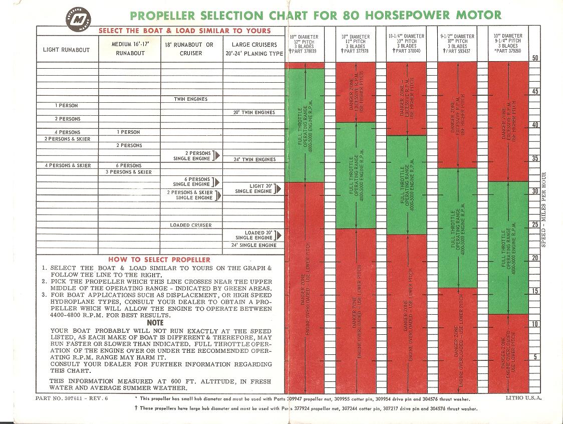

I get alot of comments on the radio so i'll have to bring something portable. Or find a good ol Am oldies station. But now I found a chart in my paper work that came with the boat. Might not even need a tach.

Still may not mount it. I hate to change anything on it. Just like those rooster tails, I'd love to have them but hate to put holes in the boat. I'm going to take the original prop off and replace it with the 10 11 prop. It seems like it will do me better and besides I don't see the white ones anymore. They are all black.

Your propeller selection for that engine is so limited that there isn't really a need to put a tach on it. I would run a 10X11 or 10X12. The 10X10 would work fine for pulling heavy skiers, tubes, etc.

Did you restore that Glasspar or is that original ???
Re:Tachometer for 1966 Evinrude 80 hp starflite VIII 15 years 9 months ago #19922
Think thats what I am going to do. I bought a 10 X 12 I think that will do me just fine. It has a 10.25 X 10 on it. And yes it is all original. I have the reciept where he traded the 35 Lark in for the 80 Starflite in April of 66. The gel coat has cracks in it but it cleans up well. It does have points. I found a place online that is selling out a old OMC shop so I am buying up a bunch of spare parts for it. He is selling from a 1998 price book and knocking 15 percent off of that.
