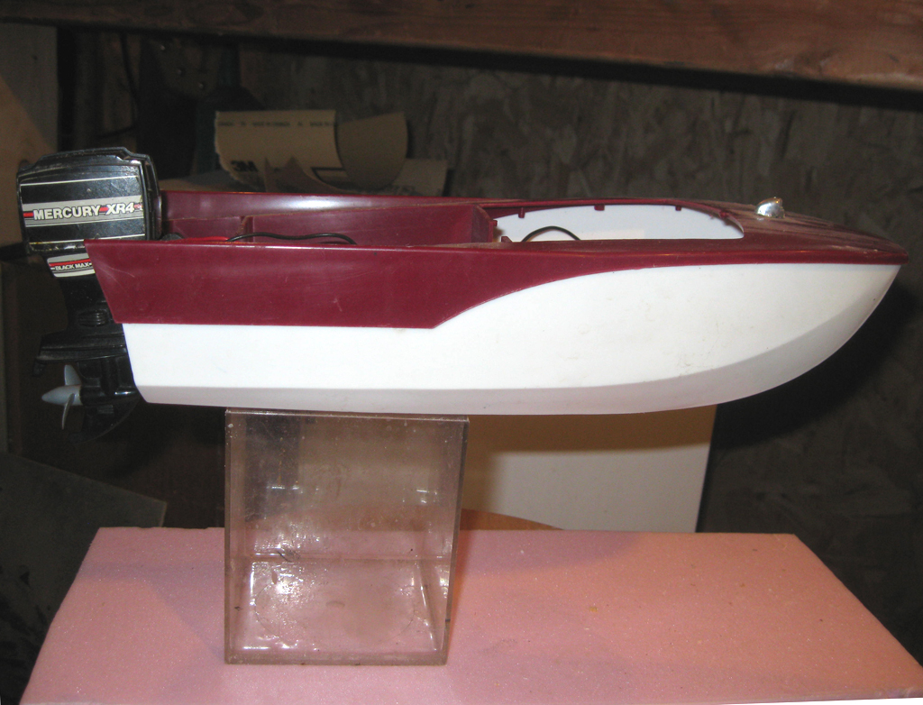

Looking for a unique micro R/C rig, I decided to use this hull, which I bought over 10 years ago off eBay. It is an old Fleet Line hull (not sure what it was called) that originally came with a pair of plastic Johnson 40hp motors. It originally came with a cabin portion, which mine was missing. It is about 11-3/4 inches long.
The motor is a 1990s era Mercury, made by Nylint toys. They are cheaply made and very common on eBay. The two main issues with these motors are the cheap electric motor and the poor meshing of the gears. I have a brand new one of them that still doesn't engage the gears properly! I split the casing and made a nylon bushing for the propshaft to shim the gears closer together for better engagement. I then went about upgrading the copper brushes to carbon brushes to allow the motor to take more juice. It was originally designed to run on about 3V, but mine should take up to 7.5. This, I hope, will be enough to plane off the boat. I will be using a Lithium Polymer (LiPo) 7.4V battery to start, and if it works well with that, I'll add a micro servo and receiver to make it remotely controllable.
I'm not up on my Power Cat, or cats in general, but I thought this one looked pretty sharp.... I just hope it goes!! The 6V AA pack I ran it on in the tub did alright, but not quite planing speed. The LiPo battery is about the size of a matchbook and weighs about the same, which will take several ounces out of the boat.

I got a few bugs ironed out of the motor (burned up an electric motor and broke two motor to driveshaft couplings) and now she runs great! Scoots right along when I'm not pulling it around to keep it from banging into stuff!
Next step is to add R/C gear - a servo, receiver and speed control. Will keep you posted!
Would this one be referred to as a Power Cat .91C? :P :laugh: (Okay, to those who didn't get it, Power Cats have the length, in feet in the model number - mine is 11-inches, or .91 feet, give or take)
