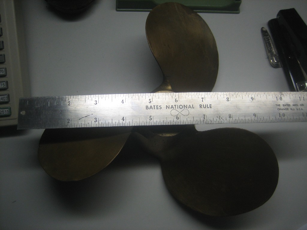

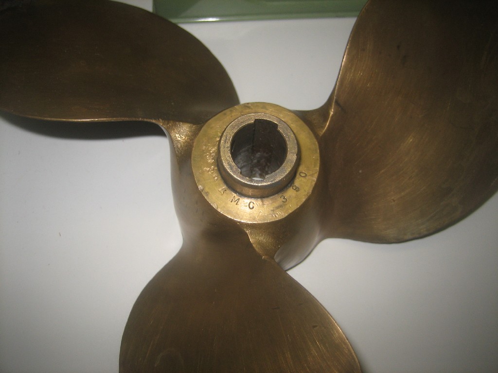

Thanks guys. Here are a couple of images of the prop. Per BillR, he states that the diameter of this prop is only 8. This prop came with a '63 EV Big Twin 40hp. Standard diameters for the big twins are usually 10 3/8. I measured this one and it's right at 10 3/8 diameter. The stamped numbers are clearly AMC 390. Interesting.

Here's the second image of the AMC 390 prop.

Re:Reference to Michigan Brass Props 16 years 1 week ago #18470
I found on a search of the AOMCI forum a post that lists this as a 10 3/8 x 13 1/2 prop:
