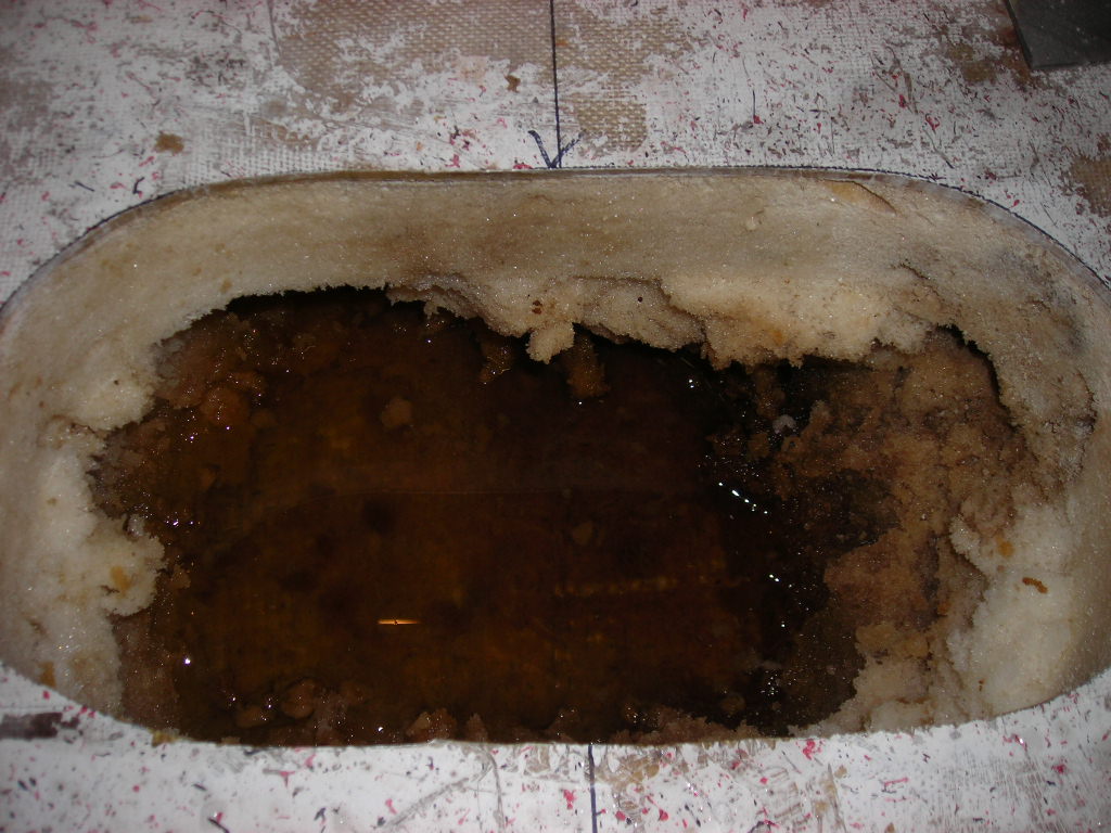

i cut into the seat bases of my 1959 cutter jet de ville and i found solid foam soaked with water and full of ants,i had to vacume out the ant nest.
im still working at getting it out and so far i have about 100 lbs of wet foam in 3 garbage bags with alot more to come,after the foam is out ill have to brace them.

When yer dun John, air it out good, make sure it's dry, and DON'T PUT FOAM BACK IN!!!

yep thats the plan,lol,ill brace the seats with marine plywood,and im going to drill a small hole so that any water that gets in,can get out and down the drain holes

Oh man, I feel your pain.. really itchy digging past that fiberglass cut. We've been digging wet foam out of our 72 Aristocraft for a while. Now that she's got a good roof over her head she'll be able to fully dry out.

mom of dog,im pretty lucky with this boat the seat bases are fully enclosed,the water didnt get under the floor,im going to leave the cutout there and make a hatch and make it storage,but drill a small hole for drainage.
im not going to put foam back in it seems just about any foam will (over time)soak up some water,and that doesnt bother me as much as it freezing and thawing,here in pa.
the transom is as hard as a rock,i found some small stress cracks,so i cut the top of the transom open and found out it was due to the inside of the splaswell not touching the plywood,and when the motor was cranked down tight it caused it to crack,im going to fill that void before repalcing the top of the transom .john
