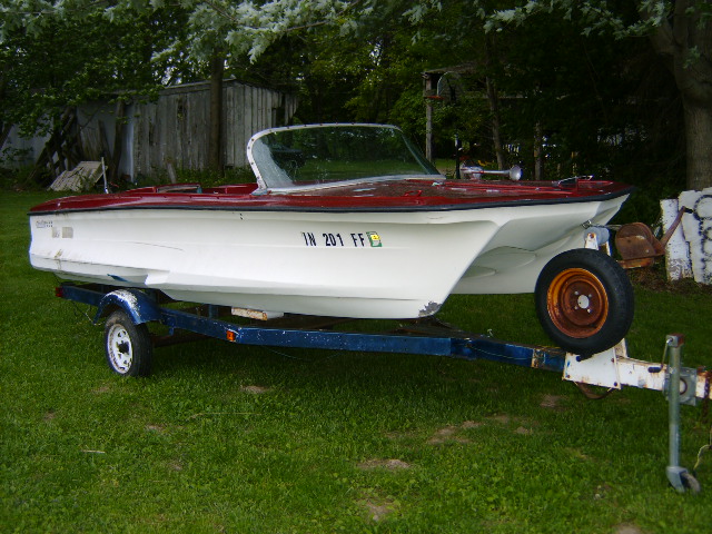

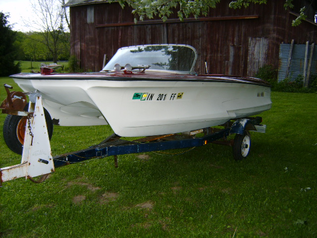

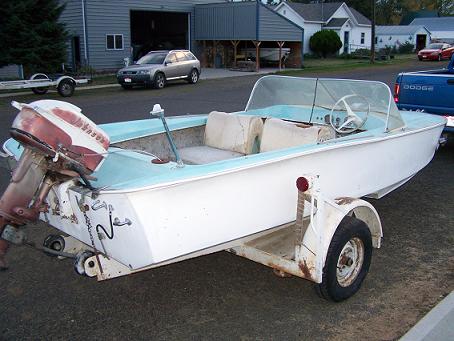

Got back from delivering the Del Mar and went right over to get the Hydrocraft. Our original deal was for the boat, trailer and two 35 horse Johnsons, for 400 bucks. When i got there the guy said he wanted to trade for another boat that I had, a 1975 Reinell 15 foot tri-hull with a 650 Merc with a bad powerhead. Ah shucks, alright!

Cool, so you got rid of 2 boats and got another one all at the same time and saved money in the process, Sweet. Now you have restoration money, lol....
The boat sure looks fast and in good shape. Im excited about seeing this in the water, Mike

N: CONGRATS, very nice style . trailer looks nifty with lights & rear rollers.? Not sure of hull length or able to support weight of 6 cyl ..? I had a 115 hp 1987 & started to raise up the transom on a Custom Craft , but long shaft Merc are real heavy over 70 hp stuff.
. Definately I would pick a power tilt & trim engine & those OMC 3 cyl STINGER 75 hp are on the collectible list. . Merc 850 XS also a hard puppy to FIND.

Great lines! Gonna need a glassy surface to enjoy that hull! What year is it?
And yeah, a merc tower is the route to go!

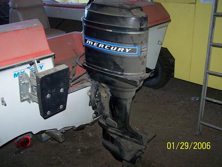

This is a motor that I was considering
It is attached to a 17 foot tri hul sitting on a trailer for $500.
I may be able to get it for a little less.
115 with no tilt.

I found a 64 Merc 1000 short shaft in the Portland area.
My daughter lives there so maybe a visit is in order.
The guy said compression of 75 to 90 on all six holes. He is asking $250. This may be the base engine to rebuild.
I really would like to have a Merc tower if I can find the right one for the hull.

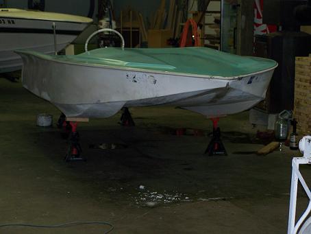

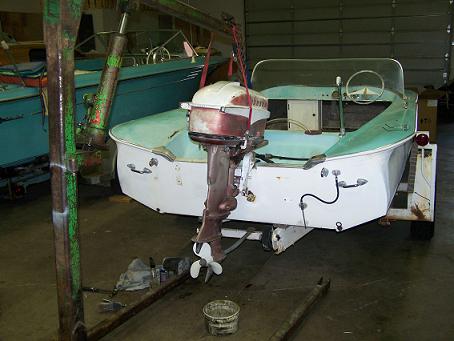

Gentleman
Thanks to all of you for your input on this project. You guys have offered a wealth of valuable info and I truly appreciate it.
I got a little more done this weekend.
Heck, even the trailer looks fast!!!!!!!!!
Neil
