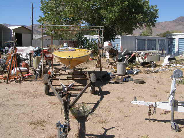

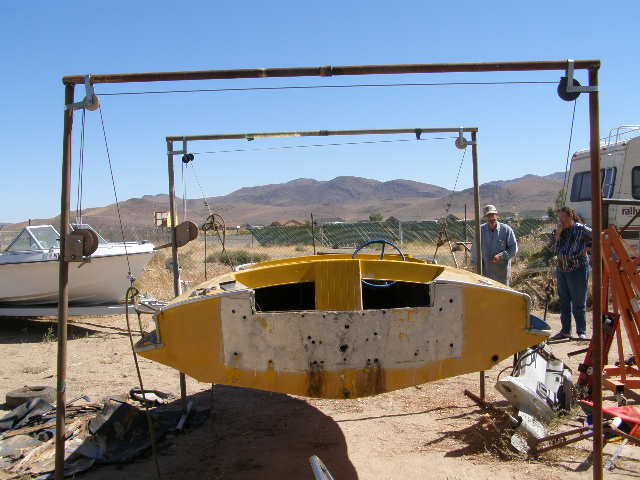

I have had this idea running around my head for a while. So got togather with my buddy and this is what we came up with. The frame is 2" pipe 2 wenchs and some pullys and used streering cable. Its portable and will fit any size boat. This one is welded but can be made with just pipe fiting.
Heres some pix.

PS
for a good boat you might want to use some straps under it.

My main reason for making this is so I can get the trailer out from under it to work on it. Plus with this I don't have to get 4 guys to help me and pay them a case of beer.
