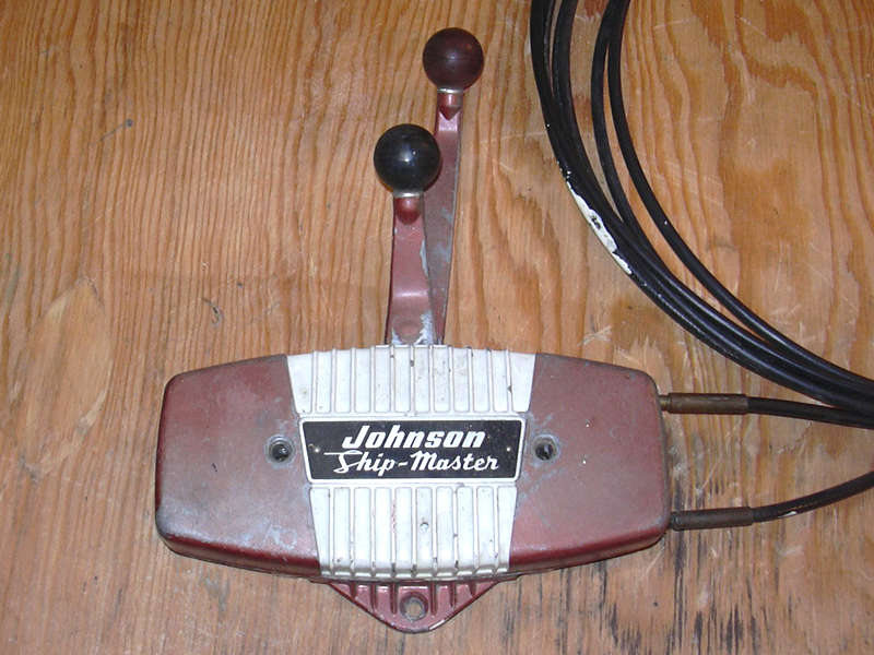

As for a control box...any of the twin lever OMC boxes will work. Think mine came from a mid\late 60's Evinrude. Looks similar to this one:

Also, the control box it has is similar, just missing a badge on it.. sounds like a winner.

To be period correct, the control box should be a Johnson Ship-Master of the Football shaped variety. The rectangular style shown above is for later models, c. early 1960s & up. They would look like these, only in white.
