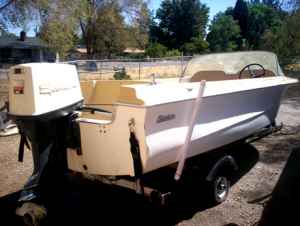

Well I just sold a boat, so I was looking through craigslist and saw this for 100.00 ending up getting it for free. it is a fiberform i think 16' and has a 1970 johnson 60hp outboard

I don't know anything that will help identify that boat but you sure do come up with some great deals. Keep up the good work.

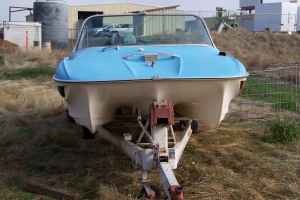

Also, I have this image of a Fiberform boat, year unknown, that I believe was posted awhile back on one of the old forums. Looks to be similar to your boat:

Looks like the same boat Andy. Good job, Mike

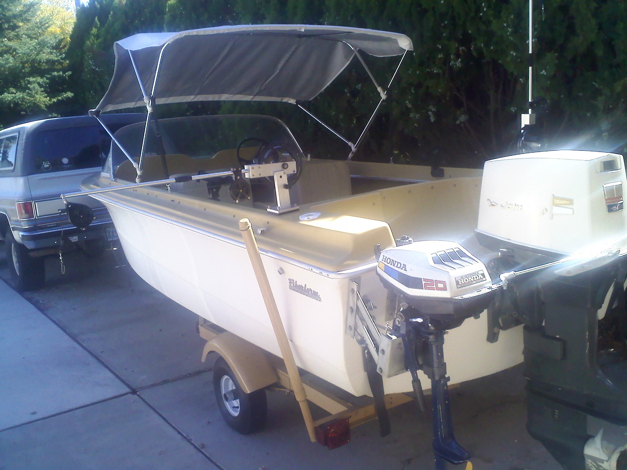

Well the fiberform is coming along, I cleaned up all the gel coat, it is looking really nice. Repainted the trailer and put new lights on it. Then it was time to get down to buisness on the motor. I didn't have a key so I searched around on e-bay and found one.The guy i got the boat from said it just stayed in forward gear and wouldn't even shift into neutral, or reverse. Well I drained the unit and the fluid was thick and black . Then i filled her up with type c lower unit fluid. Then I started to look at all the carb linkage and it was all messed up. So bad that the neutral safety was not even letting the starter turn over. Well i adjusted everything and bingo she fired up .A little tweaking on the low speed mix and it is running great AND IT SHIFTS..

Looking much better John, and isn't it amazing what a little TLC (and the right gear lube) will do!!

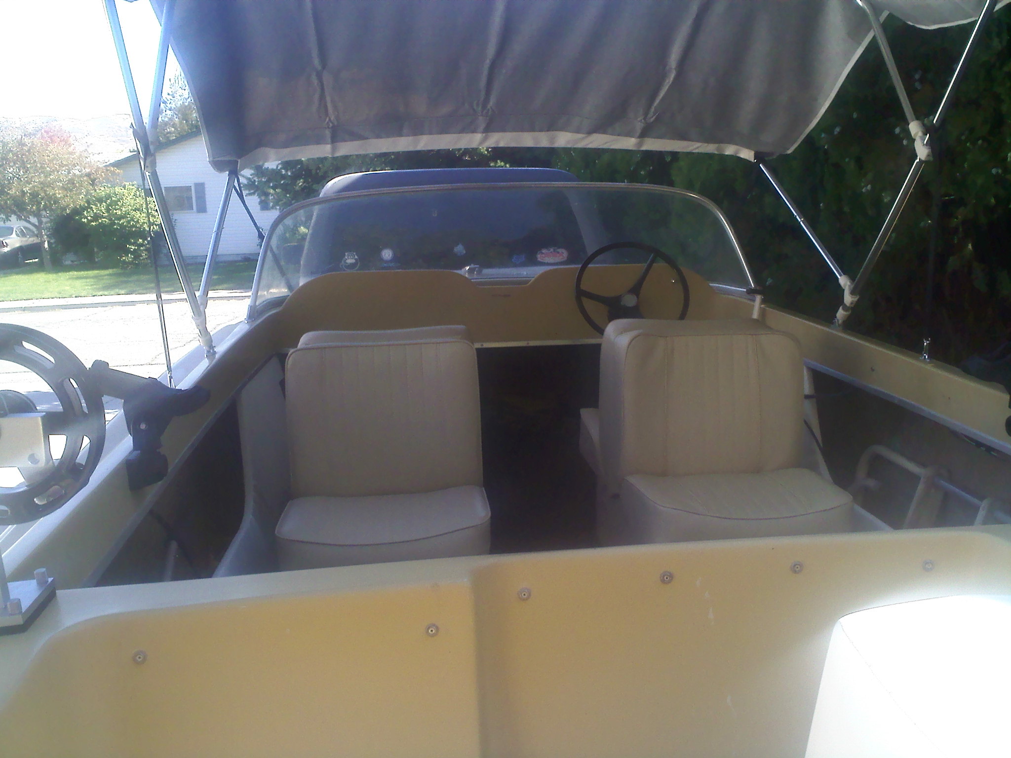

well it didn't take to long and i am at a grand total of 945.00 i have brand new seats, top, downriggers , a used 2hp four stroke honda for trolling , and an eagle color fishfinder , it has been a lot of work but it was a really rewarding project. I want something that was a classic but I could still use it as a fishing machine , and that is just what I have .

Lookin' good johnnycatt.
Glad to see you put some life back into it.
