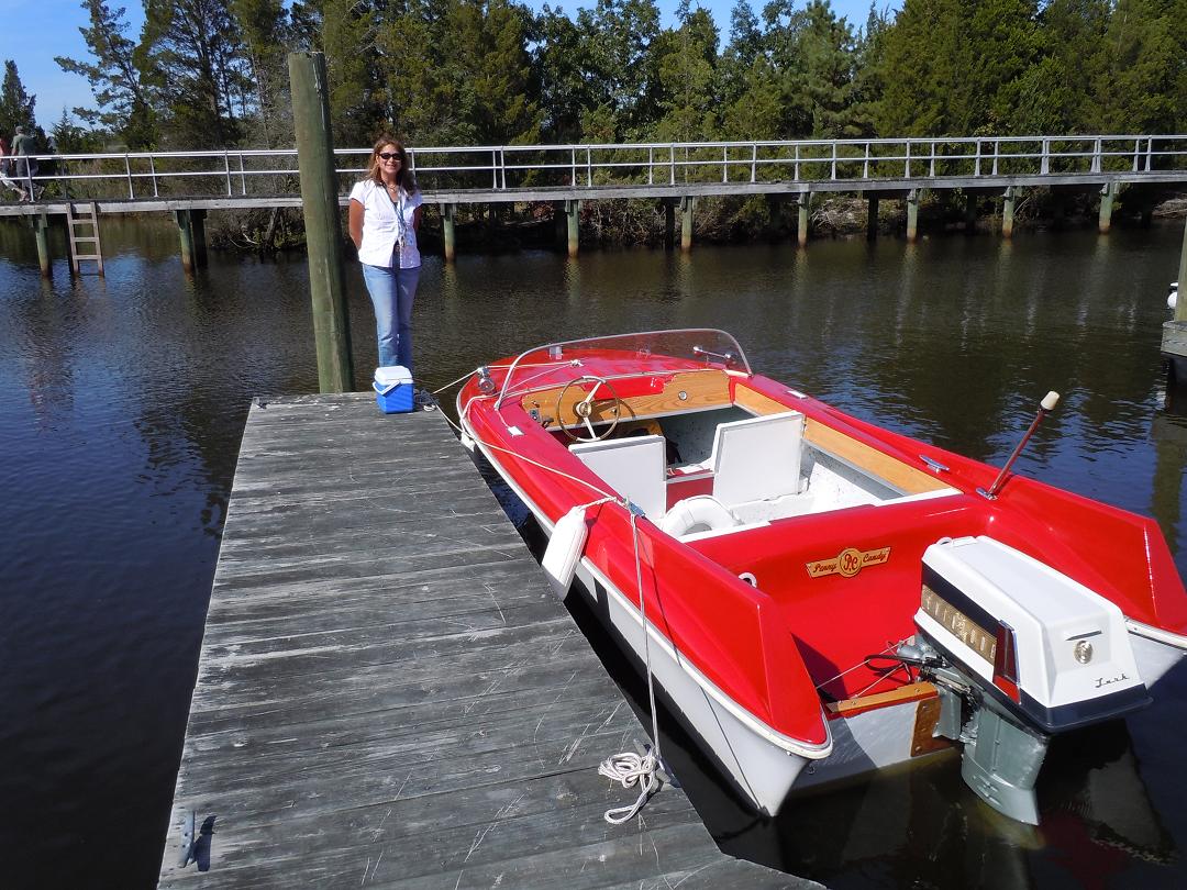

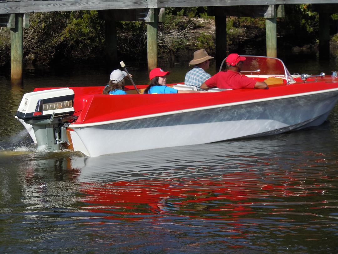

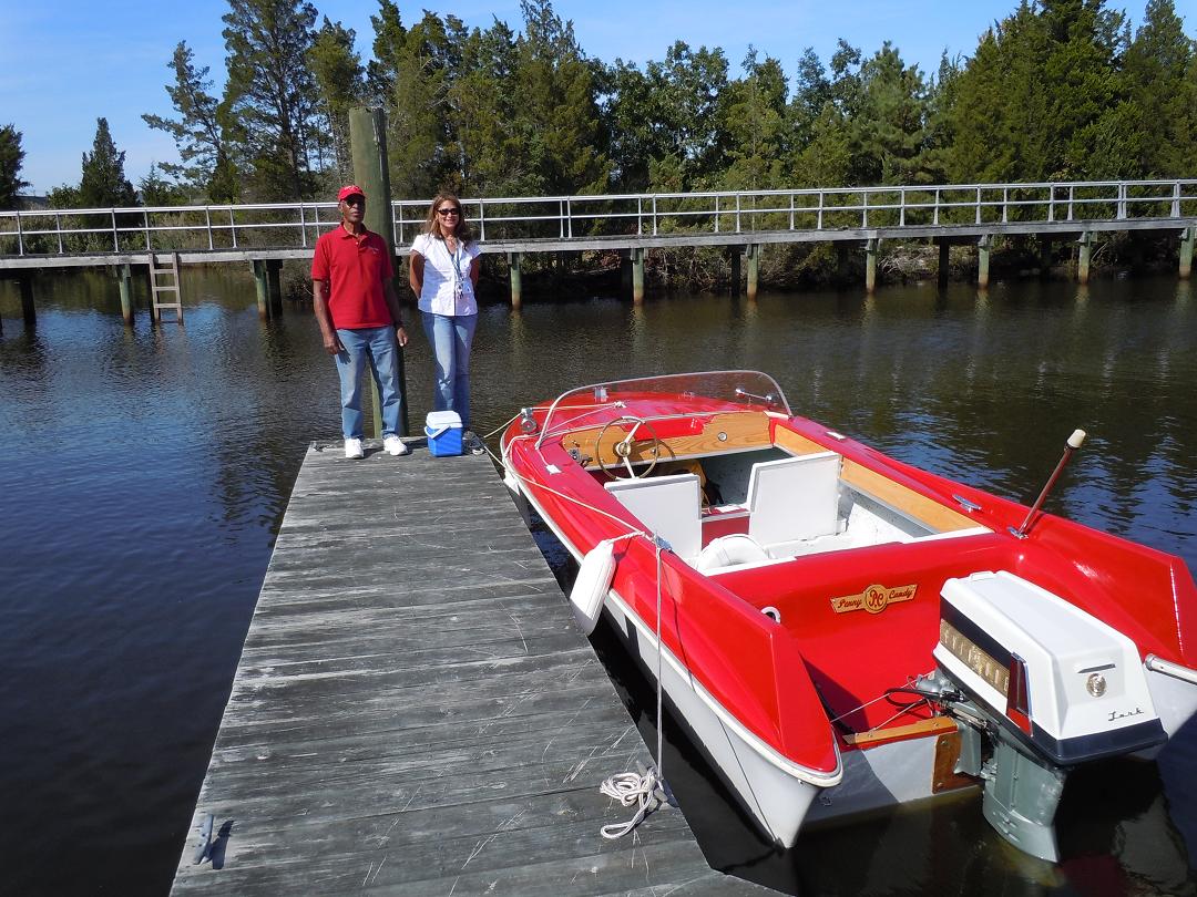

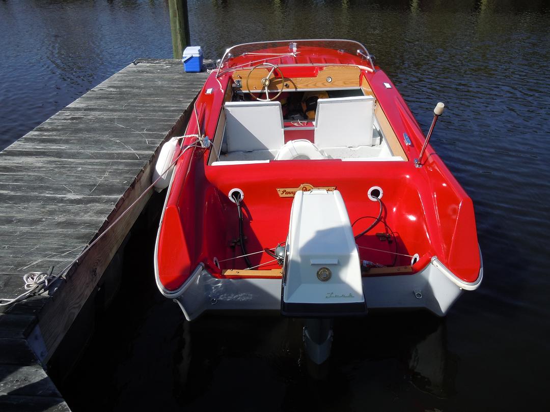

Tuckerton Seaport..... i can't tell you how good this boat looked in the water. first time since 1972. last pic is of her husband, dad,and 2 daughters leaving the dock.

Beautiful boat. Well done.

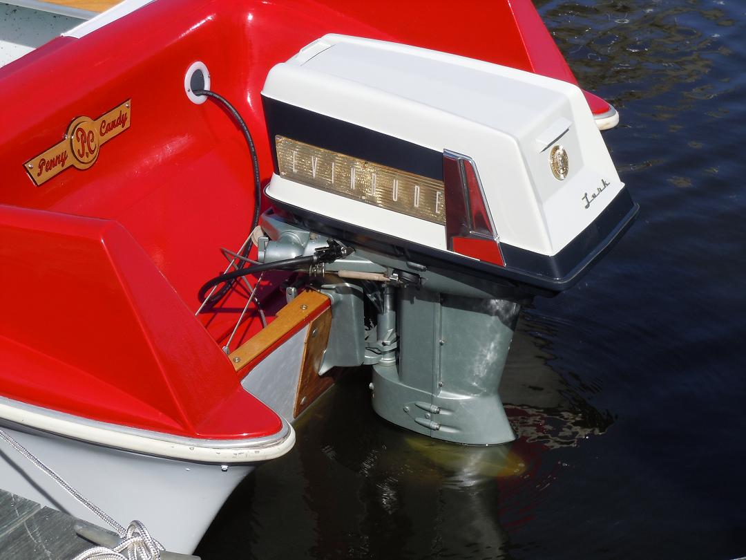

Beautiful. Was the Golden Jubilee Lark w.o.t? Sounded like she had a little more left. I have a twin that's going on my 59 Dorsett Monterey. Inspires me to run it on the boat and not in the tank! Thanks for the video. The smile on you daughters' face tells the whole story of why we do this silly stuff! Well done, Mike

Thanks! The shaft is too short for higher speeds. I'm not a speed demon, so I may or may not spend the extra money on an extension.

Sure looks like the correct shaft length from the pictures. If the cav plate is level with the bottom of the keel at the center then you have the right shaft length. Run a straight edge from the keel out to the cav plate and you will know for sure. In any case, great motor and boat. Mike

Looks great. Is that bright red susceptible to fading?

Nah, she's safely under a garage when not in water, and my dad swears waxing will keep it from fading. I guess I should've waxed my red van. It's totally faded.

Yup, Jet De ville is her little sister. I love the really deep halls of these boats. It makes me feel secure. Oh and I meant to tell that other poster that since the hull is so deep the shafts of the motor just clears it.
There are some wood supports under the bow, along the sides where you'd step and need to secure steering cables, and yes in the transom.
