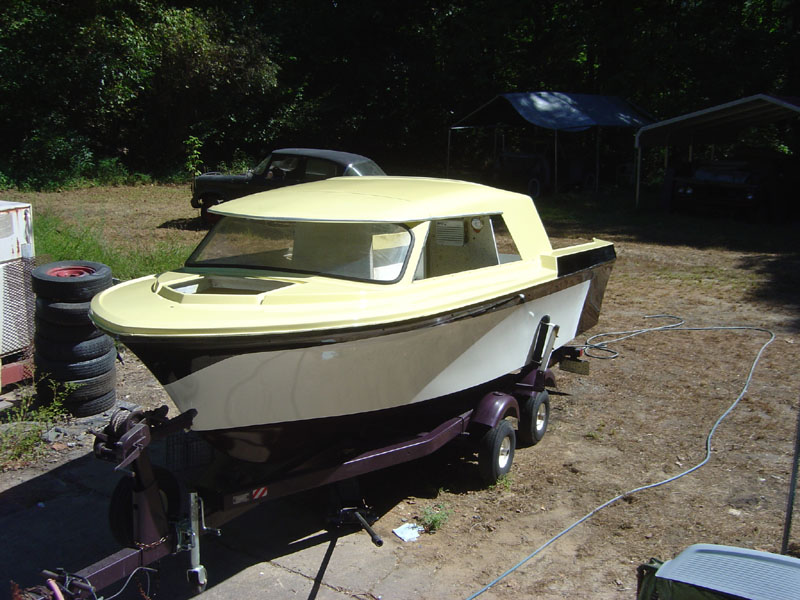

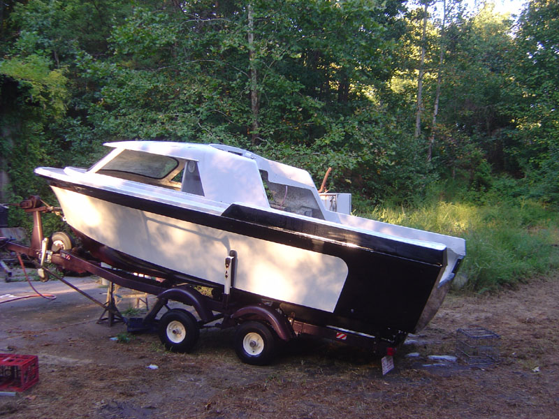

I took this morning to paint the '69 Fabuglas Commodore Cruiser.
We worked on her this weekend.. and it's supposed to rain tommorrow... so today was the day.

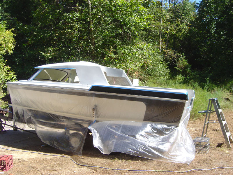

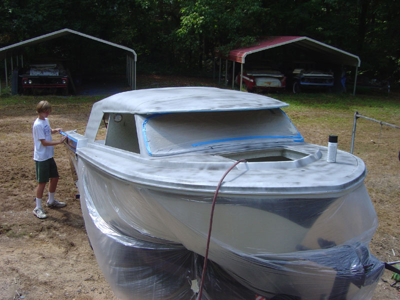

After the bodywork was complete- my son and I shot 3-wet coats of high-build primer on Saturday. The we guidecoated it.
This was then dry-blocked with 320g sandpaper. Then we watersanded it with 400g.
This morning I taped it off,

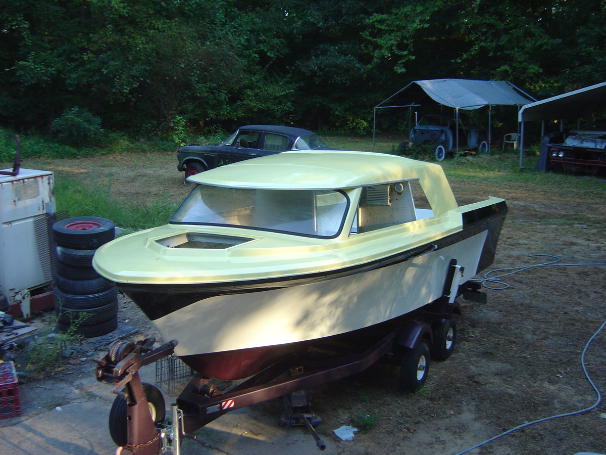

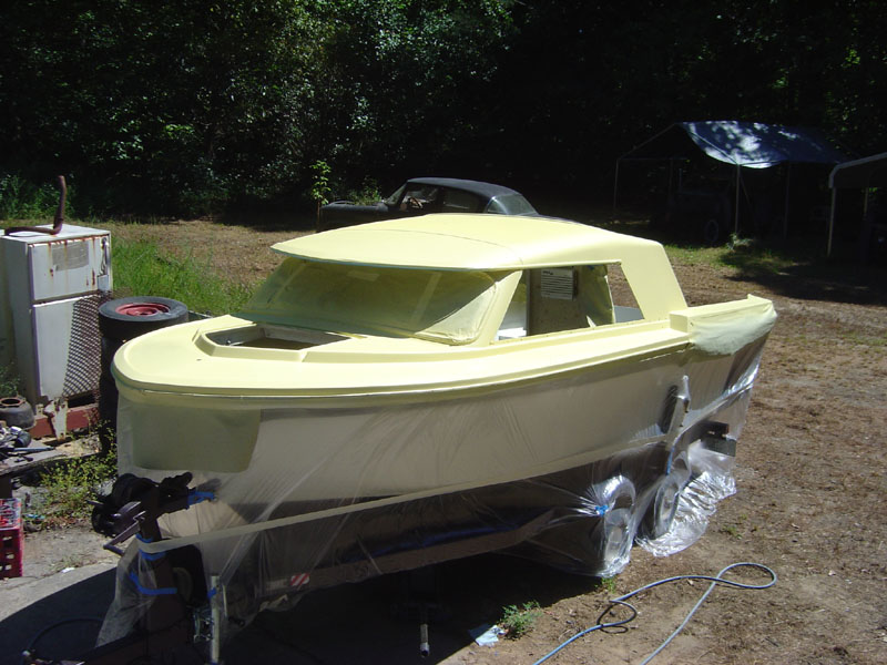

I wiped it down with wax and grease remover, tacked it off with a tack-cloth, and began the 3 wet coats of color. I already had some extra yellow basecoat (Dupont) from a 1951 Chevy Convertible.. but it was a bit too pale. So, I took it to the paint store and had a bit more intense yellow added.
Then It was another 3 wet-coats of Dupont Urethane Snap-Dry Clear. I like to "untape" after about 45 minutes of dry-time. You generally don't pull up the edges this soon. If you wait overnight- often you need a razorblade in some areas to get the tape off without lifting.

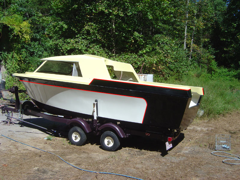

I added the pinstripes with photoshop..
I hope to spend the rest of the week assembling the rub-rail, gauge panel, radio, and Motor... Who knows.. I may be in the water this weekend...
I'll add this photo. It's later in the evening and shows the true color much better.
Re:Fabuglas is Painted! 16 years 1 month ago #15265
very sharp...i luv it. ron
Re:Fabuglas is Painted! 16 years 1 month ago #15278
  • mgbbob
  • mgbbob's Avatar
  • Posts: 47
  • Karma: 1
Great looking job.
Re:Fabuglas is Painted! 16 years 1 month ago #15285
Outstanding, the pin stripes will really set it off, very nice.
Re:Fabuglas is Painted! 16 years 1 month ago #15296
  • Neil
  • Neil's Avatar
  • Posts: 1997
  • Karma: 65
Very nice. Getting closer to floating again.
Neil and Mary Ousnamer
Re:Fabuglas is Painted! 16 years 1 month ago #15302
Am I missin sumpin here? I don't see any pics!
Frank
Re:Fabuglas is Painted! 16 years 1 month ago #15314
looking great ,cool paint job,nice work, and kudos to your son for his work too.
Re:Fabuglas is Painted! 16 years 1 month ago #15354
  • DelRay
  • DelRay's Avatar
  • Posts: 272
  • Karma: 10
Thats gonna be "one fine ride" for sure! Keep up the great work.
