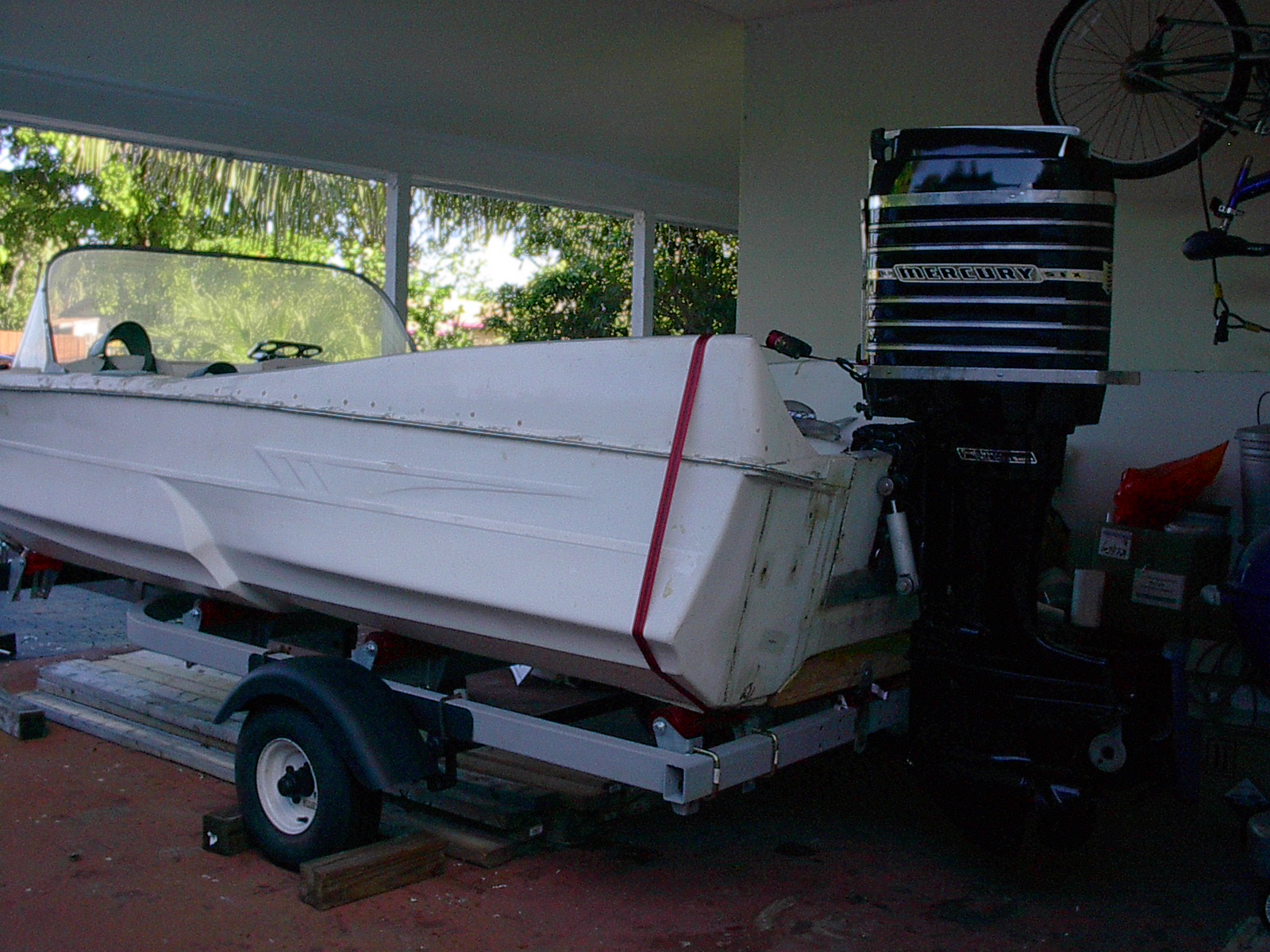

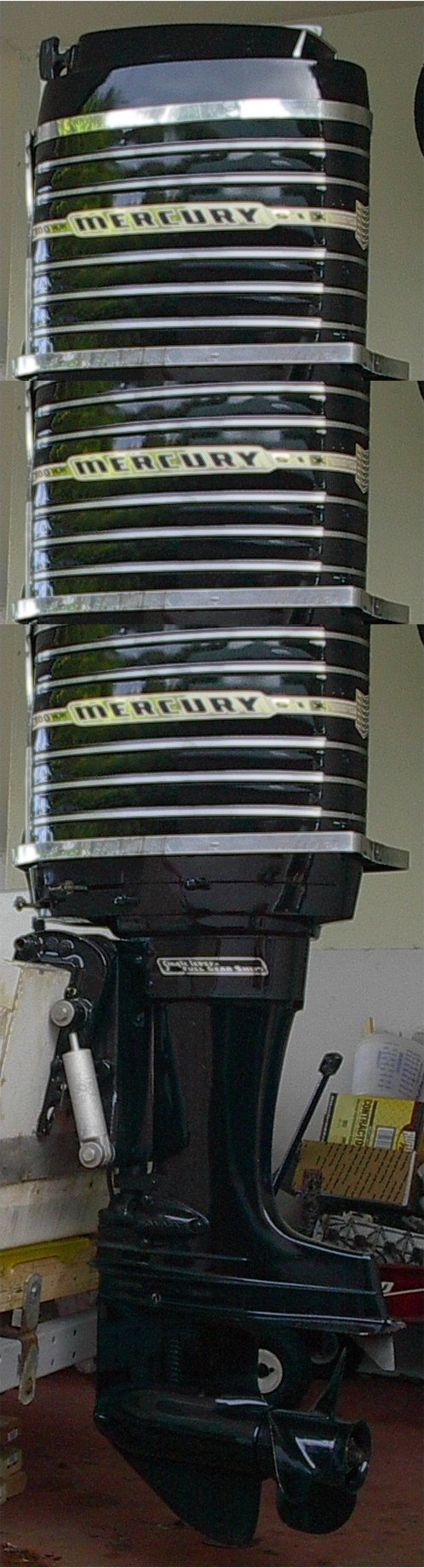

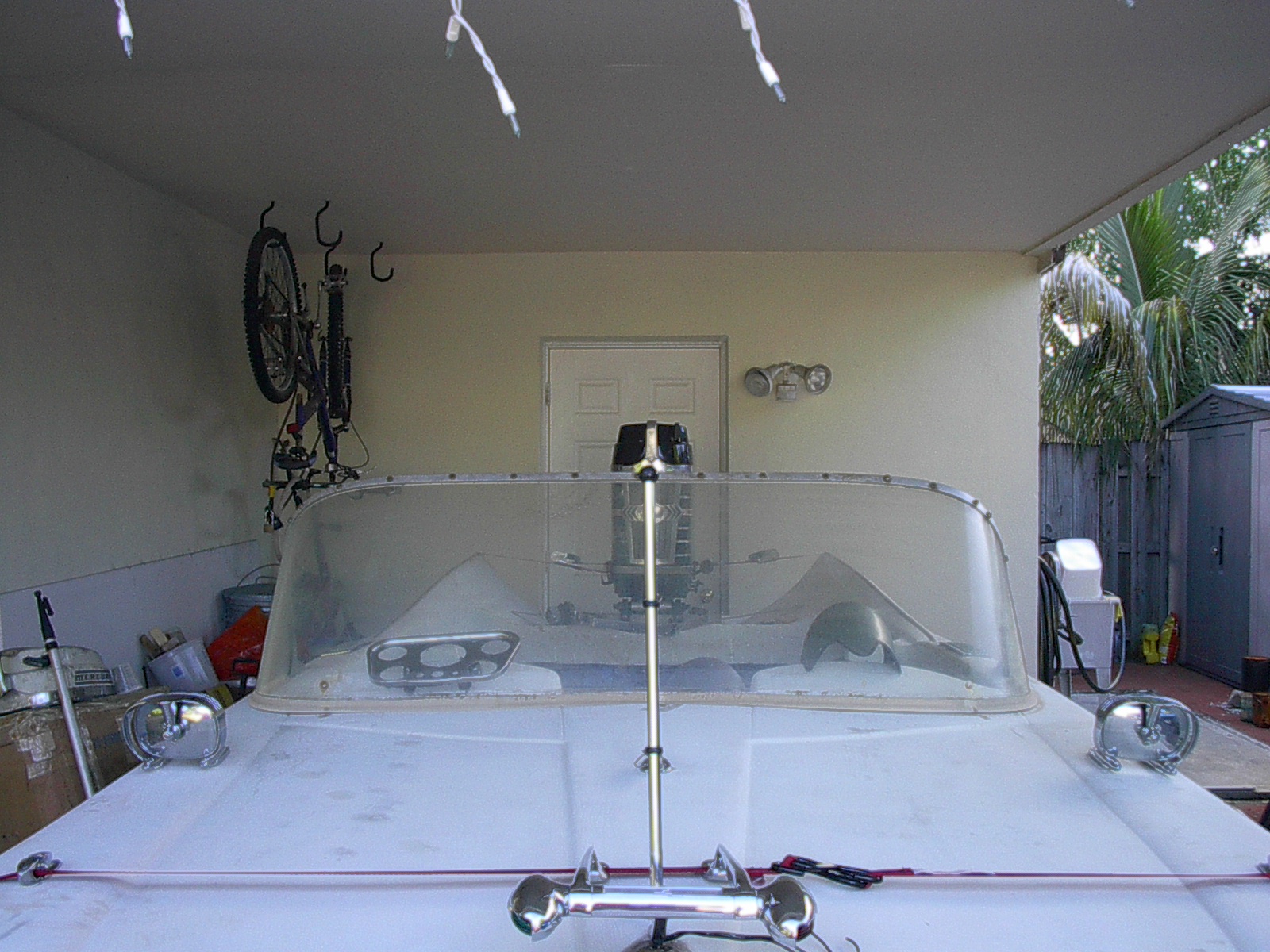

Thought I was gonna need a lift kit for my cherry picker installing the Merc 1K. When you stand next to one of these it's clear how they got tagged "Tower Of Power"
Most important number one thing with any engine...the motor must be taller than the top of the windshield.
In the ball park at the othe end

"taller than the windshield" lolol.. mine is too.

I'd need a straight 18 cylinder to be taller than the flybridge on the Fabuglas... (anyone got (2) extra Merc 1400's and a good aluminum welder? :ohmy: )

69 Fabuglas, Adapter plates and timing, "TV" Tommy Ivo inspired Merc Max 18 cyl. for ya ;)

Be careful when trimming that "Tommy Ivo" (I do remember him and his crazy creations!) Merc, the upper cowl could hit you in the back of the head! LOL Seriously CF, the Merc looks perfect on the 'Ray IMO.

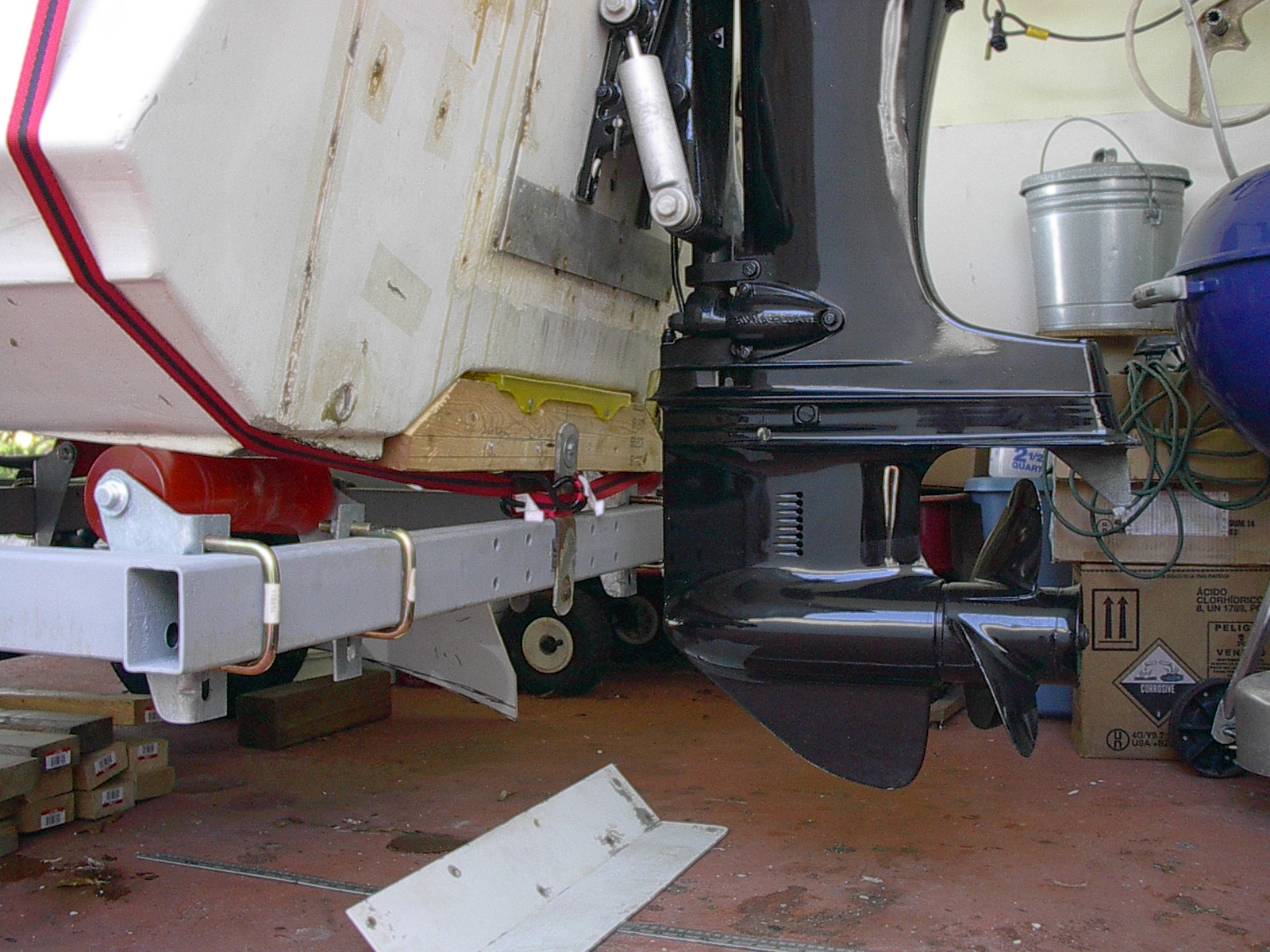

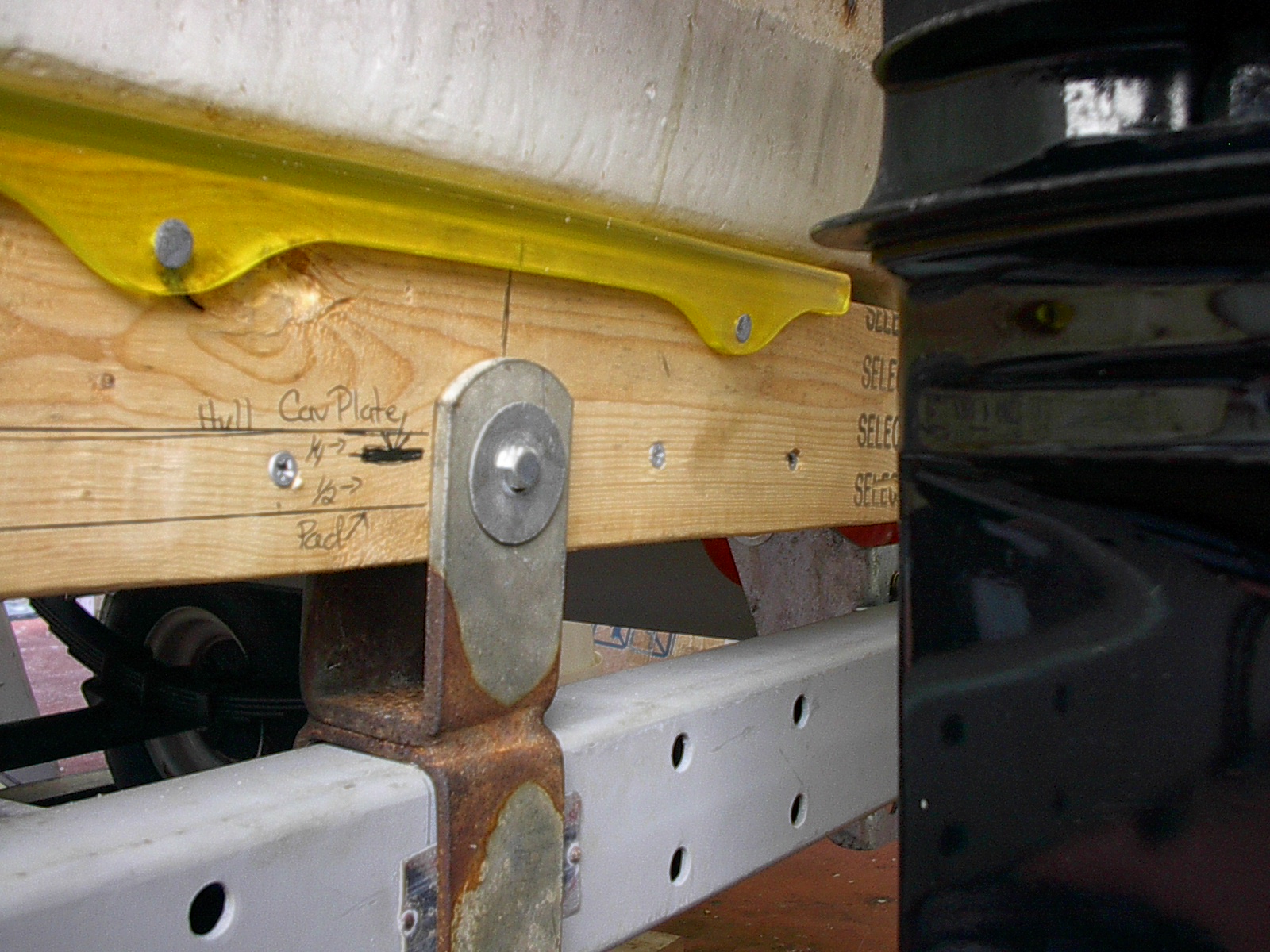

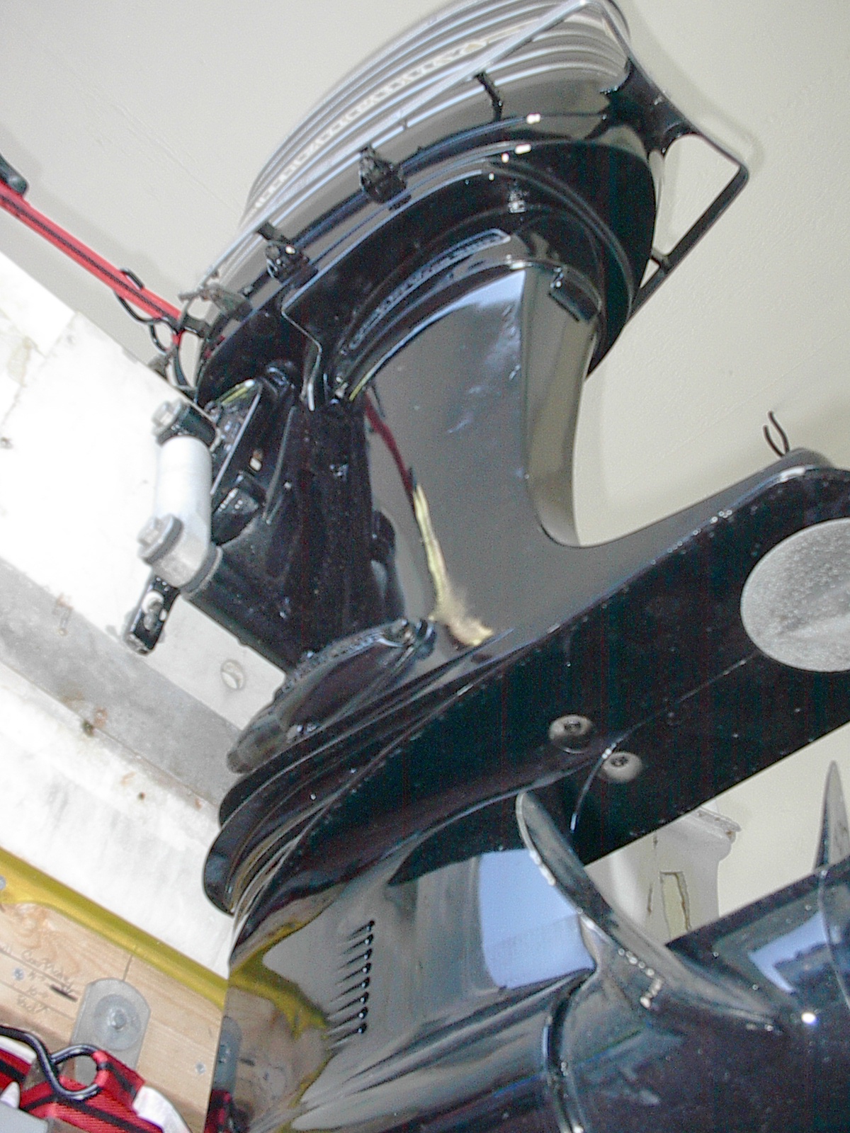

I have enjoyed reading about your progress, however the outboard mounting height is still too low based on the appearance that the lower Driveshaft Housing Splash Plate is approximately in line with the tunnel. Actually, the underside of the Gear Housing Ventilation Plate (about 2 inches lower down, and above the propeller) should at least in line with the tunnel or a small amount higher. The mounting height must be at least such that none of the Driveshaft Housing is in contact with the water exiting the tunnel, or anyone riding in the stern will likely get quite a bath, and propoising will likely be a serious problem.
Regards,
Joe
www.fergusonpoolemarine.com

The propeller presently installed has a lower rake angle and appears to be uncupped. Considering the greater amount of aerated water generally seen with a tunnel design, a more modern higher rake and cupped blade propeller is likely in order for satisfaction. Some additional propeller installation pieces will be necessary though.
Having the propeller "vented" will also improve matters, especially considering the relatively short hull length combined with the heavier outboard.

Thanx for the reply Joe but now I'm confused. To set the motor hieght as you recomended I would have to raise the motor 3 1/4". This would put the top of the prop at the same level as the top of the drain plugs. It just seems high :unsure:
I would like to get an extra prop or 2 to take with to Brazil the prop on it is #4B 65748 A1 17P. any recomendations would be welcome.
