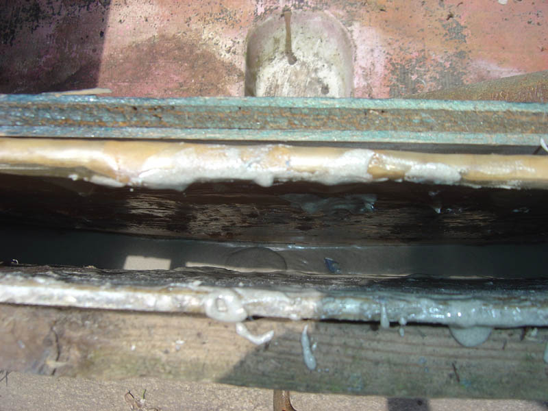

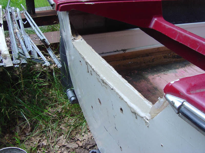

I have around 8 man-hours (over a 2-day period) in my '67 MFG Transom. Lots of time waiting for fiberglass to harden etc..
It is a "poured" transom using Nidabond.
www.raylinrestoration.com/BoatStuff/MFG-Transom/index.htm
I have at least 3-times that in the transom replacement of the Fabuglas. But there was alot more "other" things that were transom-dependant. So I have over a week in it.
Depending on YOUR Boat's type of transom... it may be quick and easy- or a PITA.

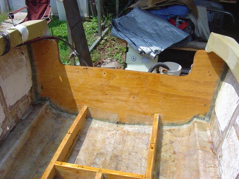

The MFG did not have a splashwell. But it does have a fiberglass bar across the back. I did not have to remove the deck to get at the inner skin of the transom. Splitting the boat would have made it easier- but not much, and the rest didn't need anything.
The Fabuglas had a wooden splashwell. The interior of the boat was completely gutted from the cabin bulkhead to the transom. This was to do the stringers, floor, splashwell, and rear bench seating area.
