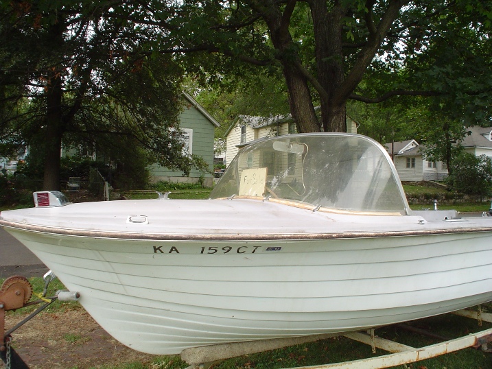

I think I am about to get off into the deep end. I haven't exactly cleared this project with the chief financial officer of this household but so much for the details.
I am trying to brainstorm a plan of action. I think my first goal is to finish a complete cleaning of the boat and try to inspect the inside and outside of the hull. If everything looks good then I will get into the work end of things.
I think a good cover is the first step. I plan on removing the motor for inside work this winter. The boat will remain outside covered.
The priorities are;
Check hull
Motor repair/replacement
Seats
wiring
steering
Somewhere down the line I will worry about the exterior.
I am really confused about what to do with the motor. I have never rebuilt a marine motor. I have rebuilt numerous car motors and have all the equipment. I am a bit intimidated by the task. I am also considering trying to find a '65 vintage motor or upgrade to new. I just don't know
Help guys. Tell me if I am going the right direction.

The motor is a 1971 85 HP. I swapped out the original 65 HP years ago. The boat is technically only rated for 75HP but I ran the 85 for years with no problem. Pull enough skiers in my youth to buy an oil refinery!
The motor is stuck. I will start with unsticking if possible and then go from there.
