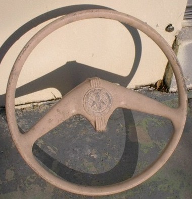

Hello, I'm a long time reader...1st time poster and have a weakness for multihulls. Today at a yard sale I picked up an old steering wheel to use on a home built I'm buildin' on. The logo in the center reads QUICKSILVER KIEKHAEFER CORP CEDARBURG WIS, 2 spoke, cast metal, painted a couple times along time ago.
My question is, being a 50 year old cast metal wheel would it be safe to use today at speed, 50-70 mph? I'm going for a vintage look, have the motor and control, thought this would be a nice touch. Thanx for your input 8^) CAT FINk

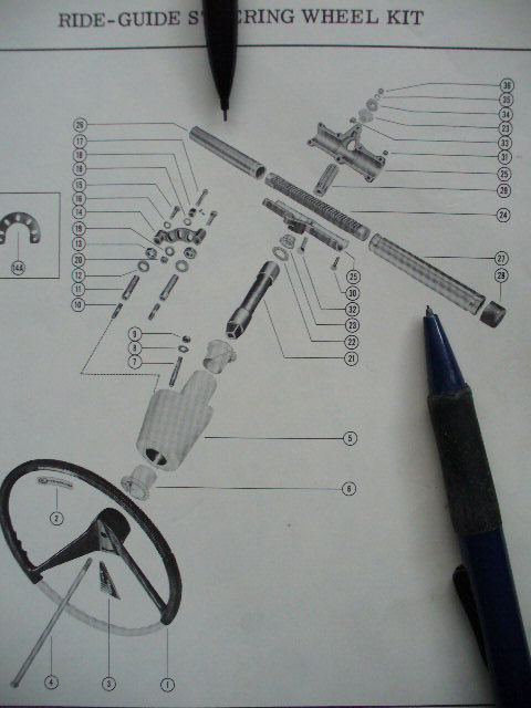

Here's a pic of the Ride-Guide square taper mount, hope it helps...
and a parts breakdown provided by a helpful friend;

Mark, could you send me a blow up scan of the parts break down. I will be resstoring the same exact wheel. Thanks.
Eduardo
Re:Quicksilver steering wheel? 16 years 7 months ago #2139
In the meantime... maybe this will help.
Re:Quicksilver steering wheel? 16 years 7 months ago #2144
Eduardo, the one GT160 just posted blows up nicely, will that work for you?

Thanks Mark and GT160. That's exactly what I'm looking for. Appreciate it. Will post pics of the wheel and emblem.

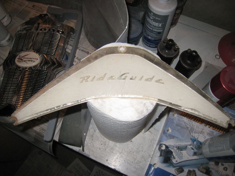

Hi Mark ,
I've got one of these wheels but it has no cover on the front , could you post a picture of your cover plate. It may help me to find something similar .
Cheers , Steve

Morning Steve,
I'd be glad to, but it will be tomorrow. The Cutter is out in the side yard under a tarp. Gotta drive my wife to AL (9hrs round trip) to visit her mother today.
Re:Quicksilver steering wheel? 16 years 7 months ago #2208

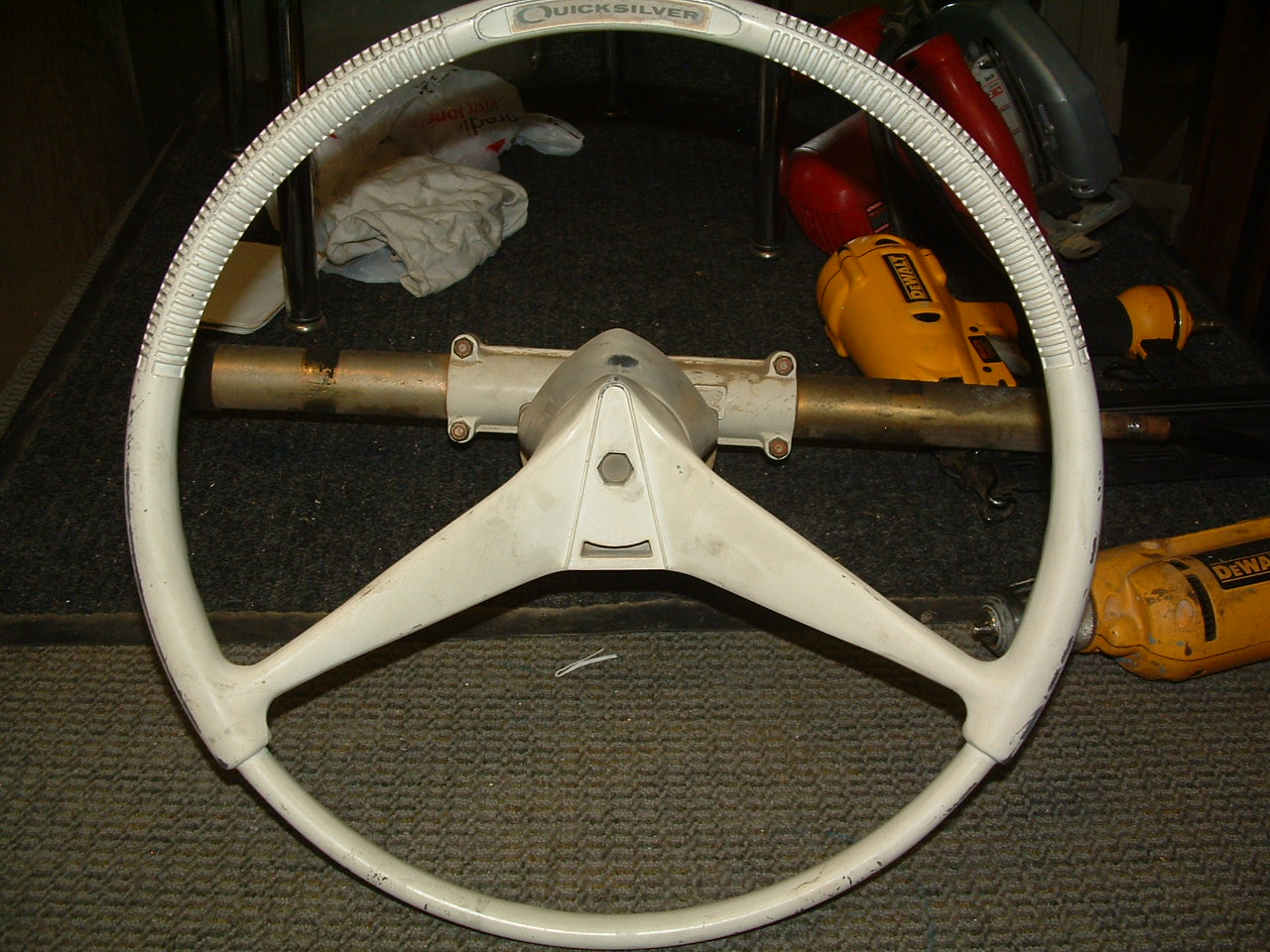

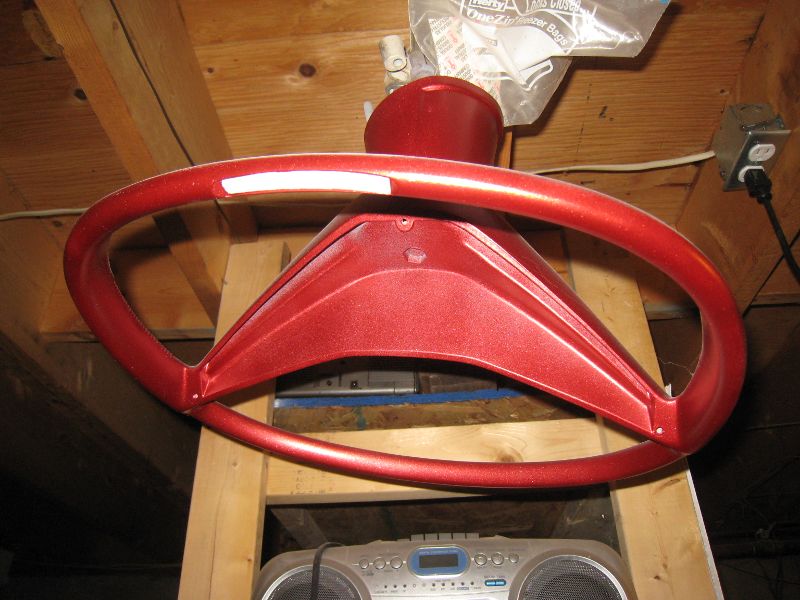

Here's a few pics of my cover plate and my refinished wheel.
Wheel is red metallic rattle can paint over self-etching primer over a clean and well sanded wheel. Sorry it's a little dusty right now, it's been hanging off the ceiling in my cellar a while. I'll be taking it down soon, as I need to change the color of the part that mounts against my red dash. Probably do it in silver metallic for some contrast.
Frank

That's a cool wheel, I like the 2-tone. I found Rex Marine has adapters for a new wheel on the square shaft. This one I have is cast metal, thinkin' it'll look good polished. Having trouble getting a pic to post...CAT*FINk
Re:Quicksilver steering wheel? 16 years 7 months ago #2249
That's a nice one, don't think I've seen one like that yet. It should clean up nicely!

Frank - My cover looks exactly like yours, with the two outer screw holes broken. I used to be famous for over-torquing everything, but I swear someone else had already gotten to it! Must be a common problem with those plastic covers. My screws that hold that cover are all rusty too, but I know they're special design and probably not readily available.

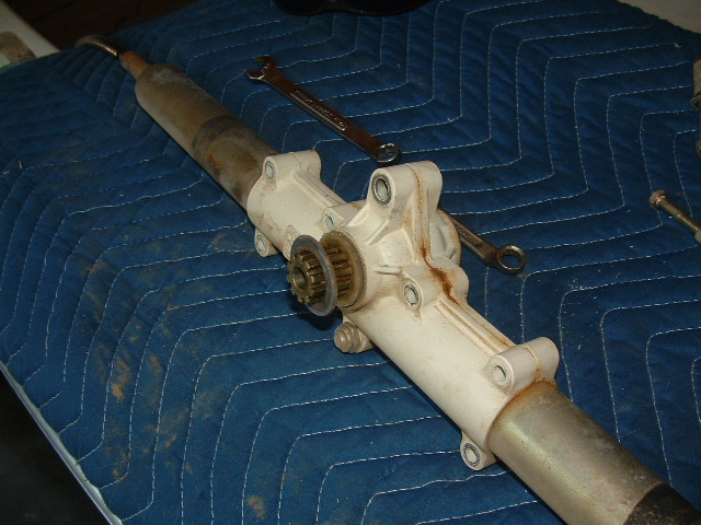

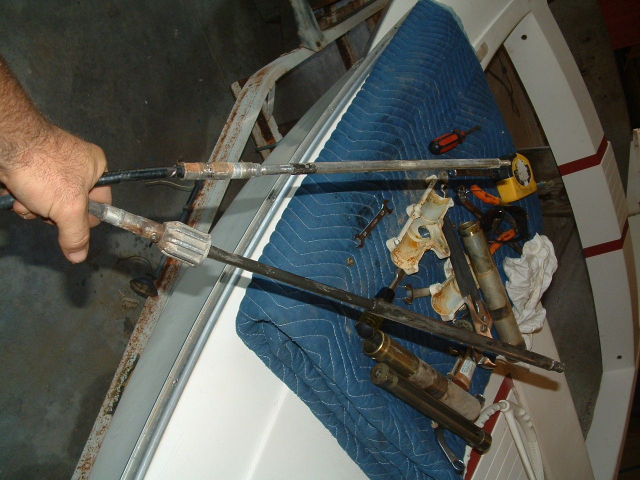

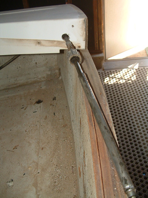

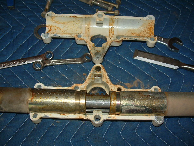

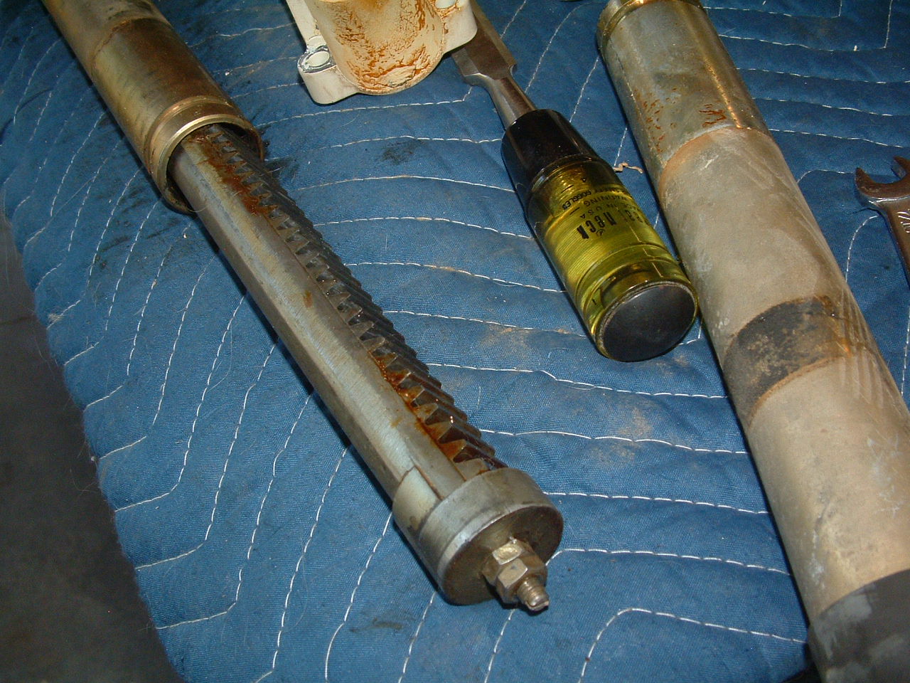

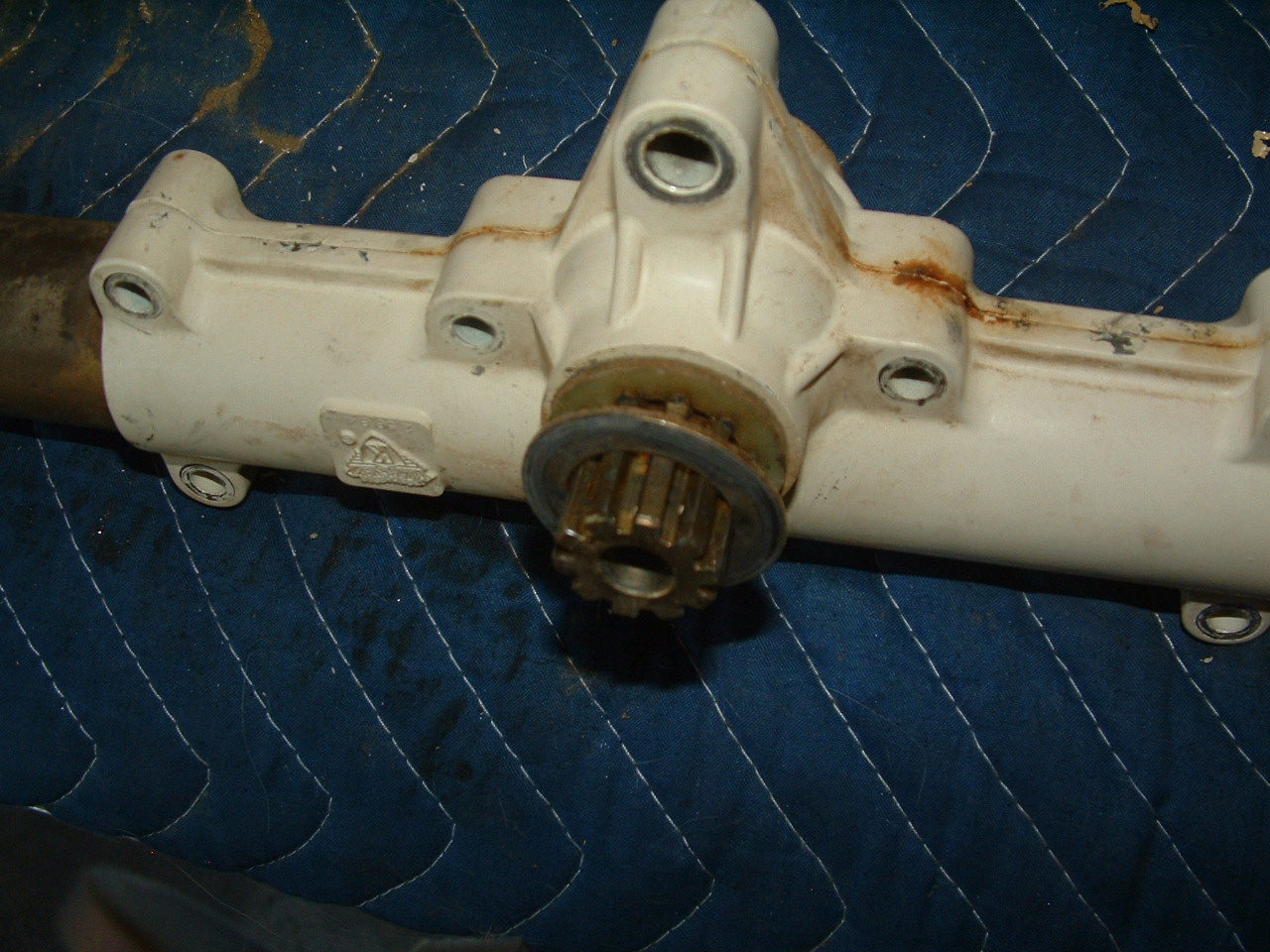

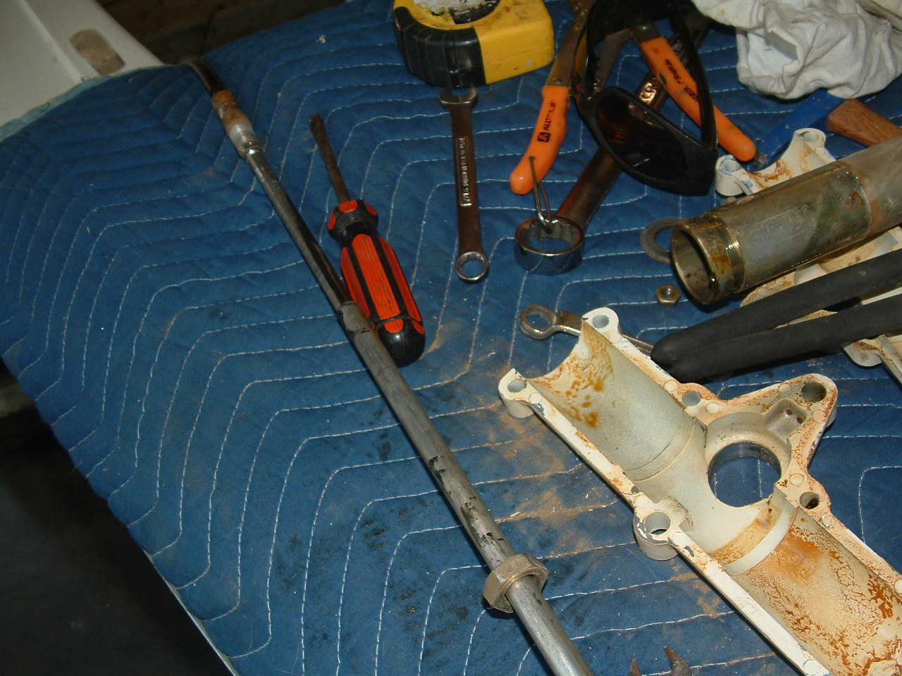

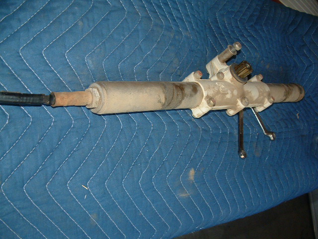

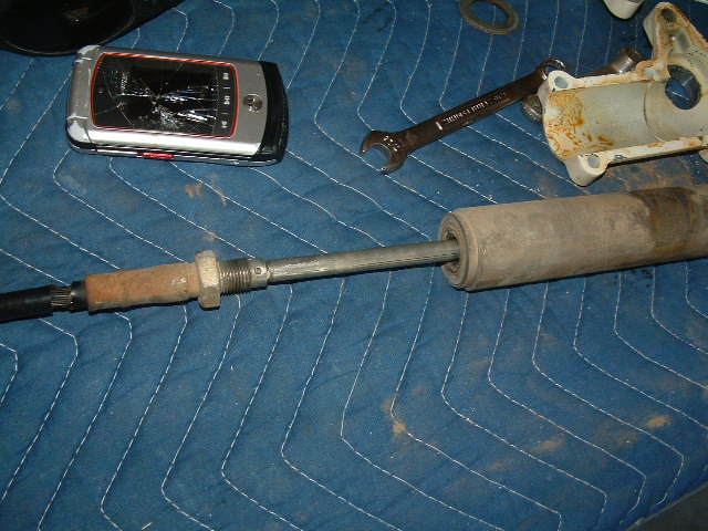

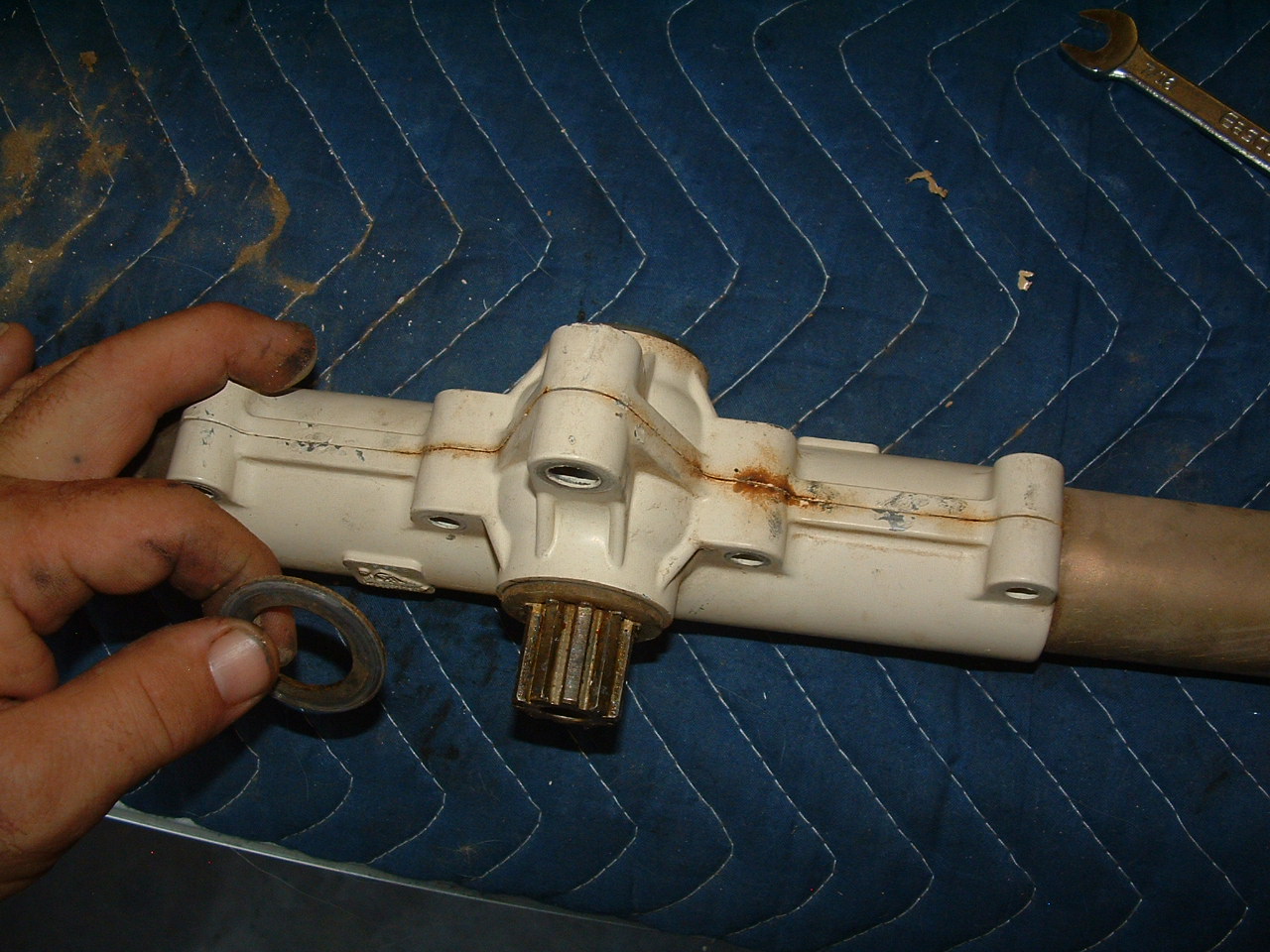

Guy's I need some help. I wanted to have this off yesterday but came to a stand still on this part. I need to get the cable through the stern of my boat. The opening is less then an inch so I need to split the cable. How do I do this??? I dont want to mess up anything.
Oh, I think its a quick silver brand, well atleast a kookie classic mercury brand name. I did a bunch of research but I dont have all day to search any more, ive looked for 6 hours already......
Anyway here are the pics of where im at, JUST WONDERING WHAT TO EXPEXT and can I screw it up. I think I need to split the rack, Mike
Re:Quicksilver steering wheel? 16 years 1 month ago #13333
Looks like my Ride Guide set-up. Ride Guide was made by Kiekhaefer, the dude that started Mercury outboards.
I'm not clear on what you're asking Mike. You want to get the steering rack through the hole? If you take the rack apart, be prepared to spend some time getting it back together correctly. It can be done, but at least in my case, it was very frustrating!
Frank

Frank, I need to get the cable over to a table that is on the other side on the garage, lol..... I have began a wood replacement on my g3. I need to get the cable through the little hole in my first pic and need to eventually maybe replace the cable but I think I have a replacement already.. So if I have to split the rack It CAN be bad huh??? Any pics??? I dont want to cut the cable or cut my g3!!!lol..... so im sitting in a chair, at the computer when I have a boat load of work to do and cant figure this out... I think im just going to dig in but kinda just want to know what to expect. I guess Ill have to be carefull and take pics my self for future reference, Mike
ps ill wait a while before I jump in. Any advice or help would be great...
Re:Quicksilver steering wheel? 16 years 1 month ago #13336
split the rack casing, then unscrew the nut at the end of the rack to remove the cable from the rack then you can feed the cable through the small hole in the glass
Re:Quicksilver steering wheel? 16 years 1 month ago #13339
  • Bigfoot
  • Bigfoot's Avatar
  • Posts: 282
  • Karma: 22

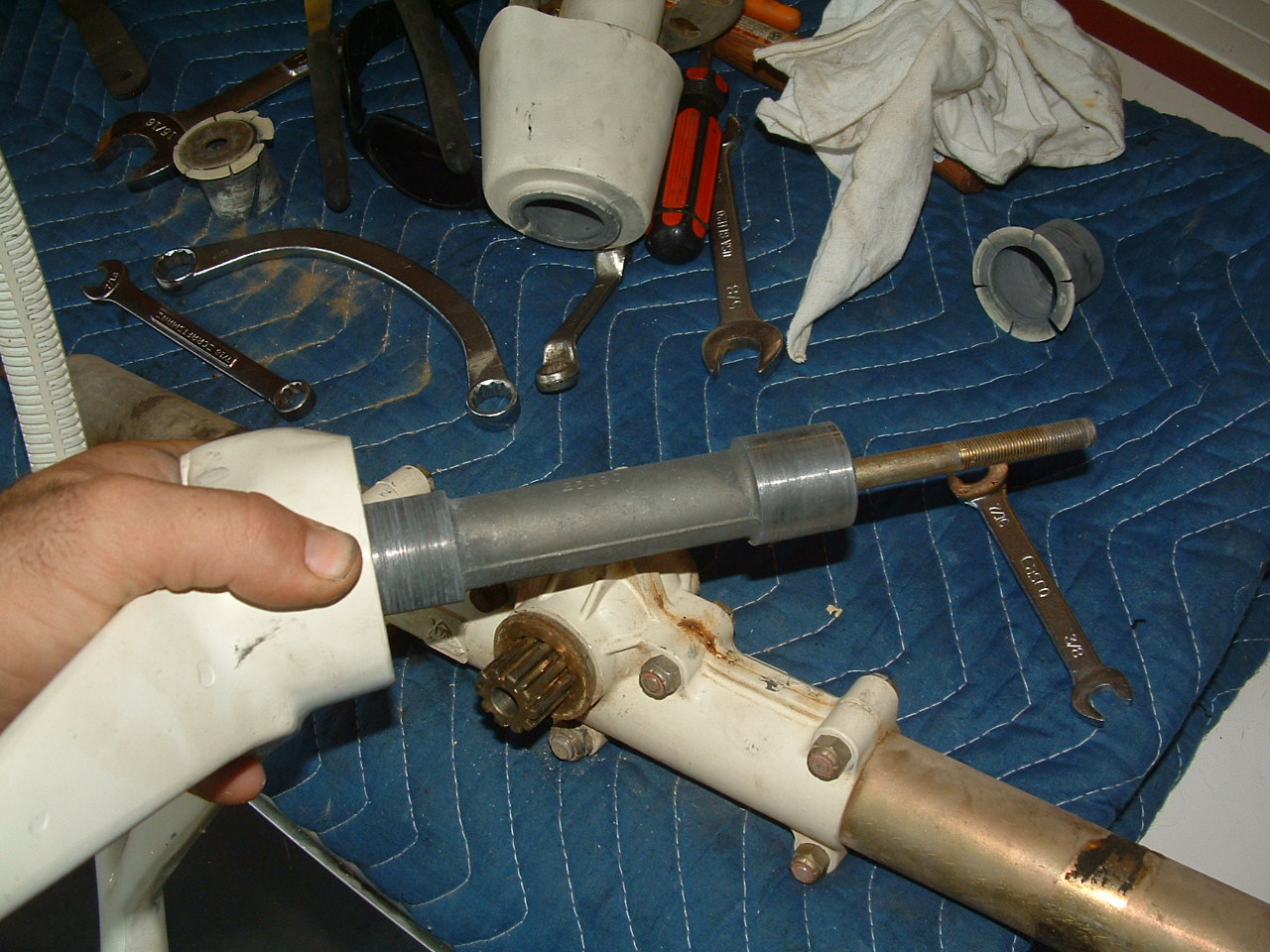

Thanks MadProps....

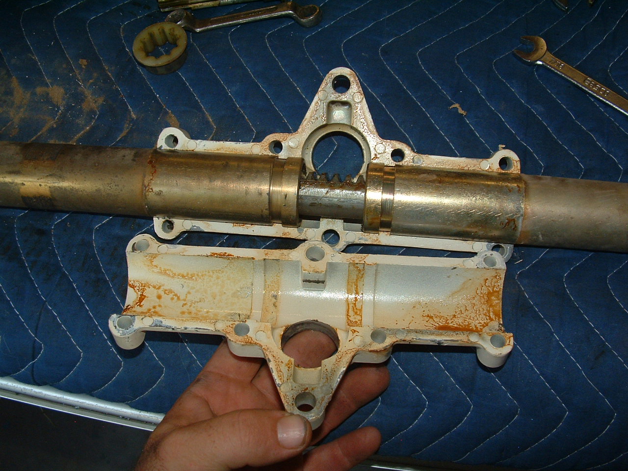

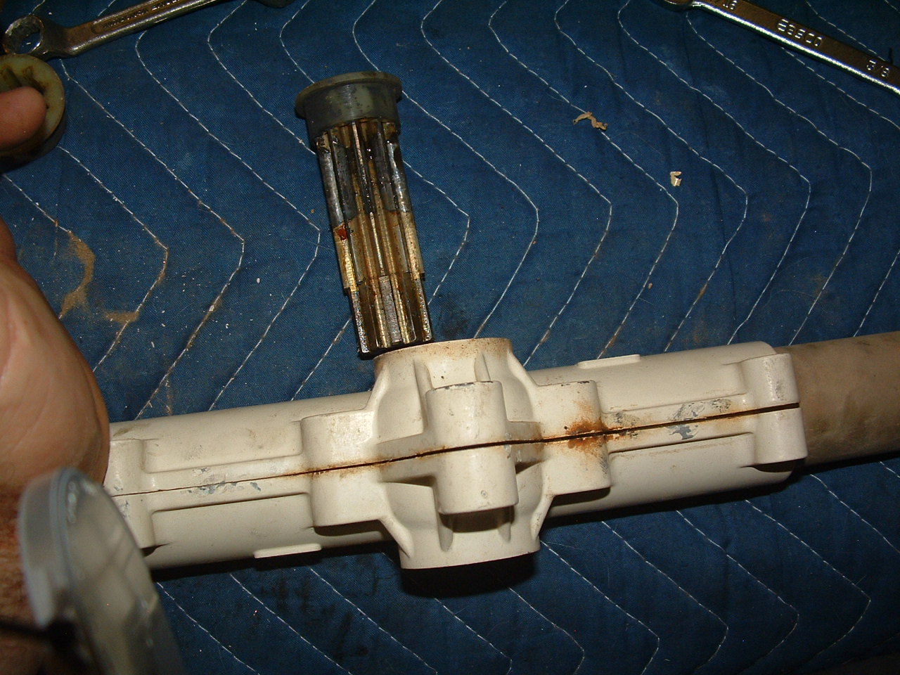

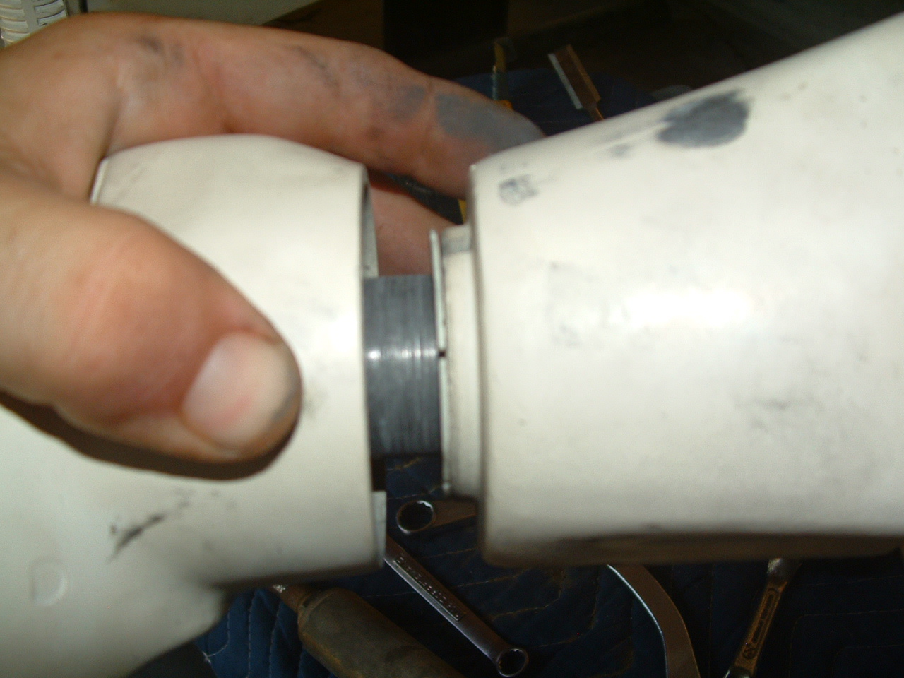

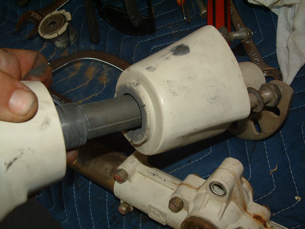

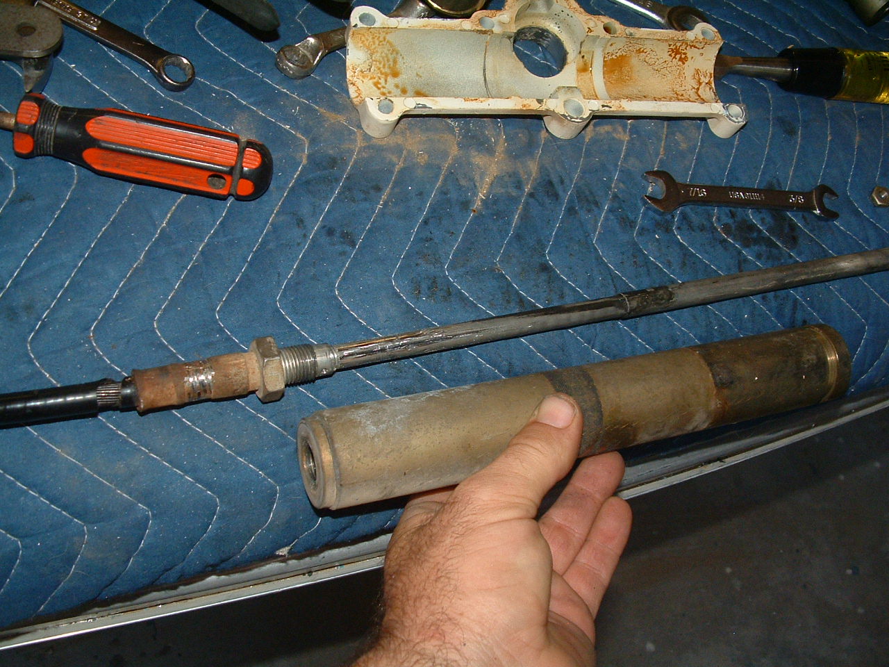

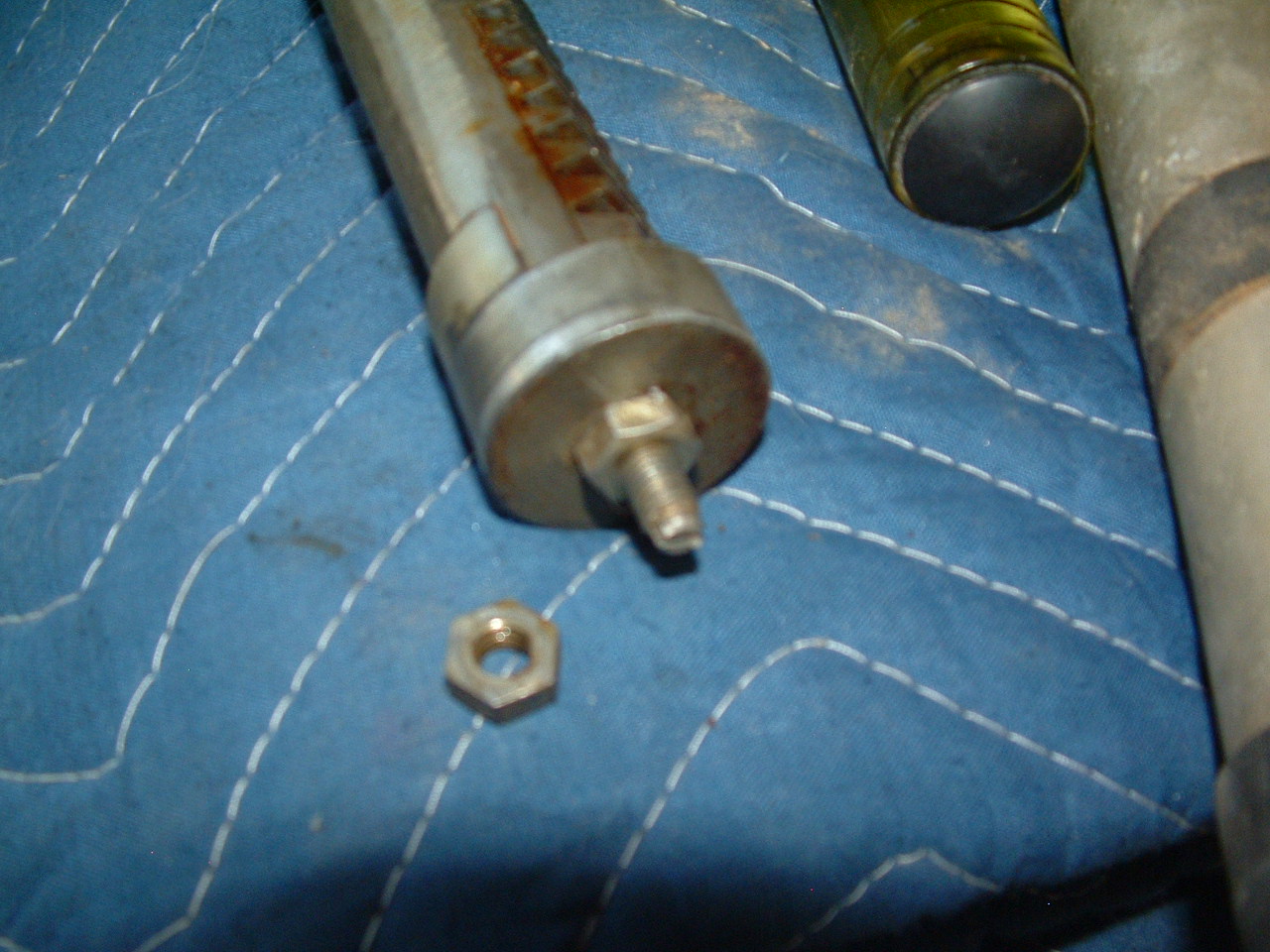

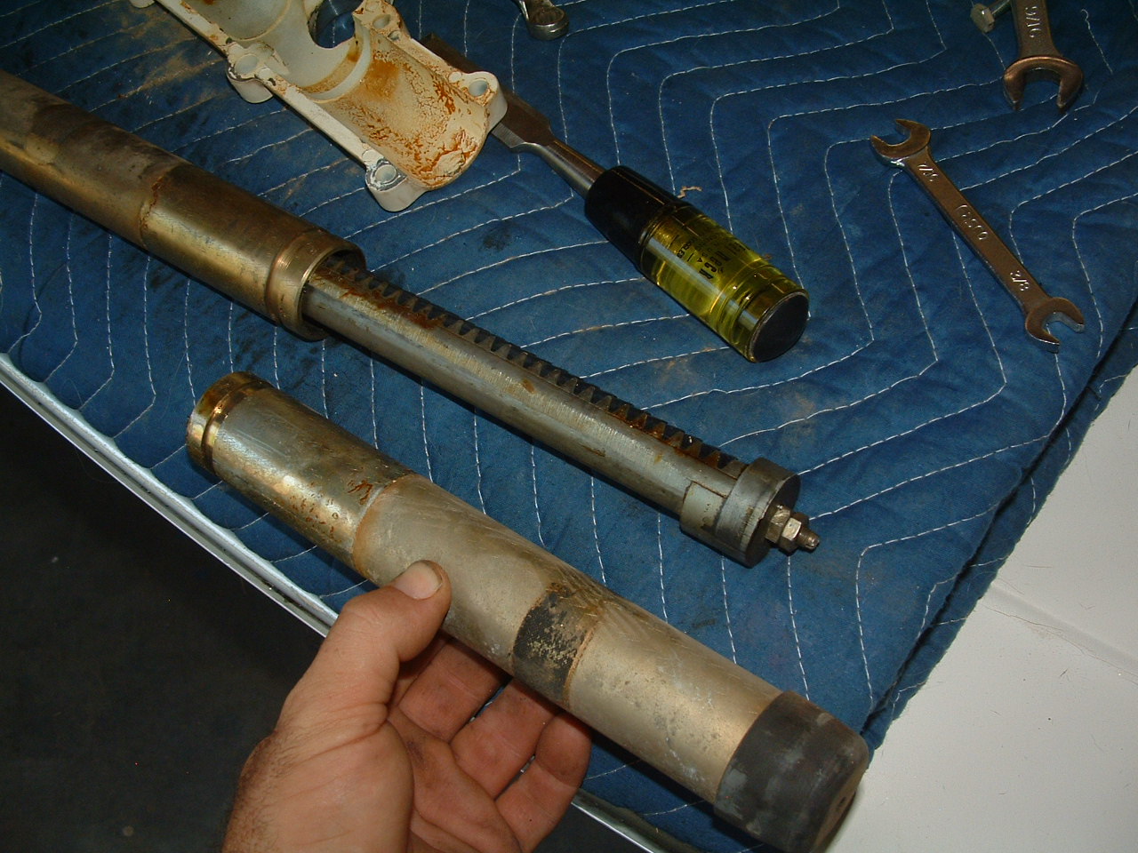

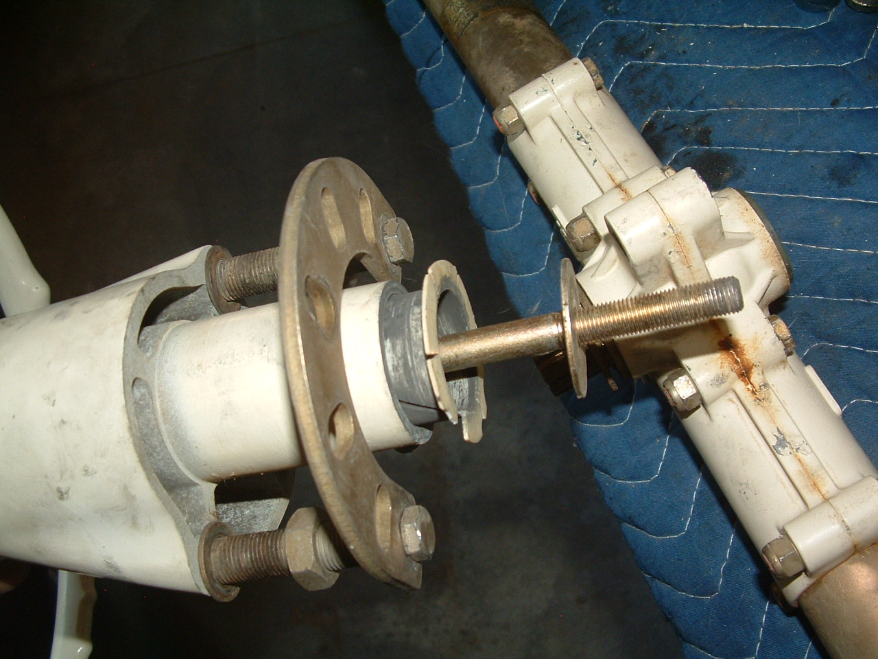

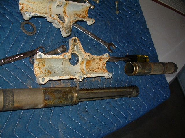

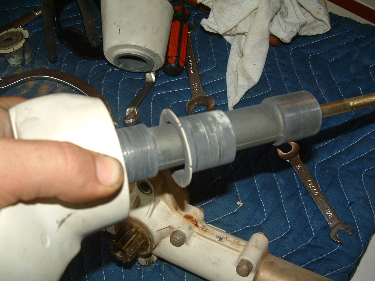

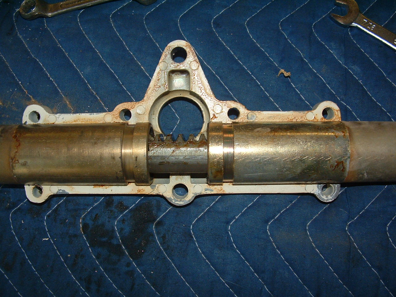

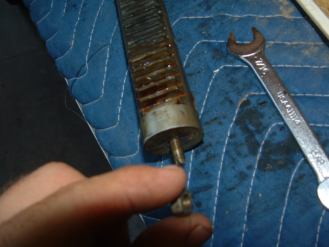

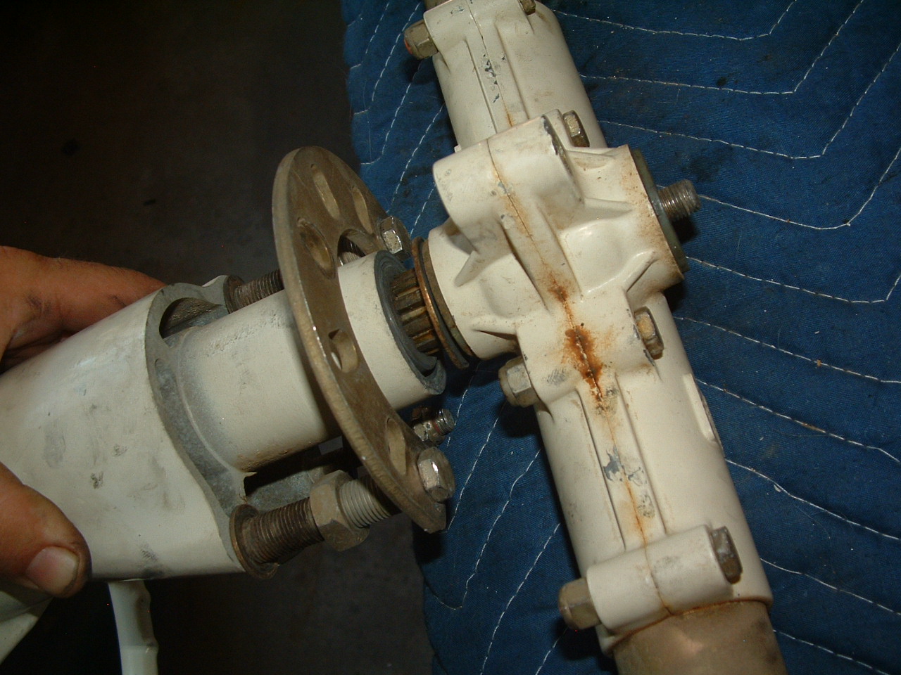

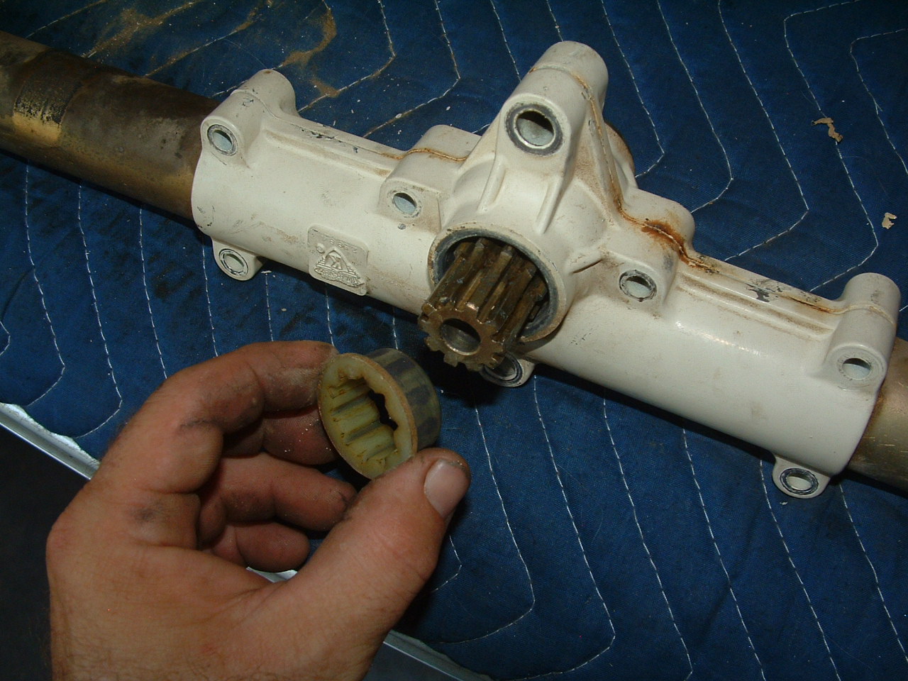

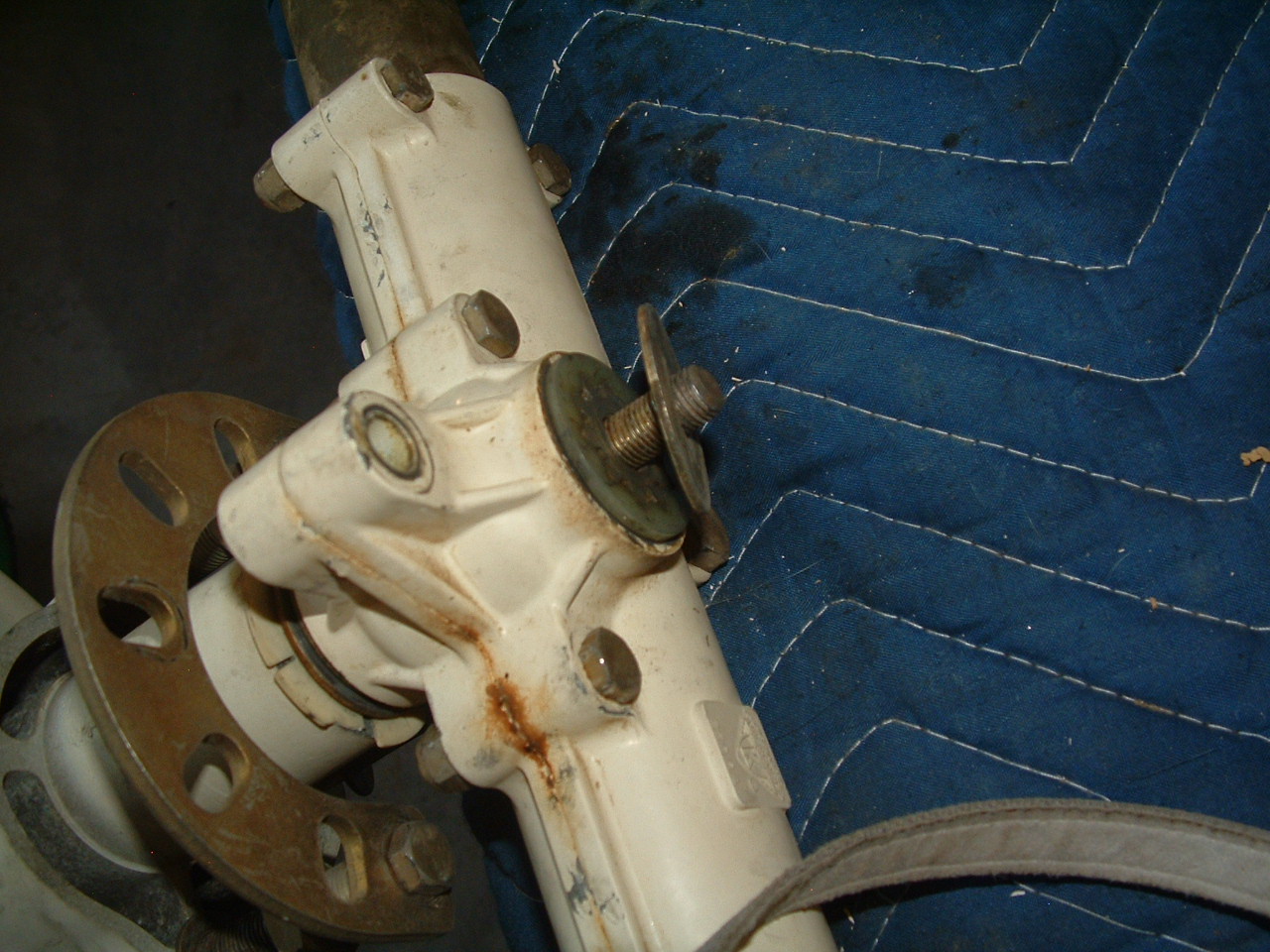

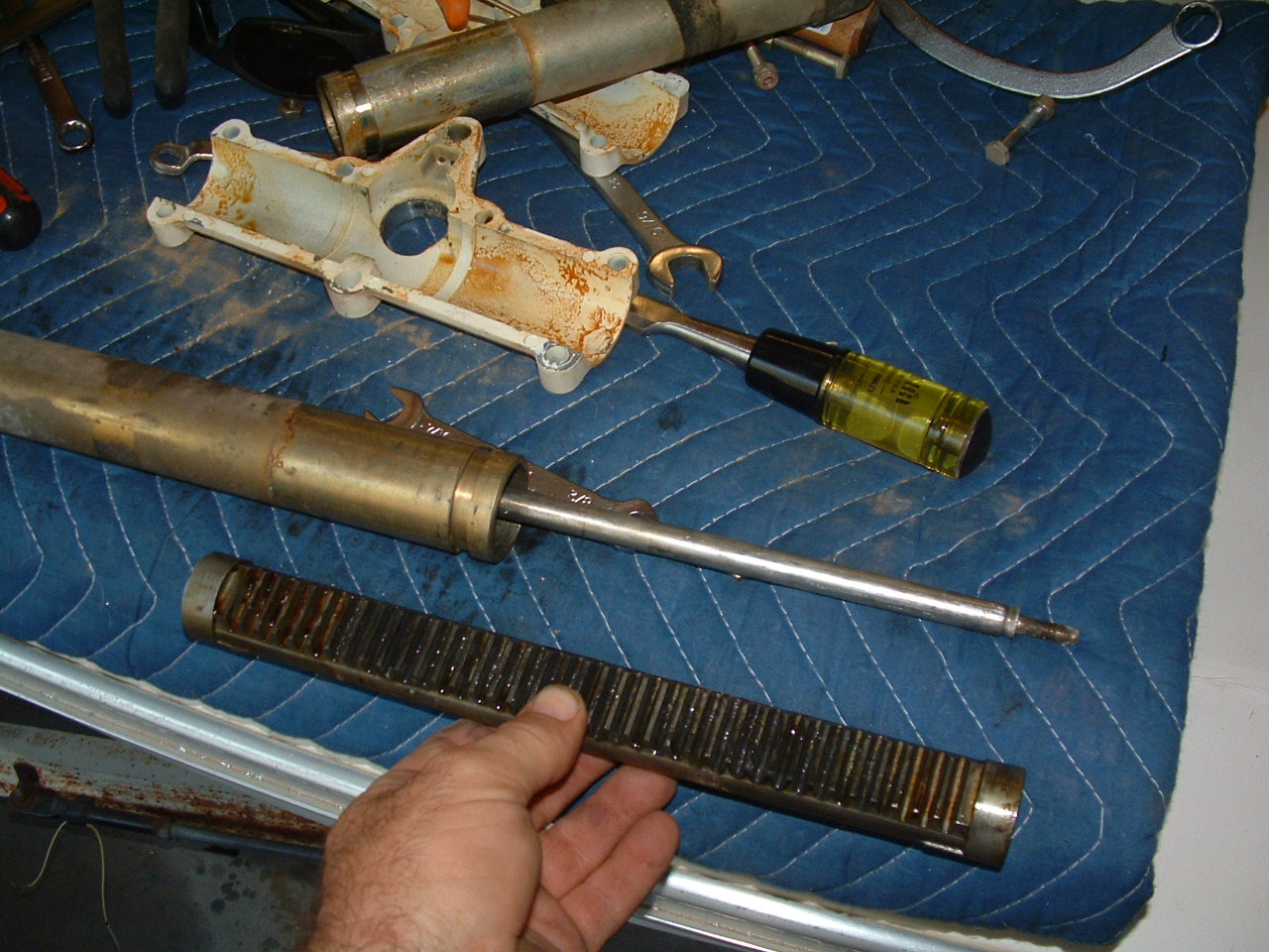

I got the rack apart and took a bunch of pics for future readers, well I took the pics so I could remember how it went but it was easy. No hydraulic fluid that I saw anyway, Here you go, Mike
OKAY, Now lets put it back together to store on a shelf so it can later be reinstalled
This next pic the washer on the end goes on the other end of the rack. I just happend to photorgaph it. Also the plastic washer is what the poster above refered to as a "top hat"

Okay, it took 45 minutes to upload 45 pics. Its done now and we have something { a step by step } to look back on for others to learn from. Mike

Sorry I was at work when all this was going on, Mike. Here's a breakdown Joe sent me one time, maybe for the benefit of others down the road??
On mine, you didn't have to split the rack to unhook the cable thought, it had a platic/rubber cap on the end you could remove. I believe there must be a couple of variations of this design.
