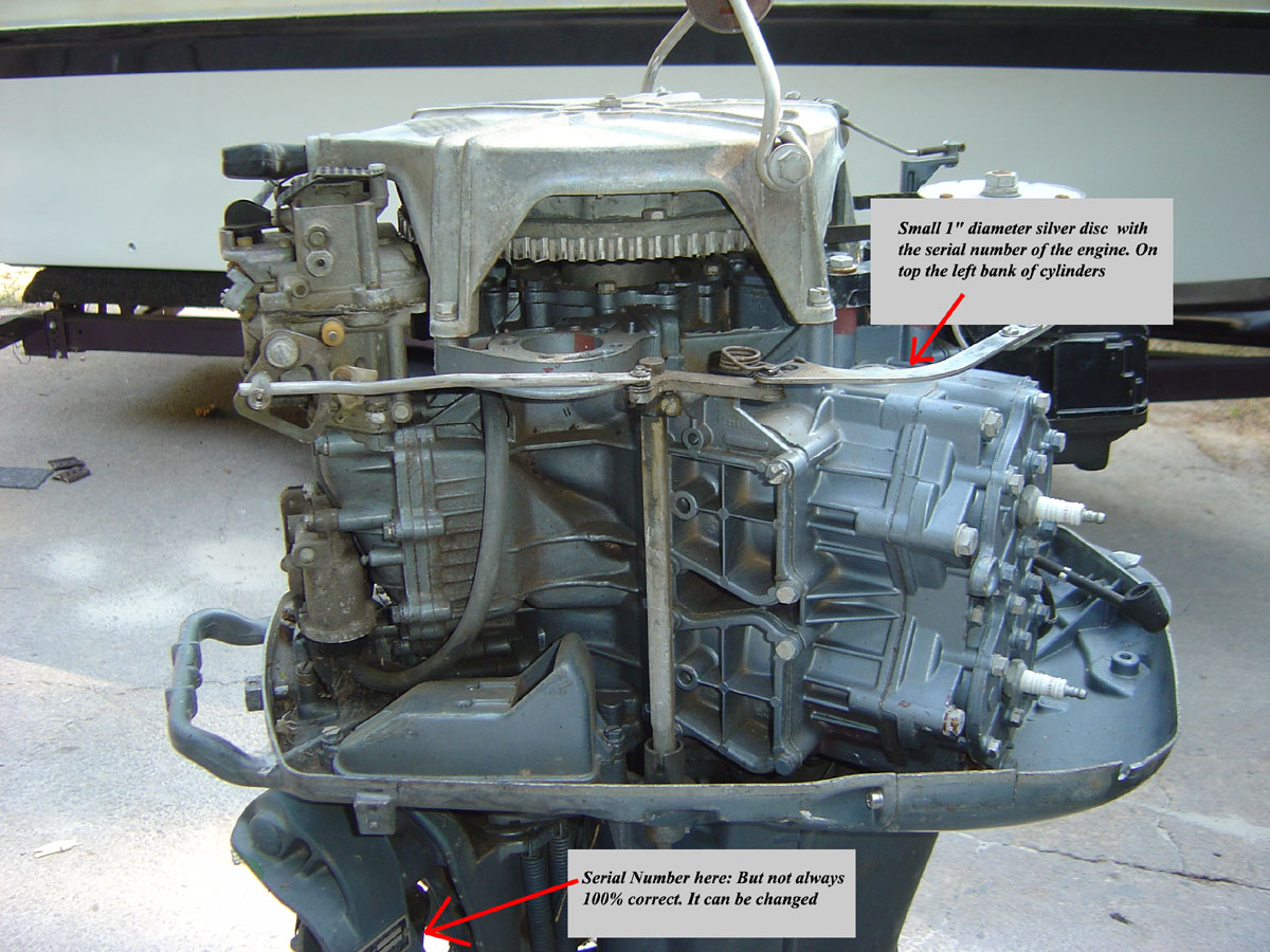

That is likely a 1968.. but the only real way to tell is by serial number- as the motor covers can get changed. Here is my '68 65HP.
It appears to have been painted- as the lower part of the cover should be a beige-gold

Indeed, the motor covers can be changed. Look over the powerhead closely for a welch plug set into the block, stamped with the model number and serial number. The hood is a 1968. If the motor is a 1968 100 HP, it should have the under-flywheel mounted distributor and electronic ignition (pulse pack, transformer- no coil/points/condensor). The fuel system was changed from '66 to '67. Apart from the ignition and fuel system changes, the 1966 to 1968 100 HP models are about identical.

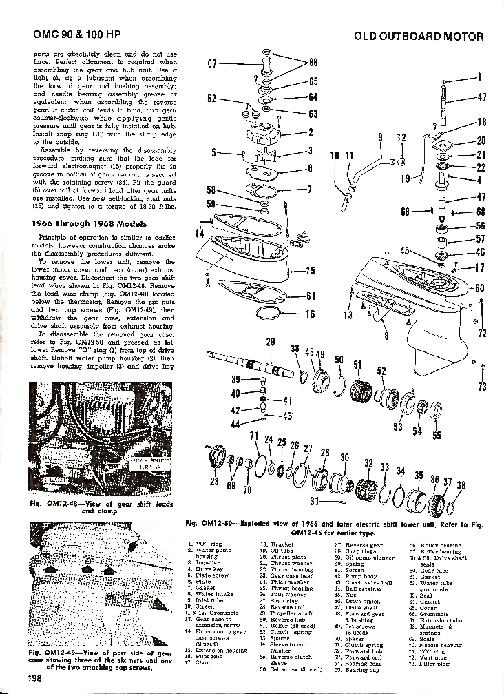

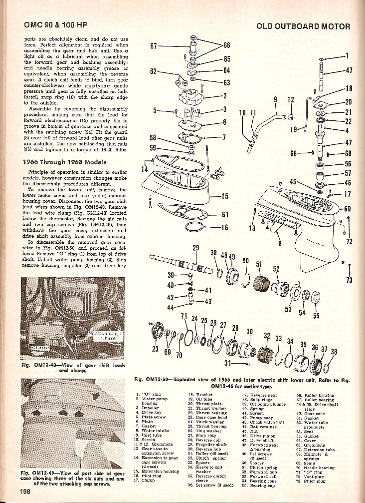

So when removing the gearcase the book says to engage the forward drive and turn the propeller shaft to expose the shift nut (?). On an electric shift .... where is the lever to engage the engine into forward and reverse?!?!?! I can't even get the gear case off!! I want to rebuild the water pump unit (which includes replacing the impeller right?), but can't get to it. Any suggestions?!
Re:Can Someone PLEASE Tell Me What Year This Is?! 16 years 1 month ago #15581
Which book are you using? The following is from Intertec's Old Outboard Service Book which has condensed service info for a number of makes and models.

I found an Evinrude service manual at the library. It's not fot a '68, but I figured that gearcase removal would be pretty universal. For all year models it covers it says the same thing,"engage forward lever, and turn prop shaft to expose a linkage screw (?) inside". I just don't get it. This engine is electronic shift, and nothing on my engine looks like any of the diagrams in the book. I guess this is going to be one of those times that I'm going to have to spend money on the '68 manual and pray that I can understand it. I really want to learn how to do this so I can take pride in it once I'm able to launch her. I've got the Rude indside so I can spend all winter on it .... learning how to fix and maintain it. I've got the boat down to hull, floor, and main wiring harness. Going to install new instument panel (LED gauges) and wiring. I found diagrams on instument panel wiring from Glastron, so I'm pretty confident there .... it's just this outboard is confusing the heck out of me.
Re:Can Someone PLEASE Tell Me What Year This Is?! 16 years 1 month ago #15649
To undo the shift find the BLUE and GREEN wires, likely nestled in the belly pan near the rear. There should be a rubber sleeve over a portion of each. Slide the sleeve to one side to reveal a scissor connector on each wire and undo the connector.
Now, I'm not 100% sure on this, but I think the wire runs into a removeable cover UNDER the outer cover on the motor leg. The outer cover is kinda diamond shaped and if you pull that you should see the wire going into a small oval shaped cover. Remove the oval cover and feed the wire through it.
That should do it for undoing the shift. The rest is just the six bolts holding the foot in place.

Re:Can Someone PLEASE Tell Me What Year This Is?! 16 years 1 month ago #15706
Lol. It's quite alright man. It took me awhile to become interested in the finer things in life too. I couldn't pass this deal by .... '78 Glastron (17') and trailer w/ outboard for $100. Pretty roomy boat .... should make for nice days on the water with the family next summer. Going to replace most of the supports, the floor, the instument panel and guages, and rebuild the '68 Rude. Nothing like cruising the lake in a classic beauty right?! Heh heh heh.
Thanks for the diagram bro, and I appreciate the "follow the wires" tip too. Hopefully I can drop the gearcase off after today's drag races.
