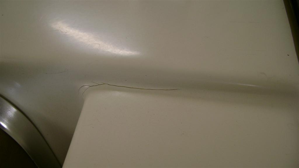

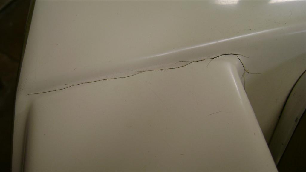

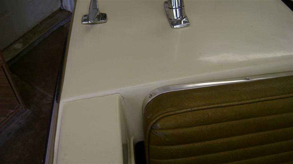

These cracks in the fiberglass at the aft end of my gunwales weren't there when I bought the Starflite this past winter, I feel sure I would have noticed them. The one on the starboard side is worse, and appears to be "growing".
The transom is still sound and solid, although I did notice some black (rotted) wood stuck to the screw when I went to change my pitot tube recently. (I attributed this to poor bedding of the hardware during initial installation.) I also noticed a couple of soft spots in the sole Saturday morning when I was out on the lake that weren't there before.
I've read here somewhere that it is not uncommon to have a Glassic seem solid when you first bring her back into service, but then have structural wood issues shortly thereafter. Should I be planning on a total transom/stringer/floor replacement this winter? And an even more pressing question, would it be alright to keep using the boat a few more times if I take it easy with her - quit jumping wakes etc..?
I'm thinking I need to get parts 1 and 3 finsihed (read) of Jamil's tutorial, and patiently await part 2! LOL (I'm really not laughing tho, kinda bummed actually.)

wow mark,those are definatly stress cracks,it looks as if the gunwales are pulling away from the transom,you need to get a better look at them from underneath,that should tell you alot more then i can,i would stop using it untill you find out just how bad it is.wow now im bummed out for you buddy,thats a nice boat and your a good guy.if you get under the spashwell and take pics of the cracks from there ,post them,you will recieve help,you have helped us before,its your turn for our help!

Hi Mike, You mean like this? or this?
Re:Stress cracks in gunwales ? Need advise. 16 years 2 months ago #14573
wow mark,damn,im sorry,it doesnt look good buddy,and the craks are on the gunwales ahead of the transom,that doesnt look like an easy fix,but im here if you need me.john

I'd be very surprised if a flexing transom had anything to do with those cracks. Those are part of the deck, not the gunnels. If the transom wood is wet, as most are, it will eventually fail. You can do a visual check for transom flex. Lock the engine in the full tilt position, then pull downward on the lower unit. Don't pull so hard that you break the tilt bar, but it can take a good firm jolt without any damage. Have a helper stand in - line with the transom wall & watch for any sign of flex. It should not bow outward or flex when this is done. If it flexes a tiny bit, no need to replace it - yet. Keep an eye on it though. Sighs of transom failure - cracked areas where the splashwell is attached to the transom, delamination, and motor brackets that are crushing into the structure. I'd put a few 8" wide strips of mat & cloth on the underside - centered over the entire length of the crack or longer. That is probably a weak area that is cracking due to pounding from torn up water.

Cracks only occur where there is flexing. Gel is usually a little pliable so it cna go with the glass as it flexes some. There are limits and conditions it can withstand. Where you are seeing cracking is probably due partly to workmanship and the location.
Excess flexing aside due to possilbe stringer/transom work, the area you photographed is suseptable to gel cracking as it is a sharp inside corner. During manufacture, it is very difficult to get fiberglass to laminate on a sharp corner like that so it is likely that the gel coat right in the corner is not bonded to any underlaying glass laminate. In thinking about how the boat is built, the gel is sprayed on first into the mold, because the deck is inverted this sharp inside corner is a sharp outside corner, when laminating th glass fabric likes to bulge away from sharp outside corners. Good practice is to radius all outside corners so the lamination glass fibers can conform to a radius rather than trying to bend over a corner. Glastron had designed in an area suseptible to stress cracks. I'll bet if you poke very near the crack with a pin you will see there is a slight gap between the gel and the underlying glass. Gel gets brittle with age lessing it's ability to flex and further without the support of the laminate right at the corner it is more likely to crack with even slight flexing which would exist in even a new boat.
