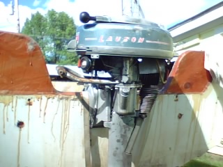

well I got it to run used acetone to clean the varnish out of the tank still need a tiller arm for it hear is a pic of the motor
