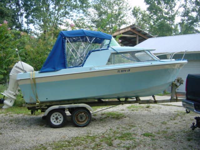

Hi I am new to old boat ownership, I just purchased a 1968 fabuglas tempest and it has had some "updating" done to it, I was wondering if originally these had a built in fuel tank or if they used portable tanks, the person who remodeled the boat put a 30 gallon tank under the front seats and I am experincing quite a bit of fuel slosh, I want to take it out and relocate a tank somewhere else, any suggestions?

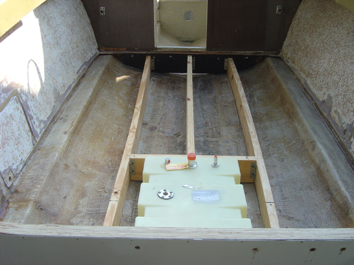

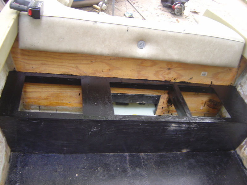

I am in the middle of "rebuilding" a 1969 Fabuglas Cruiser. I put a 12 Gallon belly tank under the rear splashwell/seat. #0 gallons is alot of fuel in a big tank. Your trouble will be that these tanks aren't baffled. They are just wide-open, so sloshing is inherent to the design. I don't think I'd want 30 gallons at the transom either...

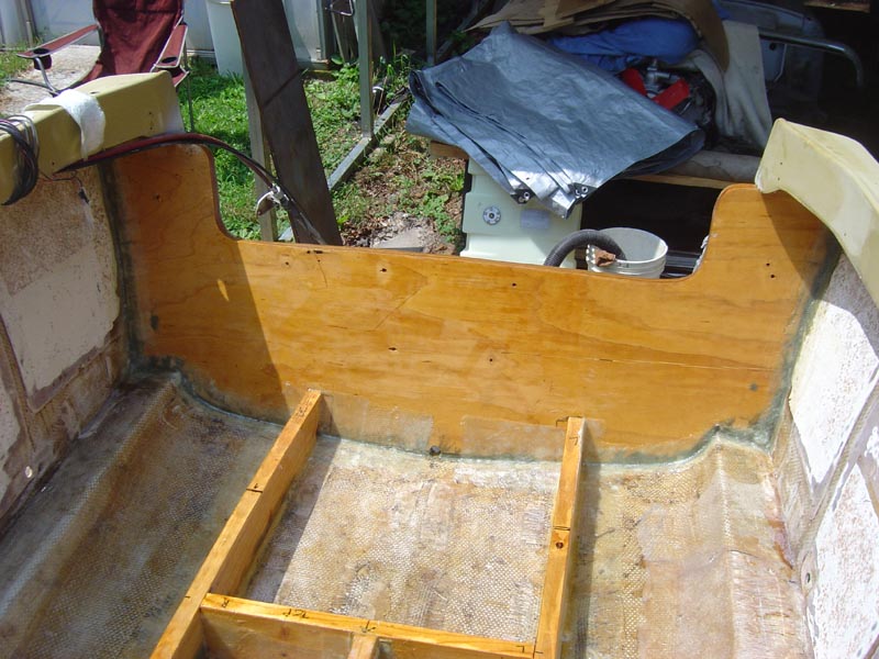

I redid my transom, floor and stringers. I even made up a photo gallery.. I am redoing the gallery.. and should re-post it soon (this week). Your hull is very similar in design.
The stringers and belly tank:
The Stringers and Transom:
Rebuilding the rear splashwell/seat

Thanks for the info and the pics, I cant wait to see all of your pics, the paint scheme you are doing is very cool looking, I am going to have to do something to spruce up the paint scheme on my boat as well and I definatley want to get some fabuglas logos made, do you happen to have those logos you are using in jpeg format that you could send me? they look very cool!
I have been trying to think of a name for the boat and I think I have settled on "life is fabuglas"
