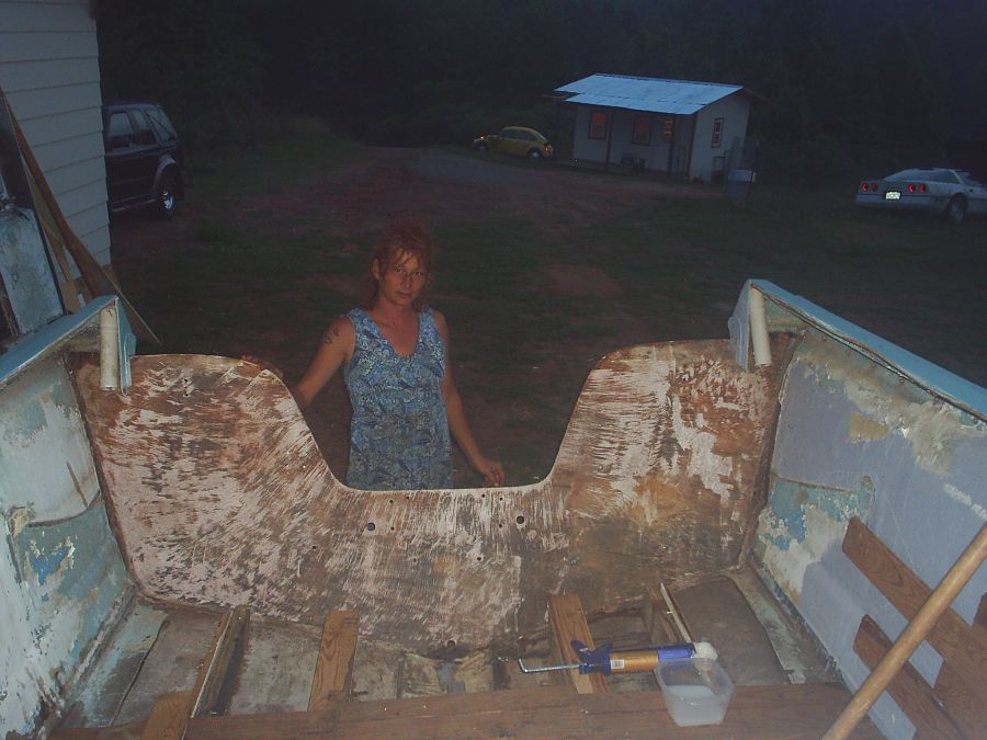

This is on a '59 Crosby Cruisette.. The wood is completely rotten inside the 2 pieces of fiberglass/metal plating(inside) and I'm wondering if cutting the whole thing out & replacing it is best? Or just taking out the rotten & replace with new wood & bulking the whole transom up would be better? I talked to a friend that owns a boat repair shop and he said since it's laminated (not actually bonded together) between the 2 pieces, I should just replace the wood & bulk it up. Suggestions?

First welcome! A Cruisette?! Sweet! That said, are you talking bad transom or bad core. Hard to tell from your description or photos. Transoms are easy. Cores not so. Anything is fixable with time and money. And I do love Crosby boats!

Yes, as Crosby says, some photos from different views would help. I saw this boat where you posted it in the Gallery. Lovely boat! I love old cruisers.

Thanks! Umm, I guess it's the core that is bad..(again, lack of boating knowledge :S ) It's just the wood that is between the outer & inner layer of fiberglass. I'll get some more pictures tomorrow if my explanation is still not sufficient. You can see in the bottom pic that the dark spot is where the wood has already fallen out. From what I can tell, the outer & inner pieces that 'sandwich' the wood are still in good shape. The top pic looks rougher than it really is; it has some kind of sealer on the edges so it looks like the whole thing is cracked. This may seem like a silly explanation, but imagine this is the transom [|] The [ and ] are fiberglass and the | is rotten wood.. maybe that helps?

OK I think I understand what you are saying. You should cut out the inner fiberglass layer of the transom to make your repairs. A multi tool is great for this.
It should never be done from the outside since that is part of the hull. After a new core is in place, then you would re glass the inside, molding it back into the hull.
If you've never done it before myself or many others here can tell you how.
