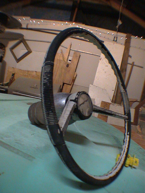

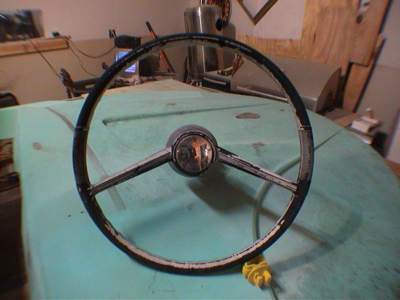

Cardboard? Humm it could have been? I cant see any traces of a material that may have been in them but I also can't believe all they were was just some glass mat. If they were cardboard this is not going to work. I will spin some oak on the lath and cut it.
Well I have everything off and have started lightly grinding the gel coat off. You ask why? I can pick it off with my finger. It's got to be re coated. Any way... Who is good at steering wheel restorations?
Mrs Spookeay Bird
Re:It's not like I have to much to do as it is. 16 years 8 months ago #1428
How about a picture or two of the steering wheel Heather? What kind is it? Eastwood sells kits to rebuild wheels, but sometimes it can be done with regular glass and fill stuff.

I am not sure frank. It has no markings. I have tried to do some wheels way back about 20 years ago and had no luck. I would like to keep as much of this boat as I can The cleats are shot. More than just pits. the pot mettle is brittle. I am going to send the bow light and handle off to see about re chroming. There were 2 switches in the dash. The Bakelite insulators were gone in them when I pulled them The Gale Dash plate is still good and the windscreen is good. So, I would like to keep the wheel but I need a pro job on it. When I take them on the lake I want people to see these boats as a representation of my work.
