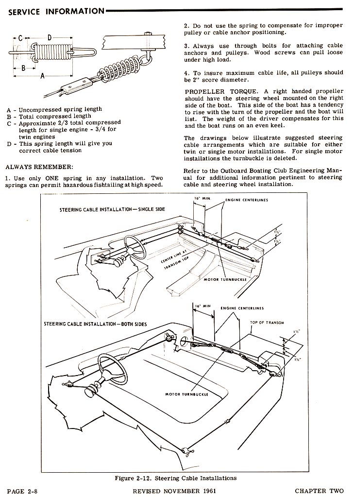

Here is a nice diagrahm a memeber posted years ago on the site. I found it really helpful, especially the part use nut and bolts not screws and tension only one spring! Mike
Thats some super helpfull instructions! I have this same steering set up in my little boat. Unfortunatly, if anything happens to it, I can't replace it. Are they still available in the states?

I had never heard anyone suggest only one spring, as in the diagram. As far as I know, all Larsons came with a spring on both sides.

The theory on the single spring is that it will prevent a high speed wobble. With two springs there is a chance that the system will go crazy at high speed and the engine will move side to side the distance that the springs allow it to move. With one it won't do that. So the theory goes. I am going to stick with one spring and not test the two spring theory. And bolt every one of the attaching points: never screws. If a screw lets loose.....well drive with on hand on the throttle lever! LOL. Mike

I noticed my Thunderhawk has screw eyes drilled in at a shallow angle into 1/2" plywood. I think some eye bolts are in my future. Not that the 1959 Lark 35HP is a wicked power machine, but I still want to be able to aim it where I want to go.
