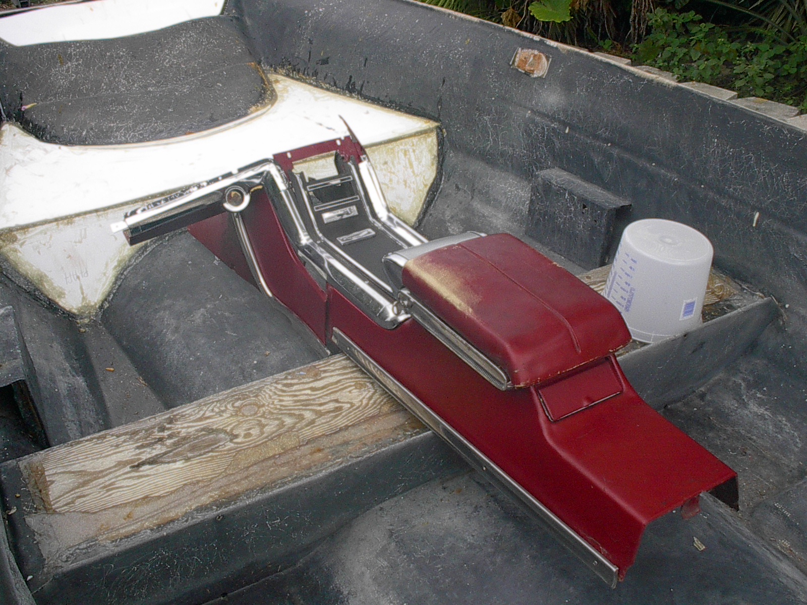

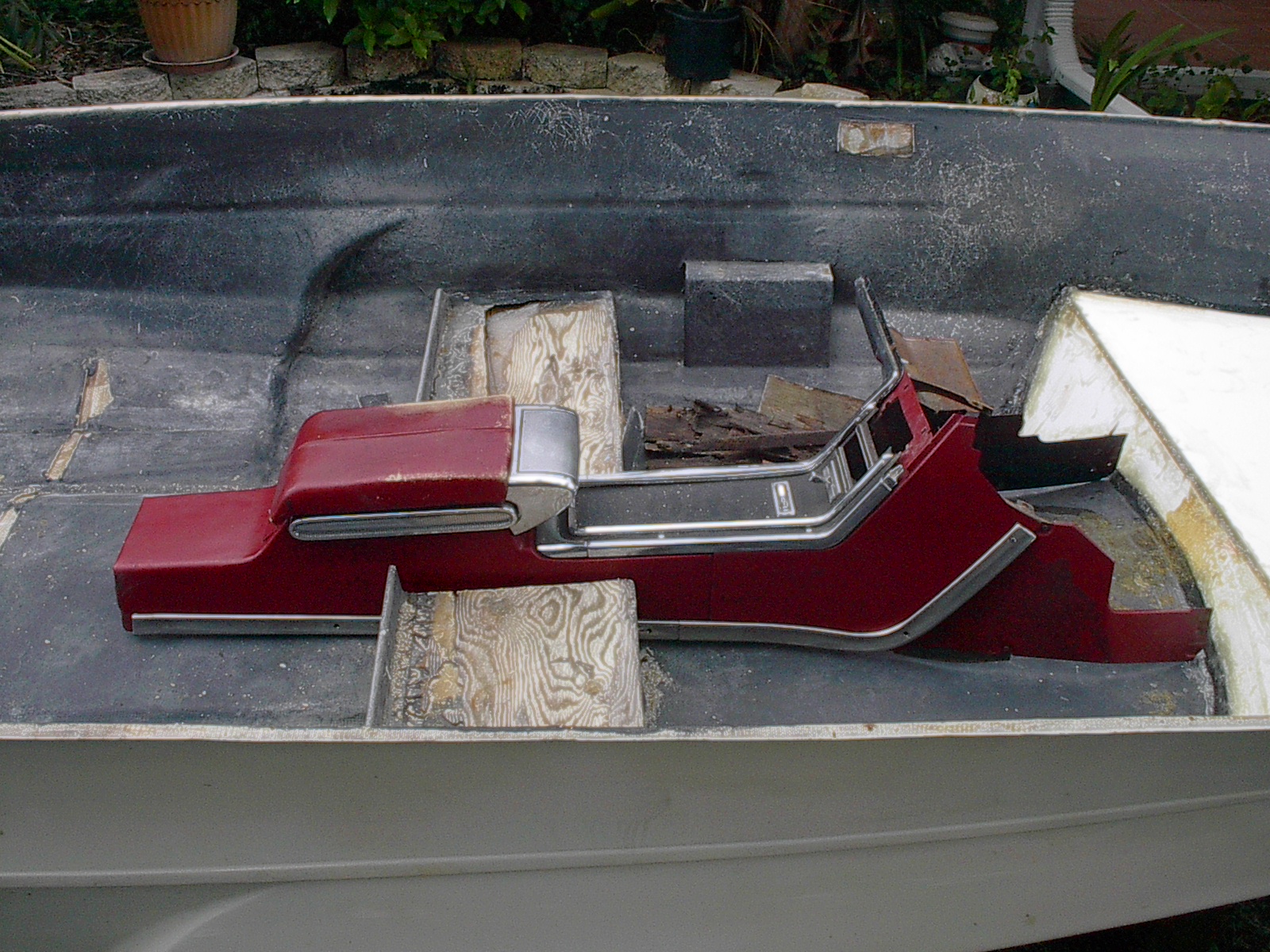

Interior parts are starting to come into play. Picked up the center console this morning. Just gittin' goin' and the rain started. Will be busy next couple days...this is the fun stuff ;)
Re:Manta Ray interior 16 years 2 months ago #13928
wow.....whered you get that? can you find another? ron
Re:Manta Ray interior 16 years 2 months ago #13930
  • Neil
  • Neil's Avatar
  • Posts: 1997
  • Karma: 65
Wow. Looks like it is out af a 60's Thunderbird.
That is going to be great.
Neil and Mary Ousnamer
Re:Manta Ray interior 16 years 2 months ago #13943
  • CAT*FIN*k
  • Posts: 620
  • Karma: 35
Good eye Neil, `64-`66 T-Bird.
Ron, picked it up on ebay $93 delivered Greyhound. It's in good shape, all metal except the padded lid (w/key). Will need to repaint to color match. The Manta dash is to small for the whole dash but will use most of the T-Bird dash also. Not a T-Bird fan but feel the style will make the interior as unique as the hull.

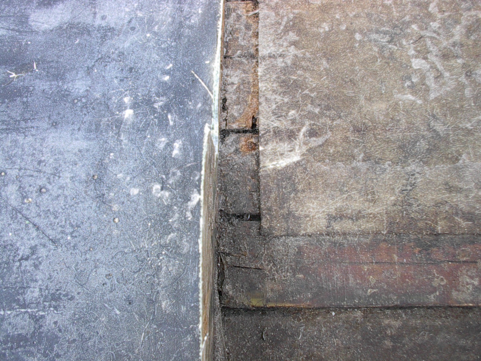

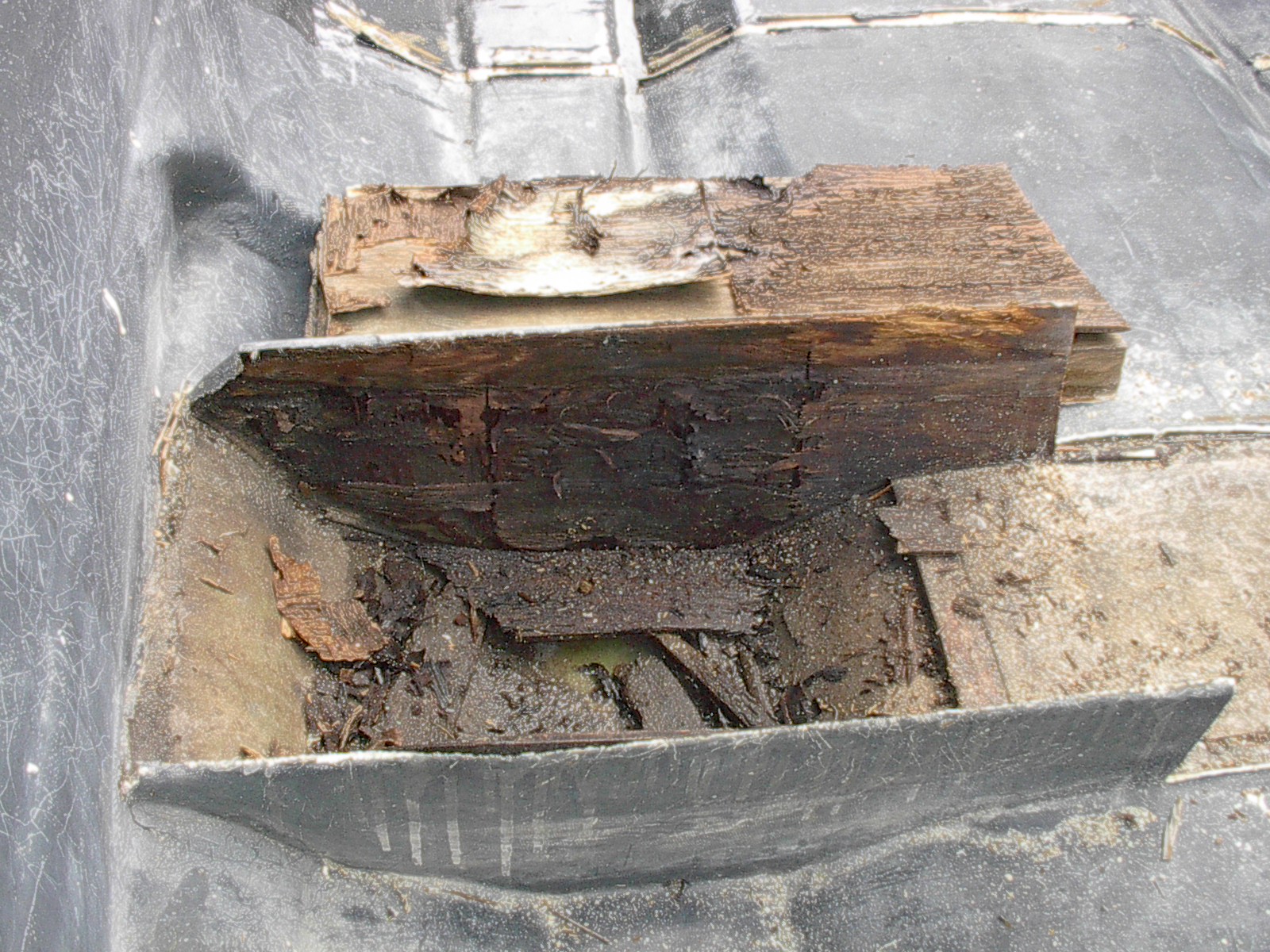

Ran into a major snag today. I expected a mess when I removed the old seat and some repairs from the accedent
...but not this... :S
plywood slats
Re:Manta Ray interior 16 years 2 months ago #13982
just take them out and glass over the top.if they extend to the rear but the hulls not soft, don't worry about it.

Looks like the strips start at the transom forward to the seat base front. I'm cool with replacing, just a time thing. We need to get up to MI for a few weeks then down to Brazil. Have some muscle coming over Sunday to help test fit the deck on the hull. I was really lookin' forward to gettin' the interior set up before puttin' in storage. I can take a box of small parts on the road to work on.

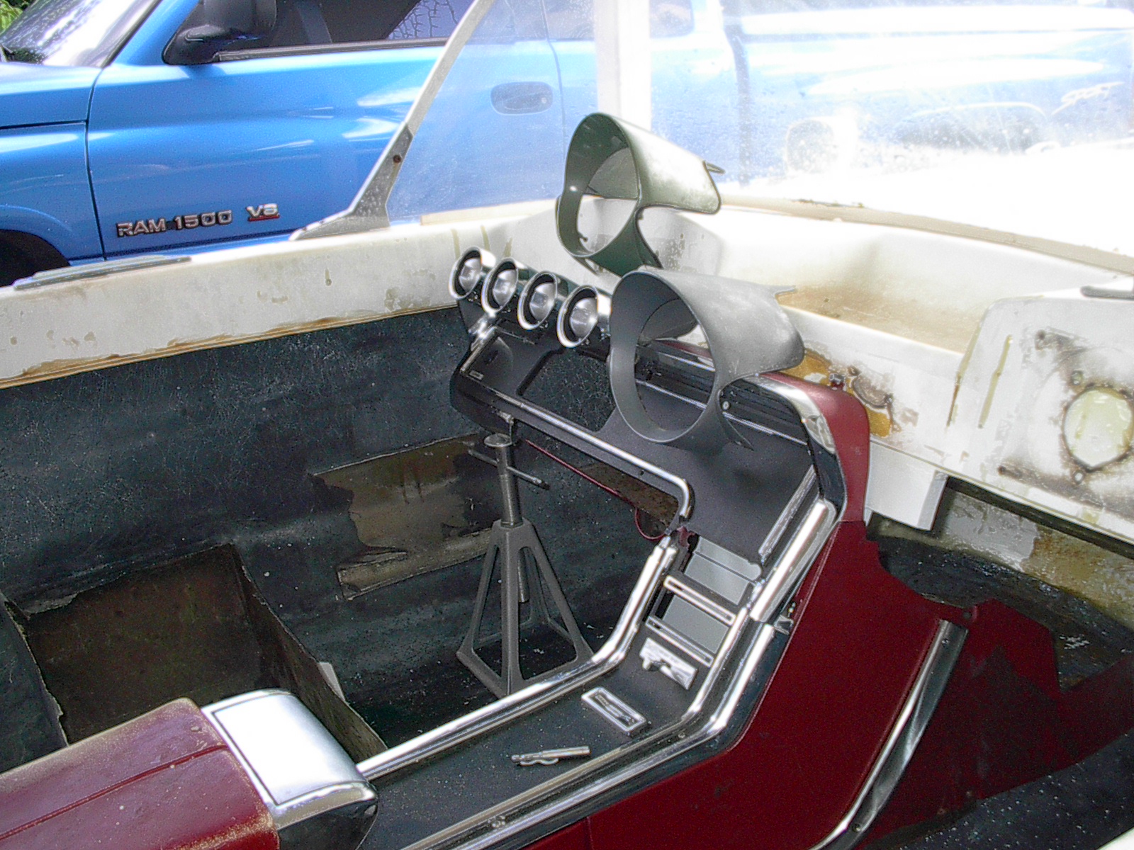

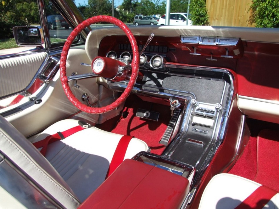

It can save a lot of time by using parts from other sources. This console/dash fit the space very well but will need to work out the small touches. This is a pic of the dash & console style I have.
I'll be using from the 4 gauge pods down. The tach & speedo should fit in `59/`60 Chevy Impala pods molded in above. The light switch will be an easy re-use...parking light will be stern light...headlight will be bow light...rotate for dash lights...interior light at the end. Ignition is really easy. The first switch working up the console is an ON-OFF-ON rocker for door locks, engraved "DOOR LOCKS". I figger this would make a good manual bilge pump switch for port & stbd pumps. To finish it off it will also need to be re-labeled. If anyone is interested, I'm taking pics of all for documentation on the build, I can post pics and explain how I do it. Some don't care about these small details but I really get into it. Just tried to replace the oil gauge with a compass. Found one that fit perfect but the spring clips in the basel had a slight magnetic field...compass only point west when installed...plan B find a 2nd fuel gauge and put a sender in each tank...plan C use a hour meter...

A quick question, are you saying the wood slats are sandwiched between glass layers from front to back the length of the floor? Sounds like a ton of work to replace all that!
Re:Manta Ray interior 16 years 2 months ago #14014
jim, i think its only the top of the tunnel. i think it had something to do with forming the mold. i doubt it adds much strength since they're so thin, but i could be wrong. mine might be the same but my tunnel is hard as a rock. i jumped up and down on it with no flex whatsoever. ron

I dont want to leave the slats in place...a lil like sweepin' dirt under the rug. They may also be there to re-inforce the seam down the center & keep the keels from spreading and running true. The tunnel seems solid to walk on but then thats not running cross sea with 4 people on board. Should be fairly easy to remove. I'll use a circular saw, set the blade for 5/16" depth and cut the area up like a pan of brownies.

The tunnel build up on this one starting with the finish layer then a layer a matt, a layer on heavy cloth. The cloth is full length and seamed in the center. The seam was done by folding the 2 edges together, like folding together the top of a paper bag. I found it when I opened the bow storage deck where it was exposed. I filled the gap on the one side with epoxy and epoxied 2 layers of matt over that. From the bow to the front seat it is covered with the black poly resin where it could be seen. Under the front seat back there is then a layer of matt, then 1/4" plywood slats, a layer of matt, a layer of heavy cloth, coated with black poly resin.

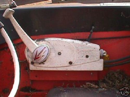

john, i can't see how the remote would work in the console because of the long forward throw. i would think the front of the console would have to be completely removed to allow the remote handle to pass.

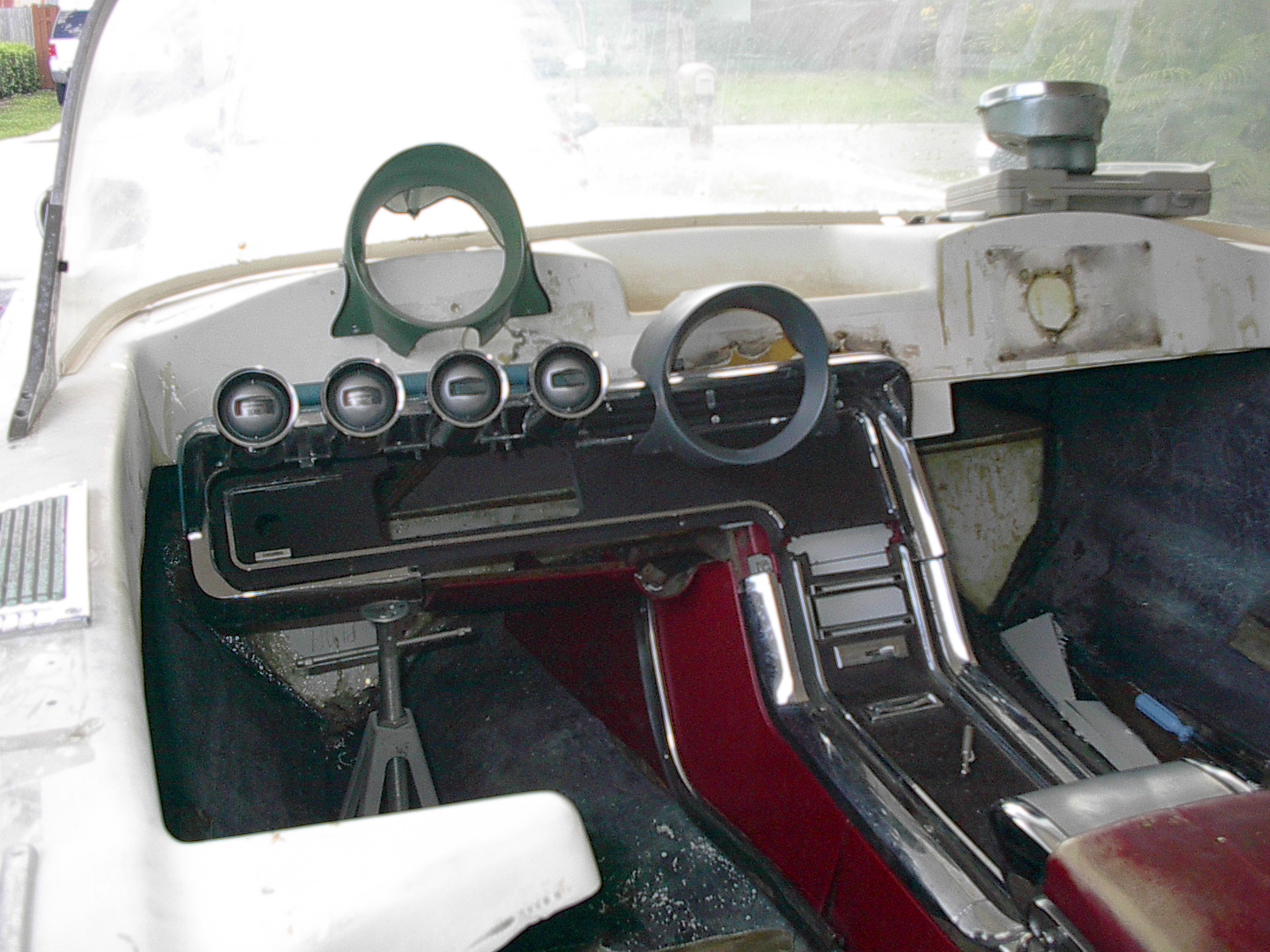

Got back on track with the interior. Will need to wait for seats but looks like I'll need to raise things a couple inches.
Re:Manta Ray interior 16 years 1 month ago #14819
  • Neil
  • Neil's Avatar
  • Posts: 1997
  • Karma: 65
It looks like it is going to fit pretty darn good.

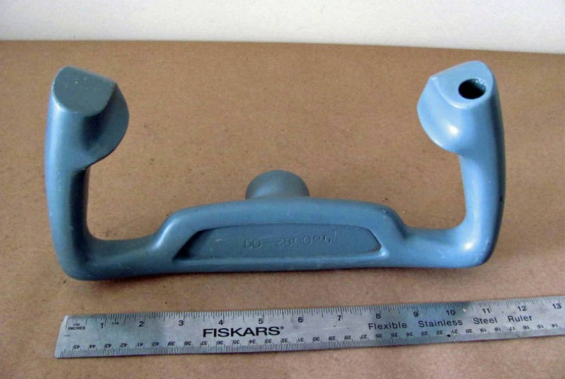

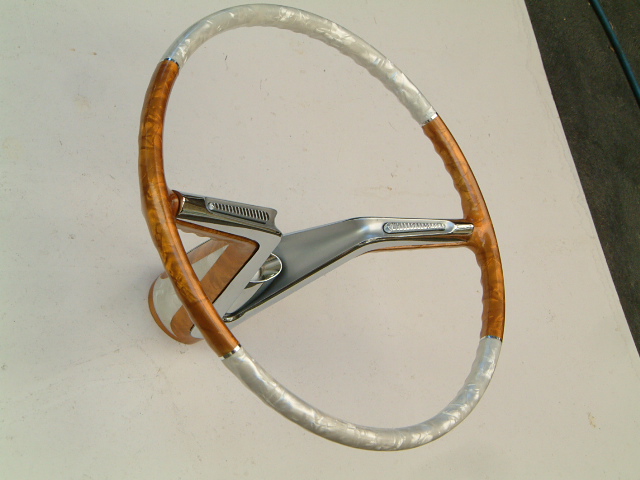

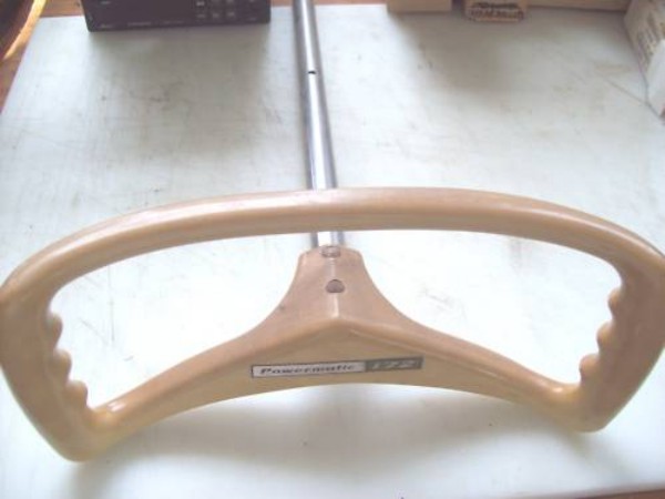

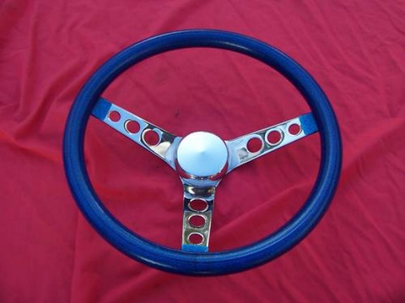

The T-Bird had swing steering, I've been lookin' at tilt helms, need to clear the gauges. Not sure on the steering wheel yet. I have this Moon Eyes blue metalflake.
This Impy would look nice but is pricey.
Have started looking at tryn' one of these.

Re:Manta Ray interior 16 years 1 month ago #14840
HOLY MOLY.......NEAT!
Re:Manta Ray interior 16 years 1 month ago #14843
  • Neil
  • Neil's Avatar
  • Posts: 1997
  • Karma: 65
The bottom wheel gets my vote.
The styling goes with the rest of the dash and the console.
As far as the price, well, you only have to buy it once, right?
Whatever your choice, I am sure it will look great.
