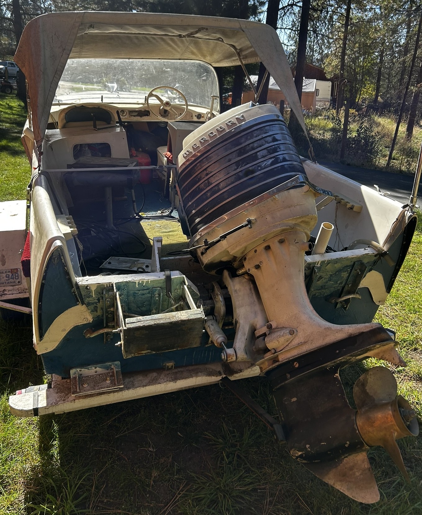

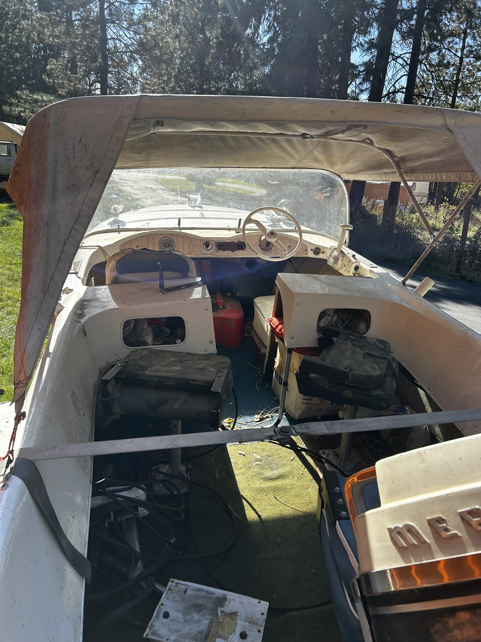

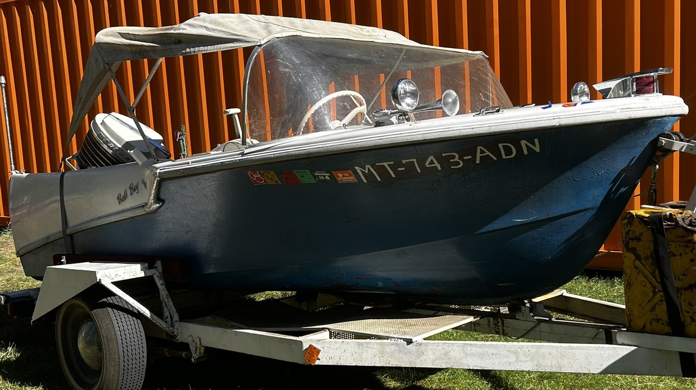

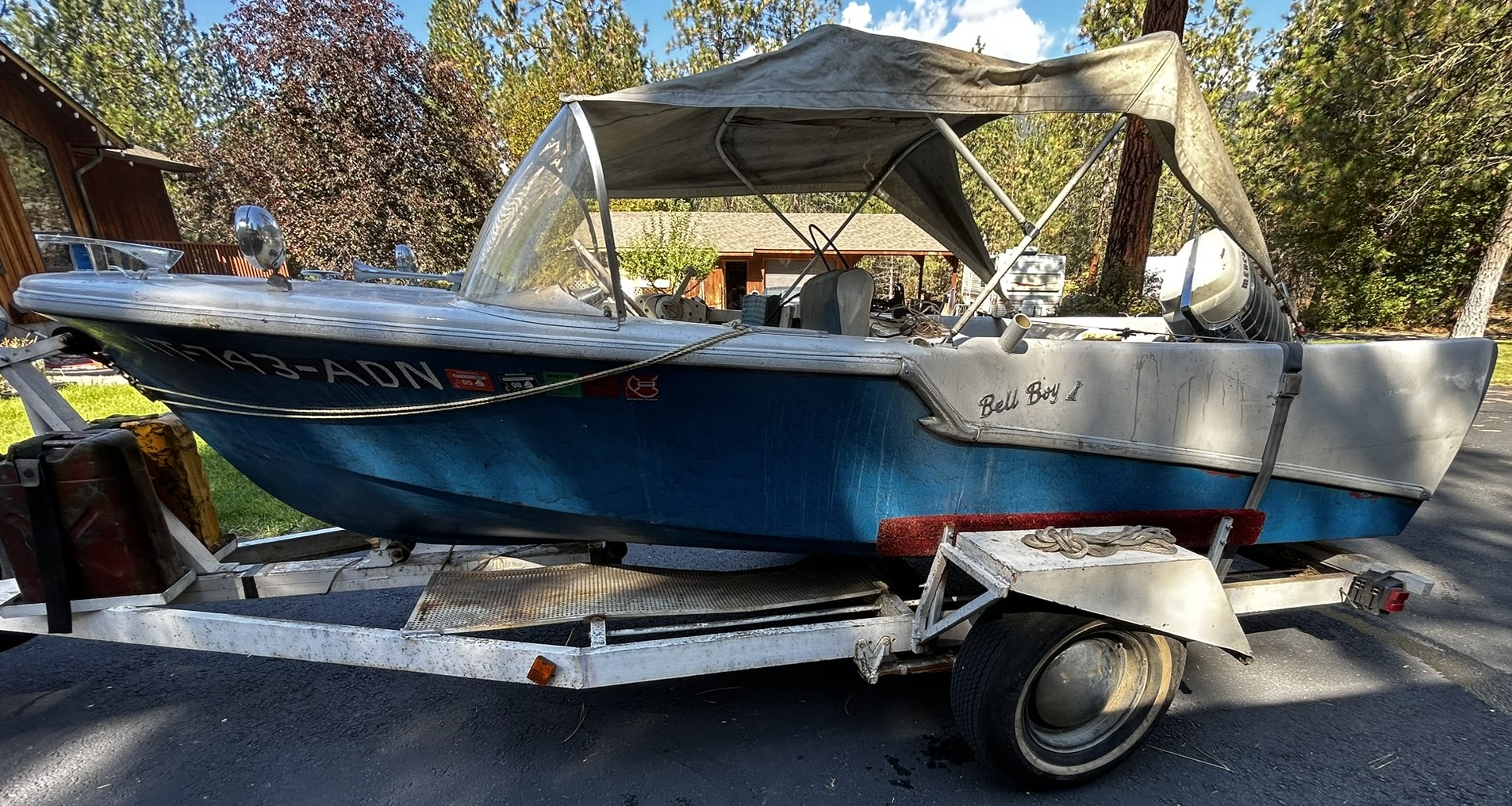

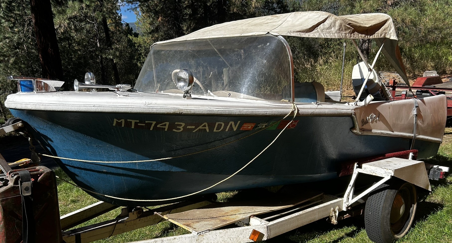

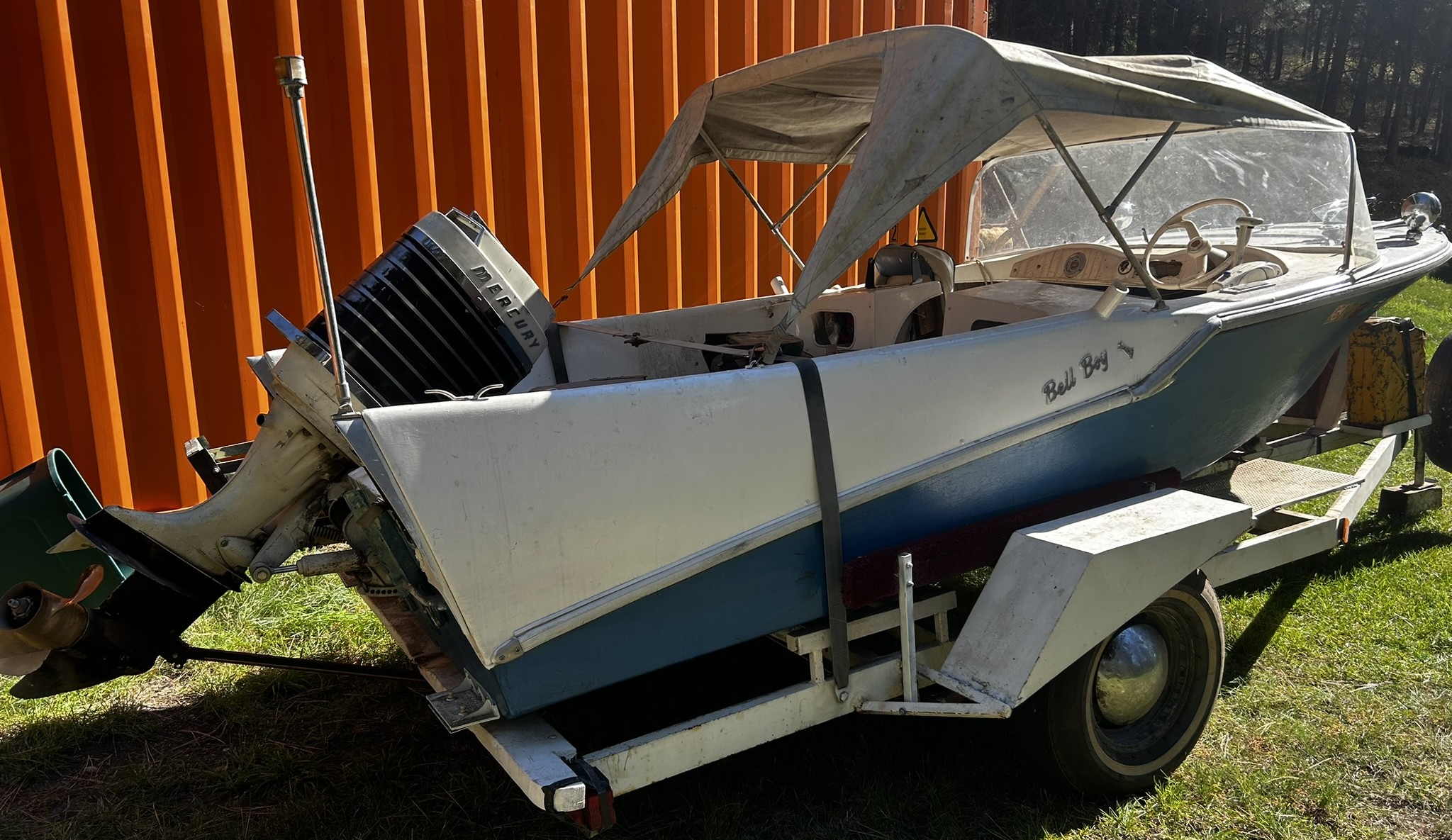

Greetings all. I just signed up because this old gal followed me home Sunday. She's a 1958 Bell Boy, I believe Banshee(?). It was one of those deals where I got her home and can't really say it was a good idea. I already have too many projects!
But, I figure if I do decide to dig in then this might be a forum where I can get good information.
There is a Mercury 6cyl Tower of Power on her right now, but I'm pretty sure she originally had a Scott Atwater because I found a full set of controls for one buried under the seats.
This isn't my first rodeo, my first boat was a '57 Leecraft with fins like a '57 Chevy. That asthetic is really the only reason I brought this one home. :)

Is that an "800" Dockbuster, or a "700"? Can't see the face plate, but it looks like the 800 with larger cowlings etc.

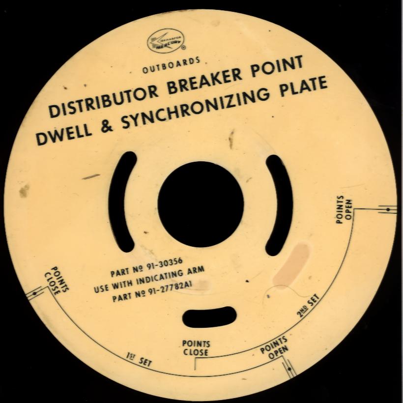

Pull the distributor, clean the points to bare metal and polish with crocus cloth. Then find a manual that shows you how to set up the dual-point distributor. If you get the dwell perfect, and get the carbs tweaked in, she'll fire right up and purr. Copy of dwell plate attached. Print it out, cut it to size, make a pointer to fasten to the rotor shaft, and away you go.

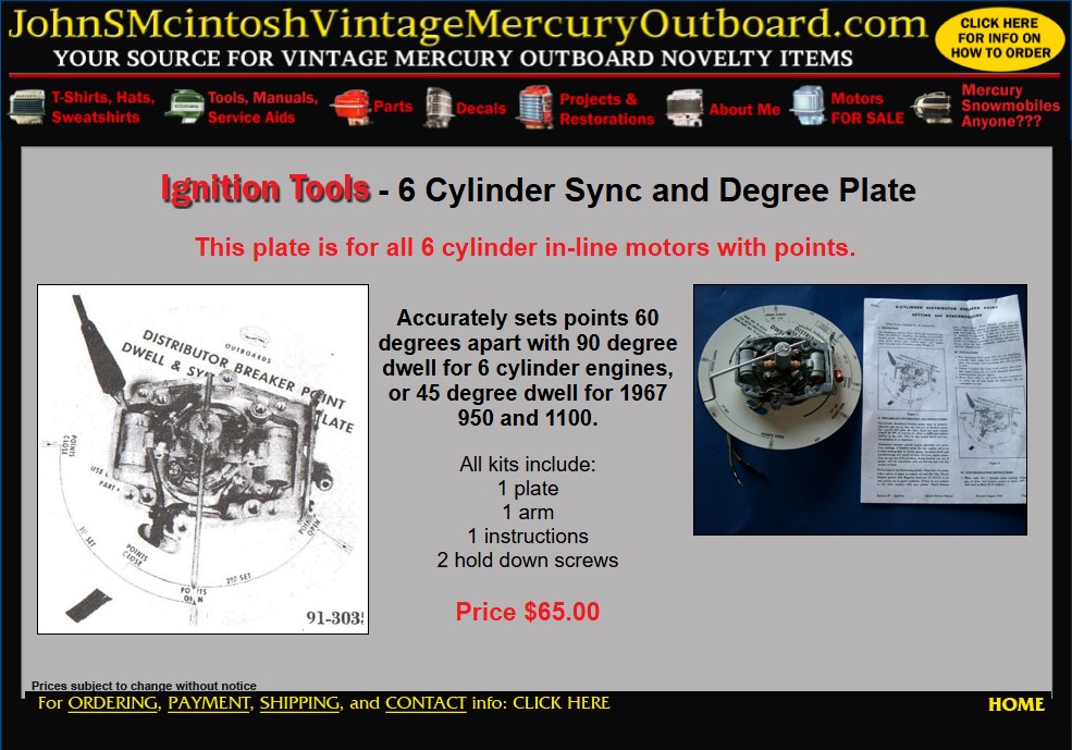

Hello Ed
Thanks for the great information on the old Merc "Tower of Power"
John McIntintosh makes the dwell indicators.
johnsmcintoshvintagemercuryoutboard.com/6CylDegreePlate.html

That's a Sweet setup. Good as the factory tool.
Years ago I just happened to pick up a mess of parts and some very nice home-made dwell plates came with. So I used the best one of those, and made my own pointer out of an old rotor, a screw, and hunk of stiff wire. Of course those rotors cost an arm-and-a-leg nowadays, if you can find one!!
Far as special tools go, it's definitely worth the investment. You really need to get that dwell set properly, since we're dealing with 2 separate ignition systems. If one is off from the other, it sets up bad power pulses which can harm the engine's internals. Or just make it run poorly.
These old dual-ign Sixes really do run nice when you get the ign and carburation well-adjusted.
