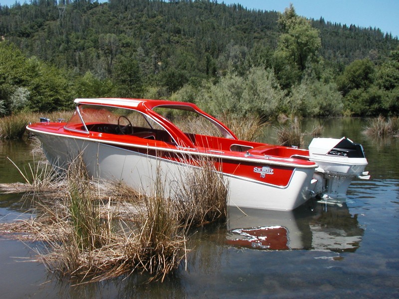

It all depends on what you personally think looks good or not. For me, Penetrol is a no - go. There is only one way to revive gelcoat, and there are no shortcuts. I use a special rubbing compound from starbrite that is amazing. It breaks down as you are using it, so the polinshing compounds get smaller & smaller, leaving a nice sheen to the gelcoat. Just do small sections at a time, that way is not so painful. After this, wax the boat with Carnuba paste wax. To maintain the color & sheen is a little more interesting. Keep the boat covered & out of the weather (especially the sun) Don't use any sort of detergent or soap on the boat, just water & towel it off. Detergents & soaps will strip the oils from the gelcoat & it will go dull. My special secret is to wipe any light bodied oil all over the boat before putting it away. An old timer showed this to me & regardless of what you might think, it WORKS. Wipe a light film of oil on & leave it on, don't remove it. It will be important to then cover the boat, because if you don't insects & dust will make a mess out of it. When you want to use the boat, get a can of WD 40 & lightly mist a small area, then buff it off dry with a clean rag. Do this to the whole boat before taking it out. This step is necessary to soften & remove the excess oil that was left on the boat when you put it away. You will be impressed with the result & this will greatly reduce the need to buff the gelcoat. Remember that our boats are plastic, and what does plastic start out as? OIL.
Here is a pic of my Skagit that I have maintained in this way. The boat has its original gelcoat, which was badly oxidized and pink when I got it. And no, you can't skip the rubbing compound & waxing, because if you do, this process won't do you any good. This is to maintain the shine that you get from all that hard work.
