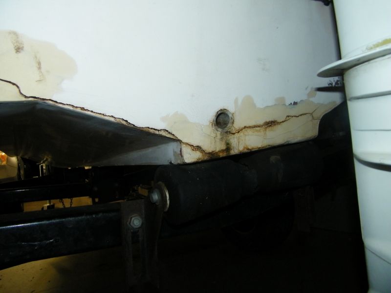

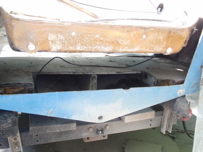

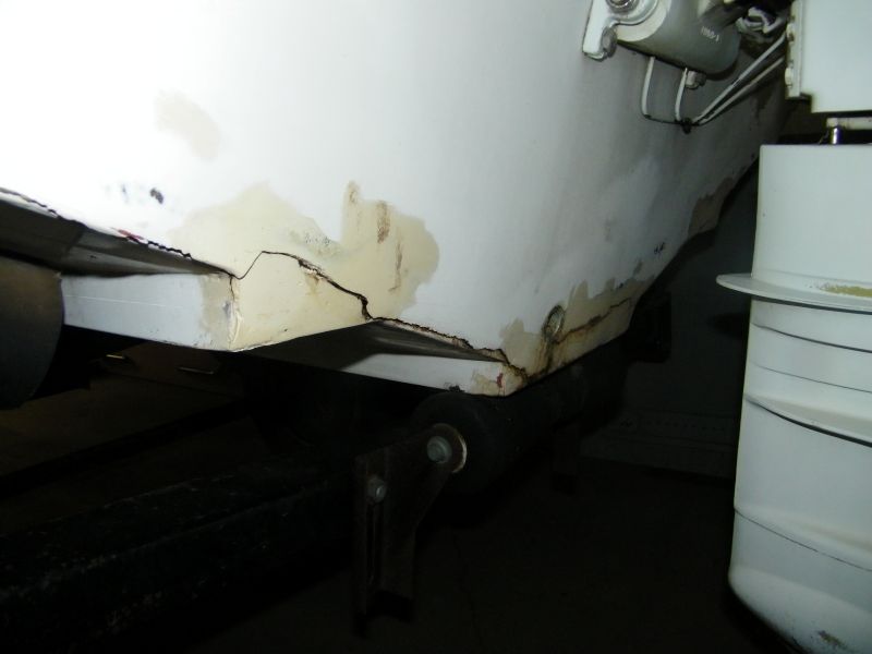

I have done two transoms from the top down chipping out the rotted stuff. The corners and edges were problematic though. I'm going to begin cutting from the inside with a multitool to see how much damage is really there. I've never seen a transom damaged like this one. Usually they are cracked on top by the motor well and flex with the motor. This one is quite different and looks more to me like over the years ice might have forced the transom away from the hull. There is no flex on the transom when I try to lift or shift the motor. There is/was no bilge pump in the boat and no signs of one ever being in there, holes, wires, switch, etc. Here's a pic and give me your opin. Either way it will be a relaxing job laying down and doing some "explority" surgery. Also A pic of the one I cut open from the outside. The wood literally fell out as I opened it up.
