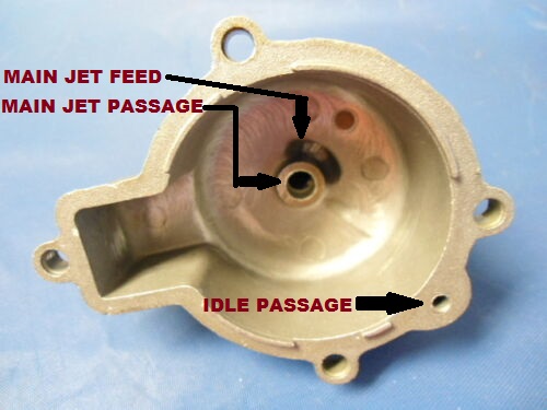

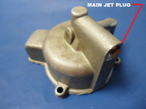

The main jet is in the bottom of the float bowl, where you'll find a brass hex-head (maybe slotted) plug on the outside of the float bowl, screwed into the bowl and sealed by a fiber washer.
There's an opening cast into the bottom of the float bowl that gravity-feeds fuel to the "intake" side of the main jet; fuel flows thru the jet to the center of the chamber that seals against the carburetor via the "boss" gasket, and thru which fuel is drawn up the emulsion tube and into the carburetor.
Note that there are holes drilled in the sides of the emulsion tube and when you do a carb rebuild you need to unscrew the tube and make sure the tube is clean and clear.
See the attached pics of a generic 379965 float "chamber" aka "bowl. You'll see in one pic the main jet cover hole. Also the passage that goes to the main jet, so you can get your screwdriver on it for removal.

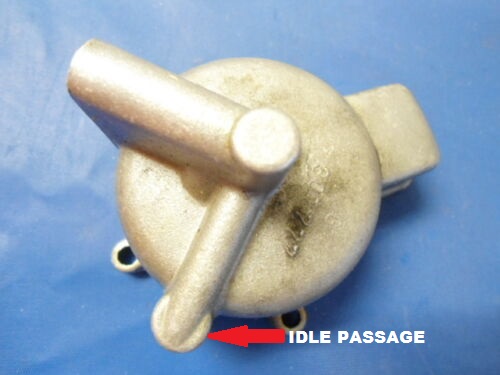

Note the other passage that's at 90 degrees to the front of the carb, that's where the idle fuel is pulled up the side of the carb, thru the punched hole in the float bowl gasket, and up into the idle circuit.
I've seen this hole all squeezed-off from age/deterioration, such that it blocked any fuel from going up into the idle circuit. So it wouldn't idle. A new gasket fixed it right up! So check that gasket if it's used.
On the pic showing the inside of the bowl, see the small idle passage in the one side of the chamber wall. Also note the opening in the floor of the bowl, the fuel feed to the main jet.
This all has to be clean and clear or you'll have fuel supply issues. It may run above idle, but not get fuel to the idle circuit.

Mystery solved! The end of last season I replaced the float bowl gasket. The gasket matched the original except for sealing the low speed passage. The gasket fit around the outside of the passage but was open to the inside. This left suction for the low speed circuit to draw from the top of the fuel level (air) instead of drawing fuel from the bottom of the bowl. Put in the correct gasket, she's running as smooth as silk!
