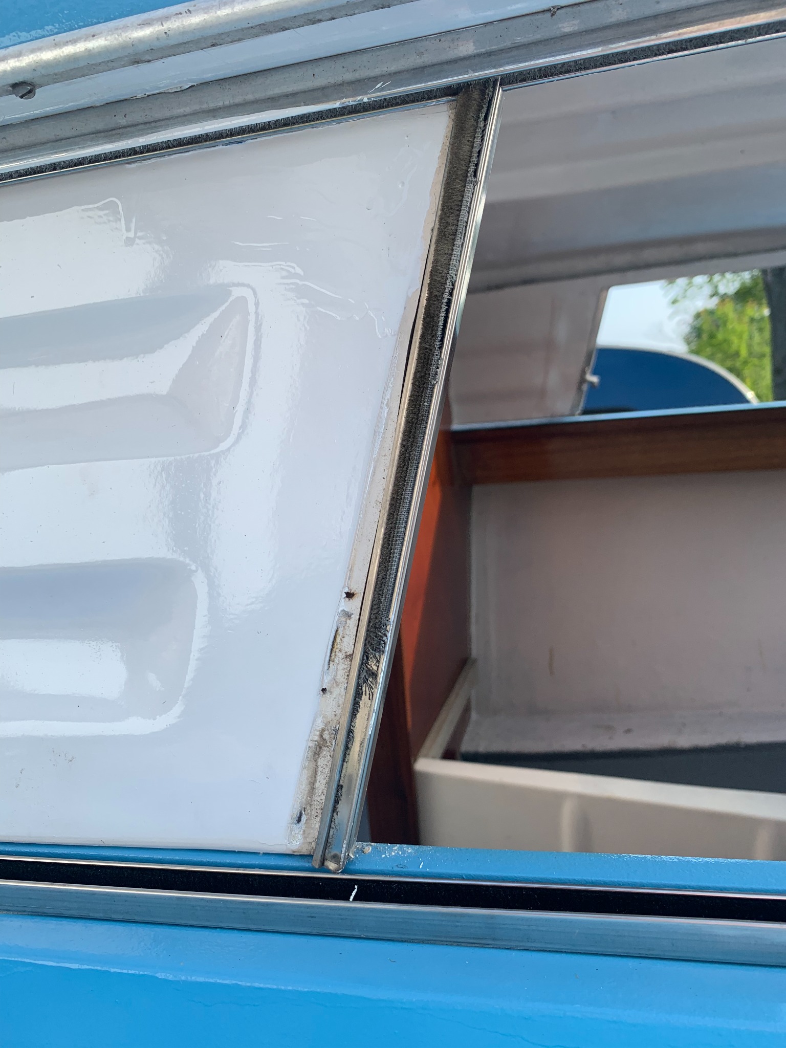

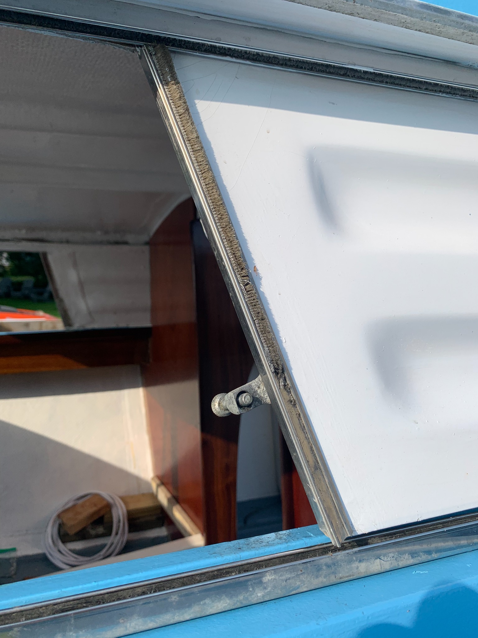

Working on my Glasspar Seafair, trying to put the windows and hardware together. This piece goes behind the sliding side cabin windows. The felt is worn and degrading. doesn't look like there is a way to slide in new felt. Is replacement trim like this available?

Don't know why those photos turned sideways and I can't figure out how to turn them, but you get the idea.

I wonder if an automotive repair shop or a common glass replacement business would know a source if shown a sample??
I turned your pictures for you. Hopefully I turned them the right way! Hee-hee-hee

Thanks Dr.F, for the suggestion and for fixing the photos.
