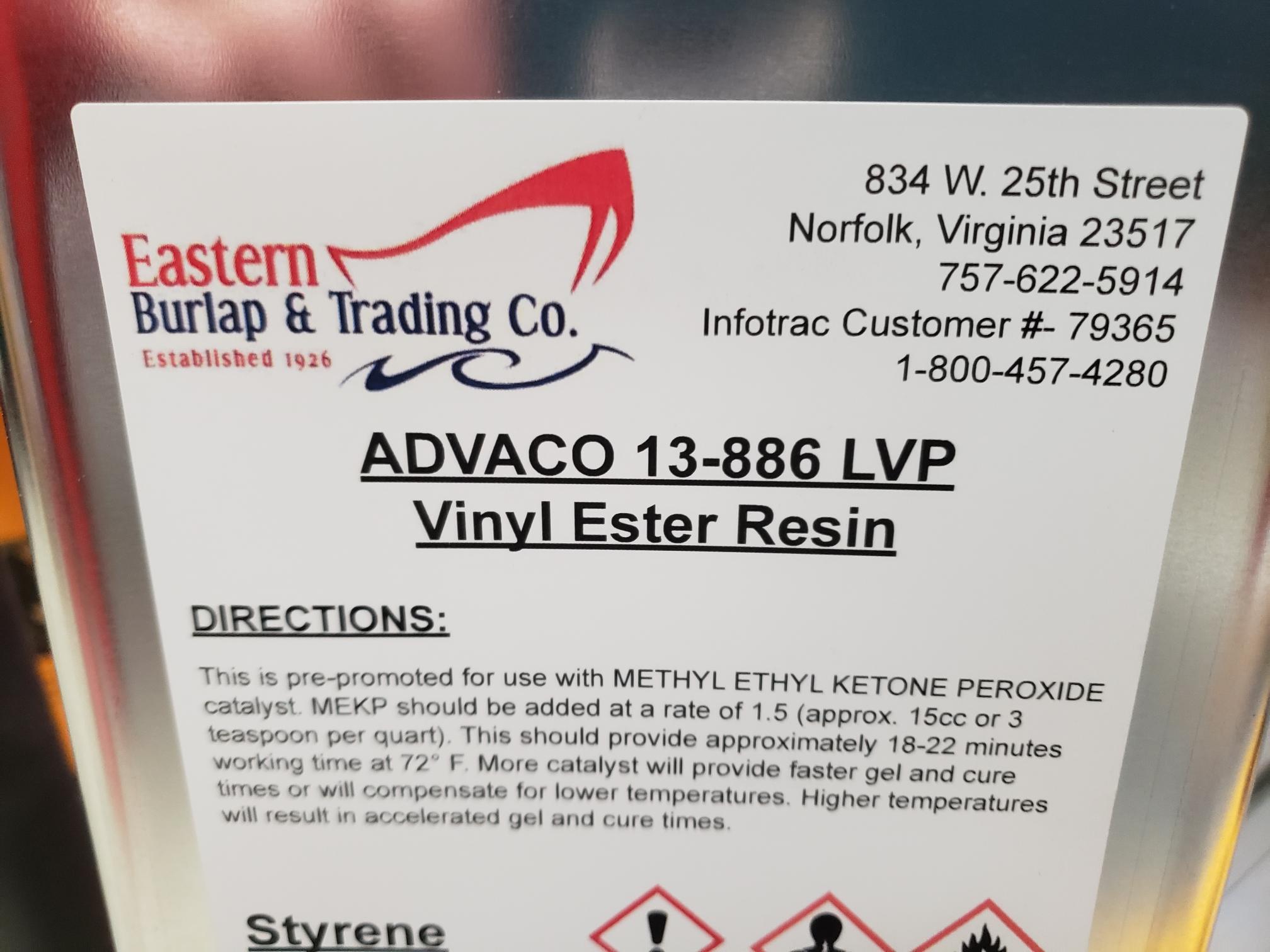

On the custom craft, I wanted to try Coosa board for the transom, stringers and floor. My local supplier delivered the large boards free and suggested I look at vinyl ester as it would be more flexible and more water resistant than poly. They also offered our ACBS chapter a small discount and again delivered the resin for free. Pic attached. It worked great to laminate the 1708 to the coosa. However, I did use epoxy when running my floor to hull transition tab mixing it with short glass fibers and cabosil to make up the thicker "peanut butter". This was to make sure the tab would adhere to the original hull material which is an unknown.
