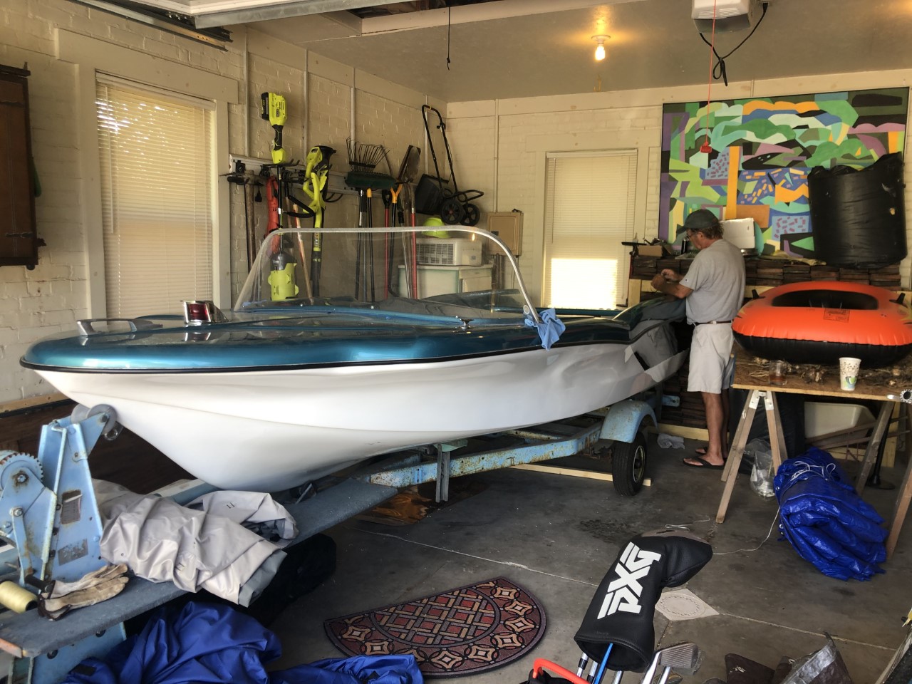

Attached if a photo of where the project stands as of today. The 1961 50Hp Merc is in process of being rebuilt. The bench seats are at the upholstery shop. The boat stands will be here soon and the hull comes off the trailer and the trailer goes to the sandblaster..
I hope to have the maiden voyage Memorial Day!!!!

And thats a cool looking little boat ya got there!
cable steering VS teleflex 3 years 6 months ago #147750
The boat looks great!
