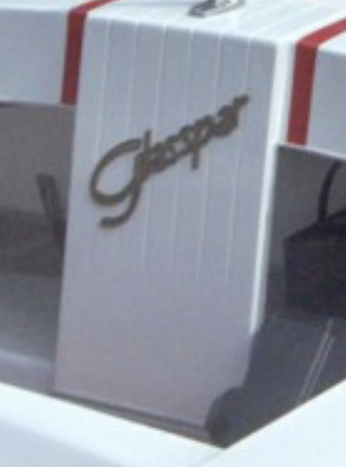

So, I broke my Glasspar signature plate that lives as pictured. Any suggestions as to how to fix it appreciated .

here is a short video on pot metal repair. Looks simple enough ?
www.muggyweld.com/video/pot-metal-boat-emblem-repair/
To go one step further.... I've done stained glass soldering before, and it can be a pain in the @ss to keep the pieces together while soldering because bumping the piece with the solder rod or torch or solder iron, the pieces will move and when the solder hardens everything is out of place and looks like sh*t.
So the trick is to get a drop ceiling panel, piece of dry wall or somethng that you use that holds thumb tack or push pins.
Put your piece on the panel, hold it place with push pins around your emblem so it doesn't move while doing your repair.
hope this helps ?
