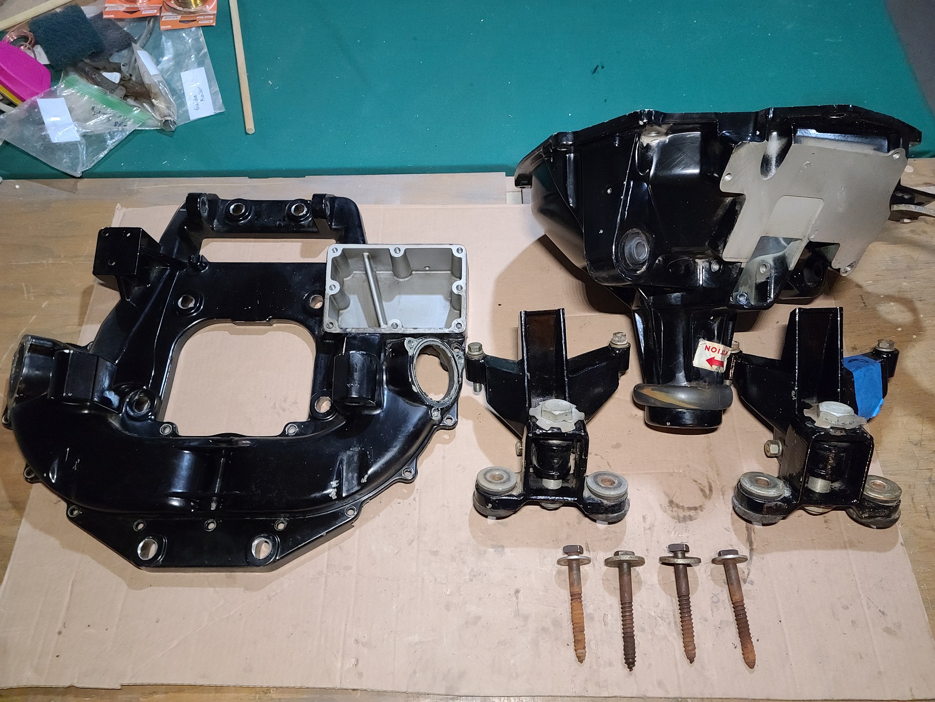

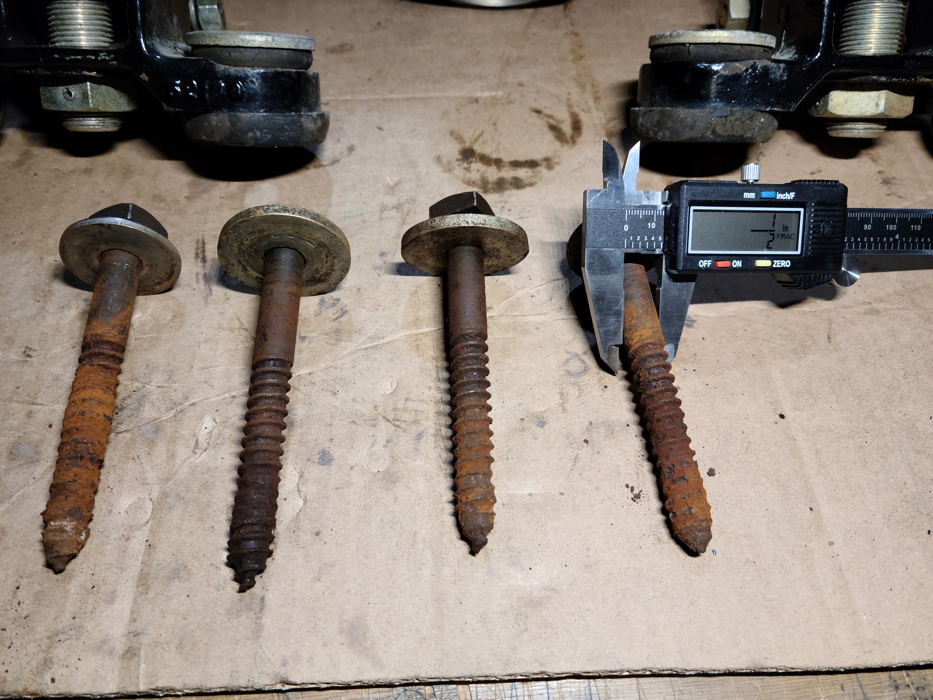

Jim, thanks for the explanation of the Mercruiser mount function. My 215E is configured as you describe, with the clutch bellhousing bolted directly to the transom plate.
The front mounts bolted the block of the engine use these 1/2" lag bolts that go through the mount, and a 2 x 4 before tying into the stringer. Perhaps 1" to 1 1/2" of the screw actually penetrated the stringer.

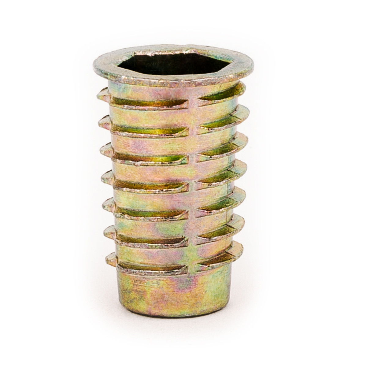

I'm considering trying to source a 1/2 inch brass threaded inserts like those supplied by E-Z Lok. (3/8 inch largest I've sound so far)
Would drill the original mount holes larger, fill with epoxy, bore/tap and install insert.

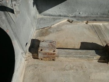

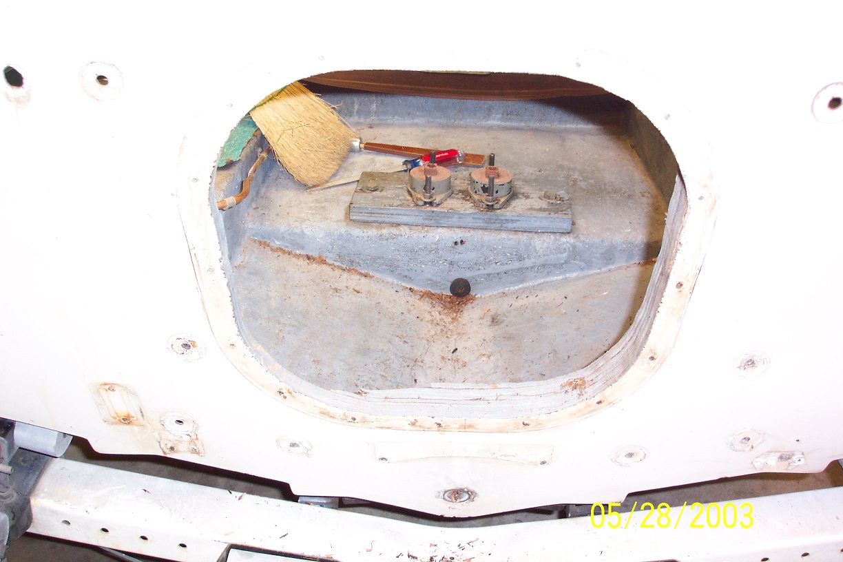

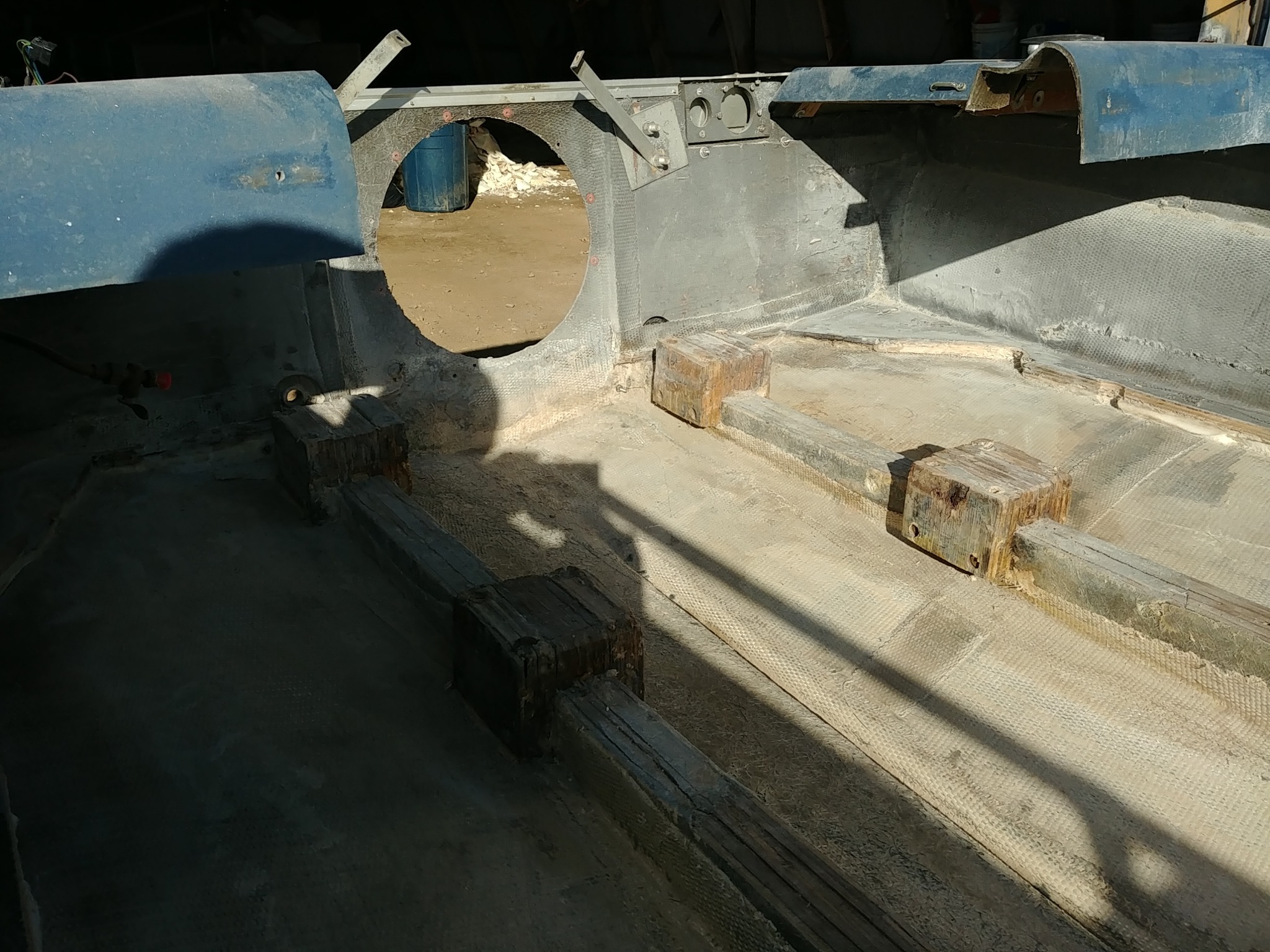

Like I said in last post, my Evinrude has floor mounts. Original design was a hocus picus plywood block design with horizontal steel rod running laterally drilled & threaded for 3/8 x 16 bolts. Wood was rotten & steel rod & bolts were steel, not stainless. Rebuild used 6" of pine stringer & 3/8 stainless lags. Here are pictures...of original mounts with floor removed
The following user(s) said Thank You: Larsspar

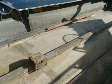

Inboard/Inboard Outboard engine mounts 3 years 8 months ago #147637
New stringer & mount build up....

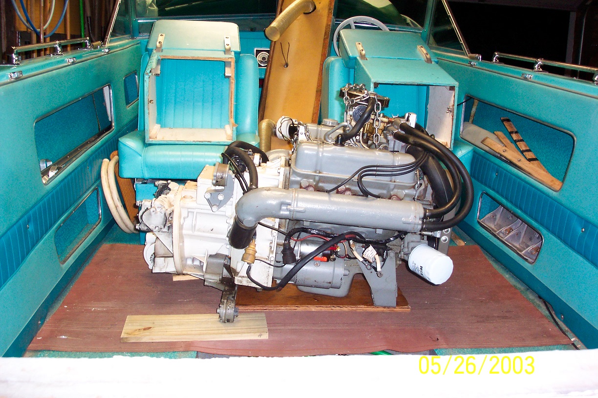

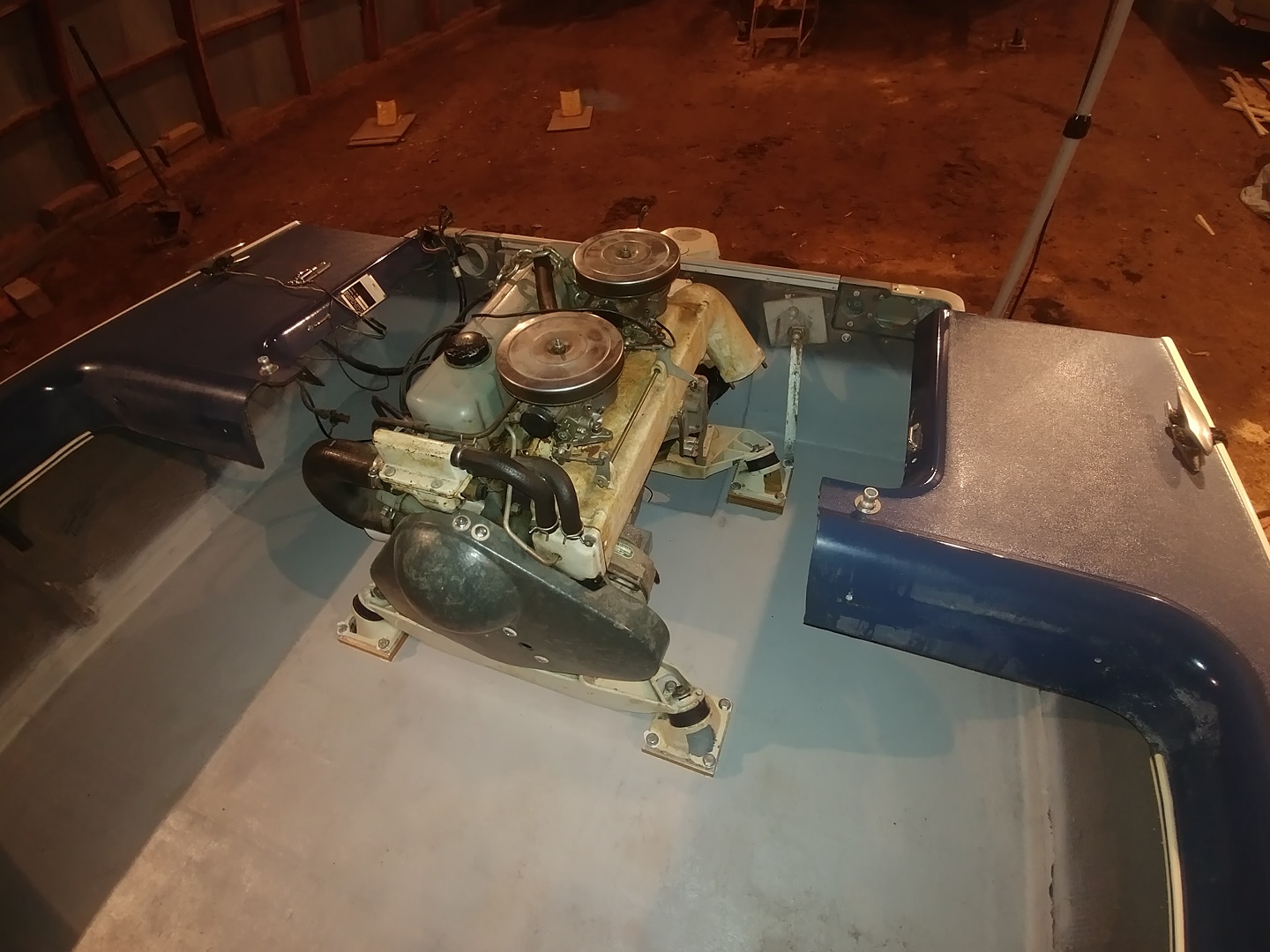

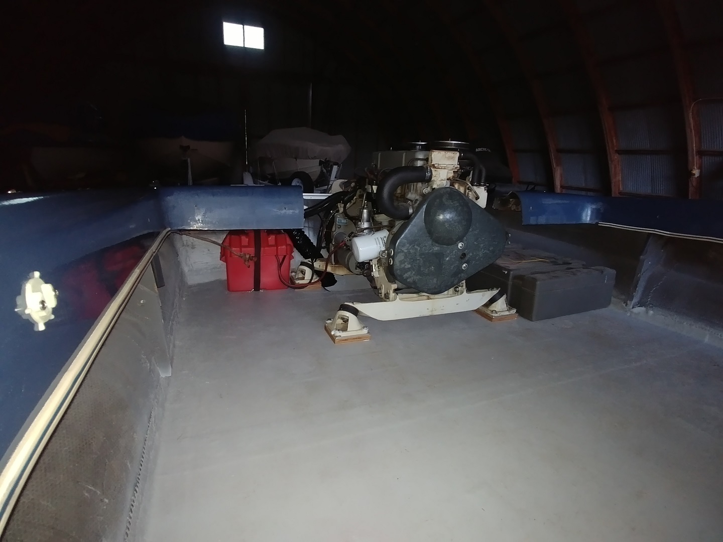

Engine install, flat floor with spacer blocks vs built up stringers protruding thru 6" holes in floor boards

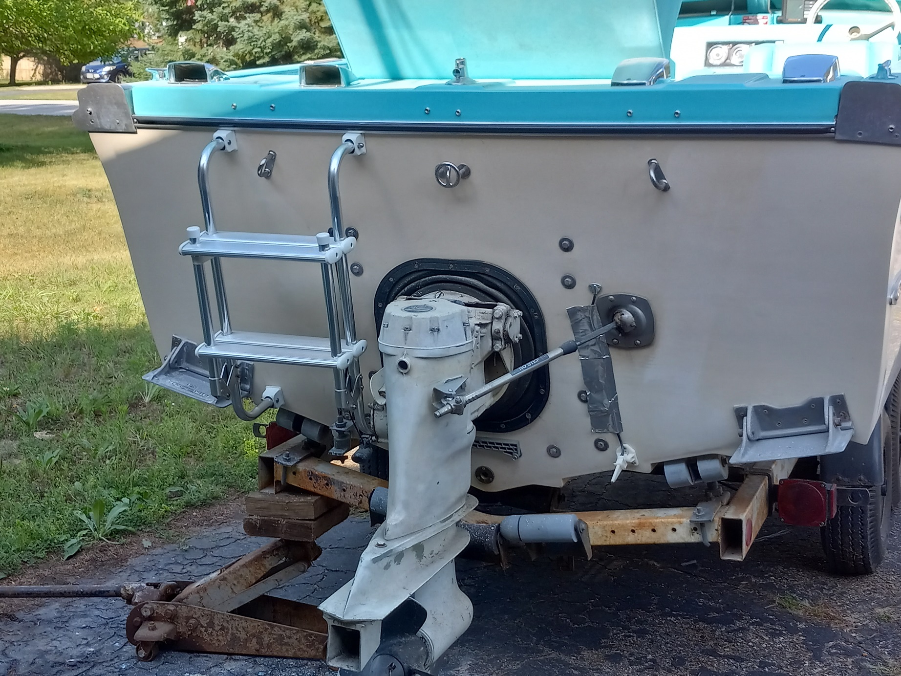

View from outside as I was installing ladder last summer. 2 vertical bolts at each upper mount & 3 in a 90 degree pattern for lower mount.

1st, most people believe OMC stringers are all mounted to the stringers & that isn't so. In the case of transom mount engines, the transom was laminated with 1 1/2" of plywood core. The engine & drive torque is transferred to the transom.
2nd, on floor mount engines, the transom technically needs no core except for the tie down/ski tow areas. OMC used one sheet of 1/2 ply. Engine & drive torque if transferred to the floor. I used 16ea 3/8 stainless lag bolts in my rebuild.
