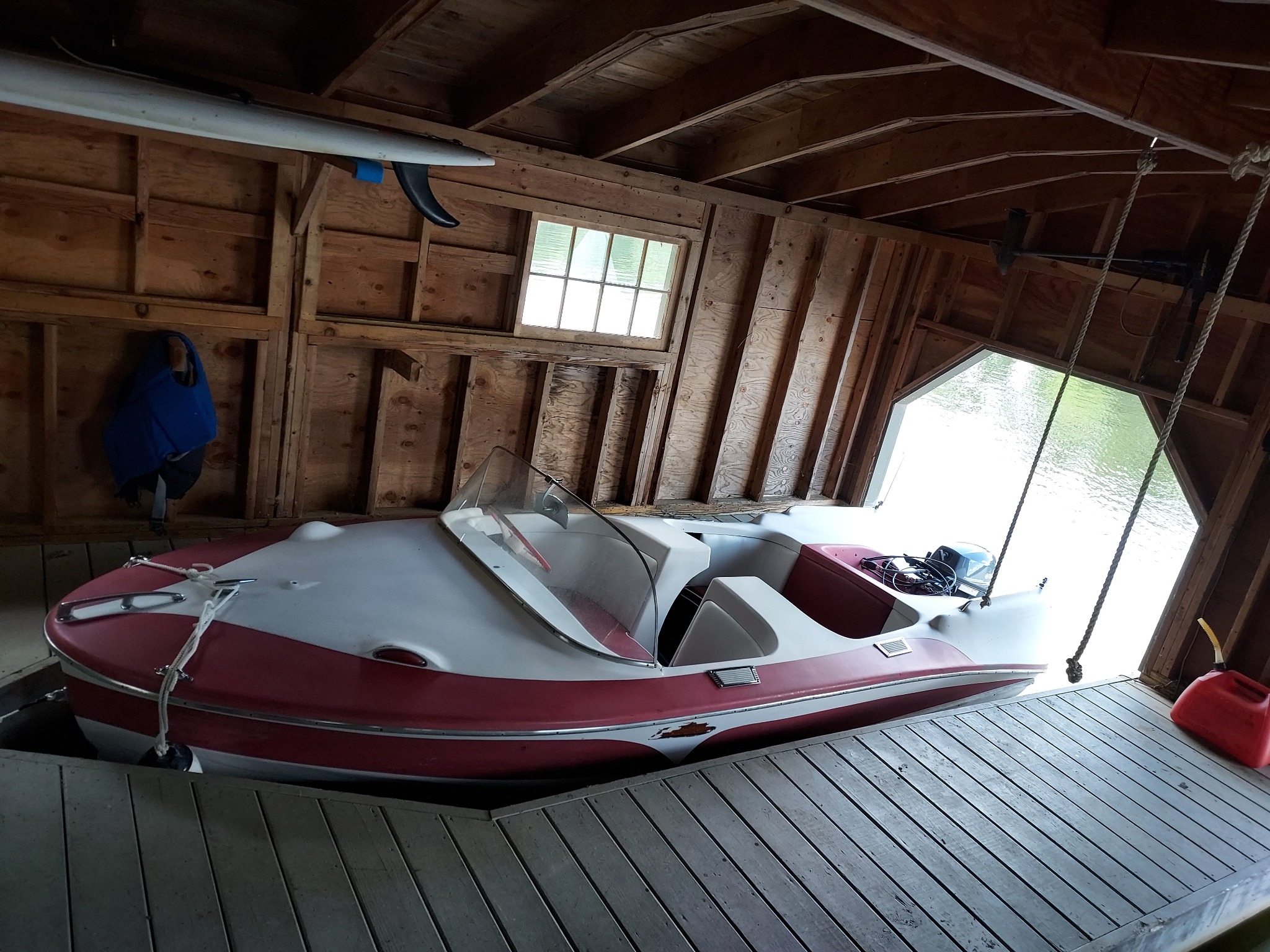

I have a 1958 Larson ThunderHawk Jr. I installed a new Yamaha 8HP motor. (Lake restriction...) The motor shakes/vibrates the boat aweful at any powere setting above idle. My thought is to install a rubber transom "sheath" upon which I would re-install the motor.
Is there a prefered gauge/thickness/material for such an application?
NJ5O

No. The hull of the larson is quite thin. It's a mechanical energy/resonance thing. I can't imagine this is a unique issue. Hoping for a McGuiver type solution to dampen the motor's vibration thruout the hull.

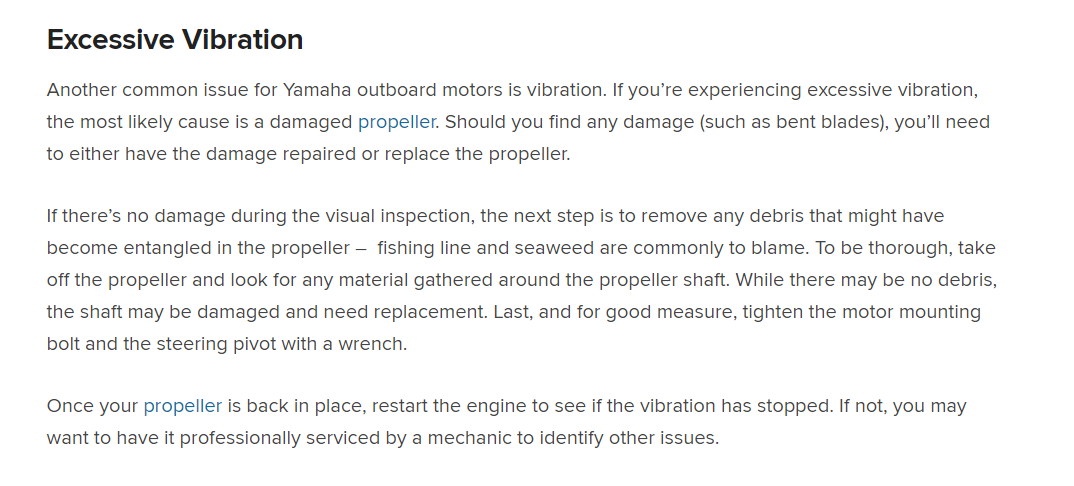

Do you have this motor bolted through the transom or just clamped on? If only clamped, I would worry about you losing your motor to the lake bottom if you tried to use any rubber mount between the motor and the mounting surface. Even if you do have through bolts, your motor mount will move and the bolts will move with it causing the holes to ware with it along with any other surfaces being touched by the mount. I would wonder if you have a running issue with the motor, or issue in the lower unit or prop. Does it shake bad when in neutral at idle or high idle or only in gear? if only in gear, does it do it in forward and reverse? I found this online talking about Yahama outboard common issues. If there is no obvious damage to the prop, I suggest running it on muffs, in gear and see if you can see any movement like a bent prop shaft or a blade out of place. You should see it easier when in motion.
