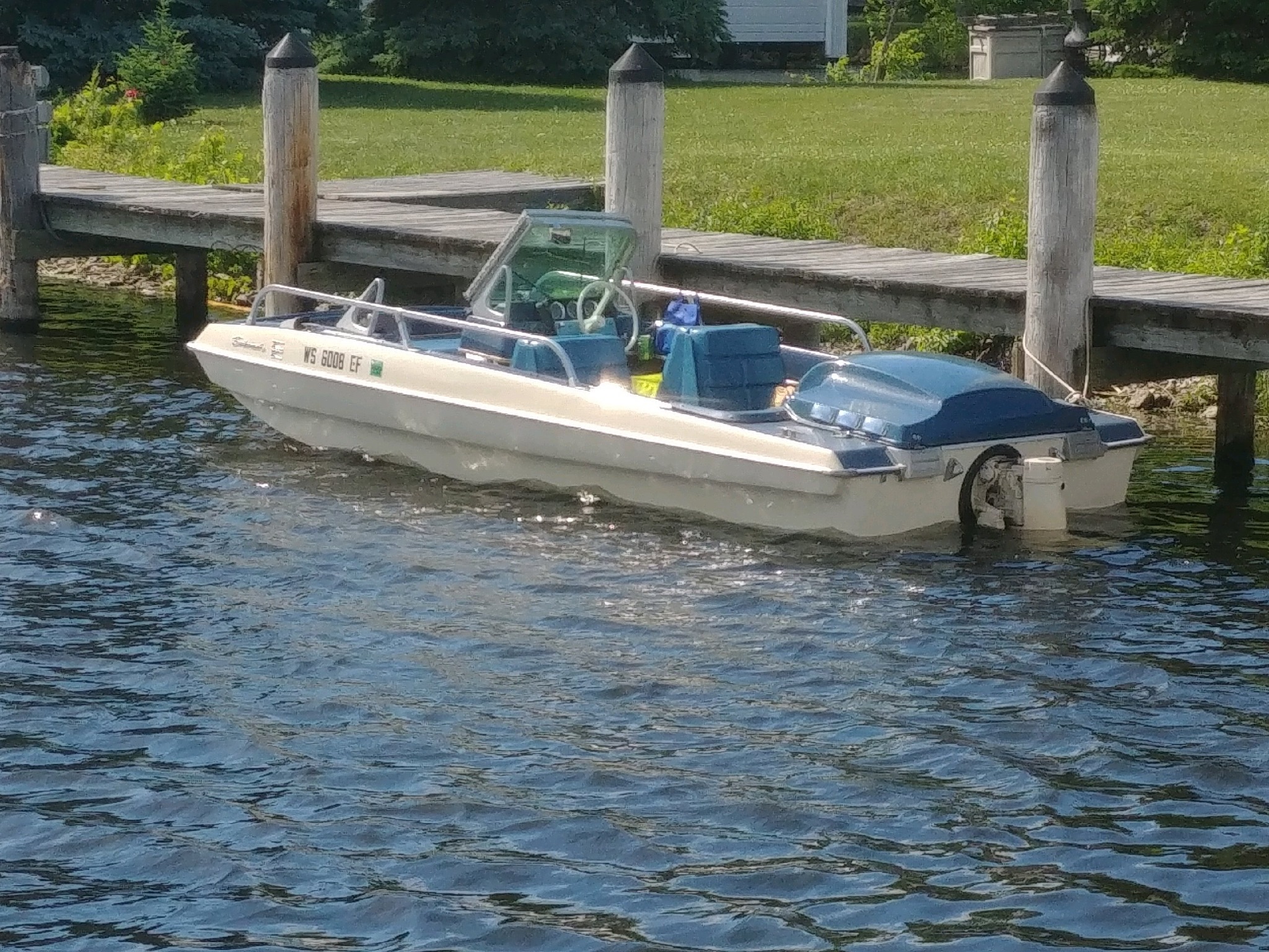

I have the opportunity to purchase a 1964 Evinrude "Sweet 16 with a V4, 88HP engine and an OMC stern drive. I am getting "cold feet" about the purchase as I am hearing that the parts for this engine and stern drive are very difficult to find. While the purchase price is relatively cheap, I don't want to invest in something I might have to eventually haul to the dump. Additionally, it hasn't been in the water for approximately 7 years and I have to believe that it was in salt water. I would appreciate any advice anyone is willing to lend.

The engine isn't as bad as its reputation. I've had one for 26 years without any unusual issues. Parts are out there but certainly not on every street corner either.
According to the promotional brochures for the hull, it has fiberglass stringers so they should be OK but the foam may be wet/waterlogged (and probably is unless the boat is pristine).
I have a '67 Sportsman (open bow model, same hull). By '67, the stringers were wood and they were wet/rotten. I replaced the rear portions, added a centerline stringer, new foam and floor. Boat is strong and doesn't ride too bad.

Thank you for your quick reply. I'm very pleased to learn that the stringers are fiberglass. How will one know if the foam has been water saturated as the flooring appears to be glassed over the foam. Will the foam need to be replaced once removed? Sorry for any dumb questions, but my experience with fiberglass boats is very limited.

The foam was poured in after the floor was installed with the boat in a jig. The idea was to help the hull keep it's form as the foam expanded. Search Evinrude advertising and you will find the ad. Because the subfloor is full of foam, a wet & somewhat rotten floor will feel firm.
You could drill a few random holes and see if the drill cuttings are wet or dry. If dry, you will need to put small fiberglass patches over the holes. My bet is you will find moisture.
Doing a complete floor is labor intense but the stringers will be good, so that is 50% of the challenge.
Now the bad news, you probably can do the work required to make it a good reliable boat and only sell it at a loss.
