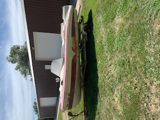

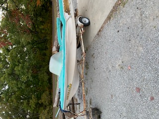

I'm considering sandblasting two 1950 fibeglass boats I recently purchased. One is Glastron Fireflite and the other a Larson Thunderhawk Jr. Does anyone have experience with sandblasting their boat? Both have multiple cracks in the gelcoat and the Larson has a cracked hull to repair. I'm thinking that blasting will knock off all the old oxidation quickly and allow me to patch and apply a new layer of fiberglass to both of them. I've followed and watched Boatworks.com and he seems to only grind surfaces. That seems to be a long dirty and itchy process. Thoughts?
