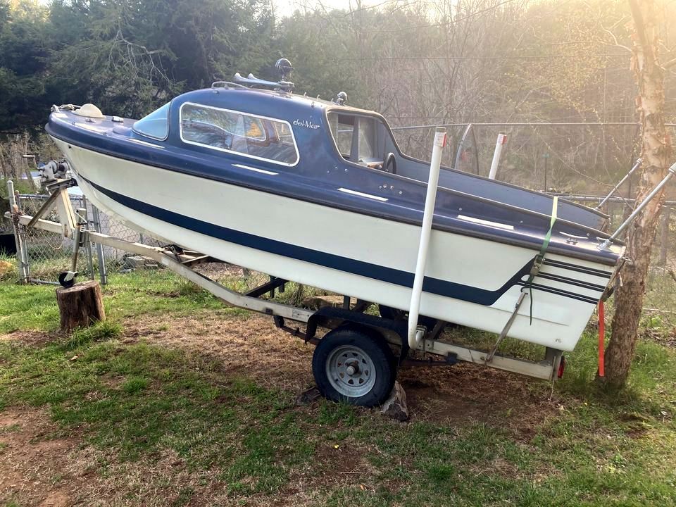

I have a 1958 Glasspar Del Mar. I'm toying with the idea of converting it to a two-passenger "coupe" powered by an odd-fire Buick V6 stern drive. I needed the weight of a 100 HP outboard in order to subtract it from the weight of the V6 set-up to see if the idea is going to work.
I figure the V6 sterndrive needs to weigh no more than a 100 HP outboard plus 300 lbs of people in the rear seat. So now I know that's about 550 lbs. Some ballast in the bow and a lot of floatation on either side of the engine should do it.

Im not sure of the ratio but I am sure the weight of the outboard is going to actually "feel" like more as it hangs off the transom, so there would be some leverage effect there. without that, I would think that you could actually go a bit more weight if making an inboard due to the fact that the weight hanging out past the transom is different. so shouldnt you be just trying to keep the center of gravity about the same place and the rest will work out?
If i am thinking about this right, you should get the weight of the stern drive unit, Im just going to throw numbers out here for fun. lets say an old 100hp weighs 300lbs, your stern drive weights 150. now you have 150lbs less hanging over the ass of the boat. 2 passengers = 300lbs (I wish) but your Buick weighs in at 450. (again I am just throwing numbers out there, I dont know what your old motor weighs) You might think you are dead even because you had 150 lighter hanging off the back when in truth, with my fake numbers you probably would have more room for weight in the motor area because there is not the leverage of the extra weight hanging off the back. I dont think you would need a ballast.
