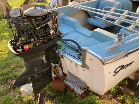

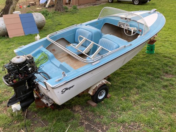

Picked up this 1962 Glasspar Marathon a couple weeks ago. Has a 1968 55hp Johnson TR-10R.
According to the seller it has been in a barn since about 1989 and was used at Lake of the Ozarks. Has the typical cracking for old fiberglass but seems to be pretty solid. There's a bad spot on the floor in front of the tub but looks like an easy enough repair. So far I have fogged the cylinders with deep creep and got the engine to turn over by hand. Seems to have good compression but haven't put the gauge to it yet. I've already purchased all of the maintenance parts and service manual for the engine, hopefully I'll get it fired up in the next month. Plan is to get it running, polish it up a little bit, and enjoy on Stockton Lake. I'll start a thread in the projects section as I get to working on it more.
I'm in need of the stern light lens is anyone knows where to find one let me know!

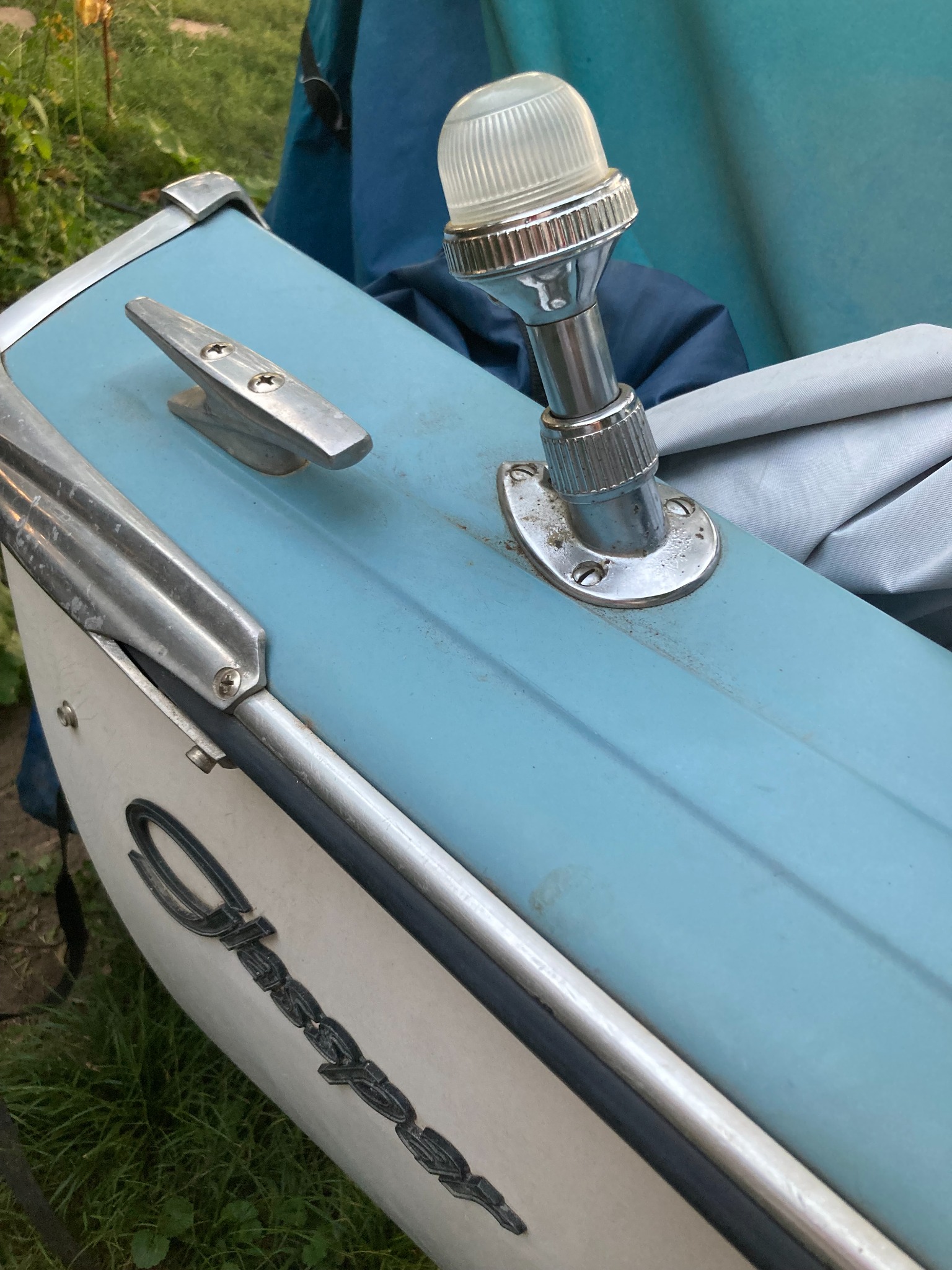

I was able to find a plastic stern light lens close enough to the diameter of the original base I still had left. Sanded the two down and epoxied them together and I think it'll do!

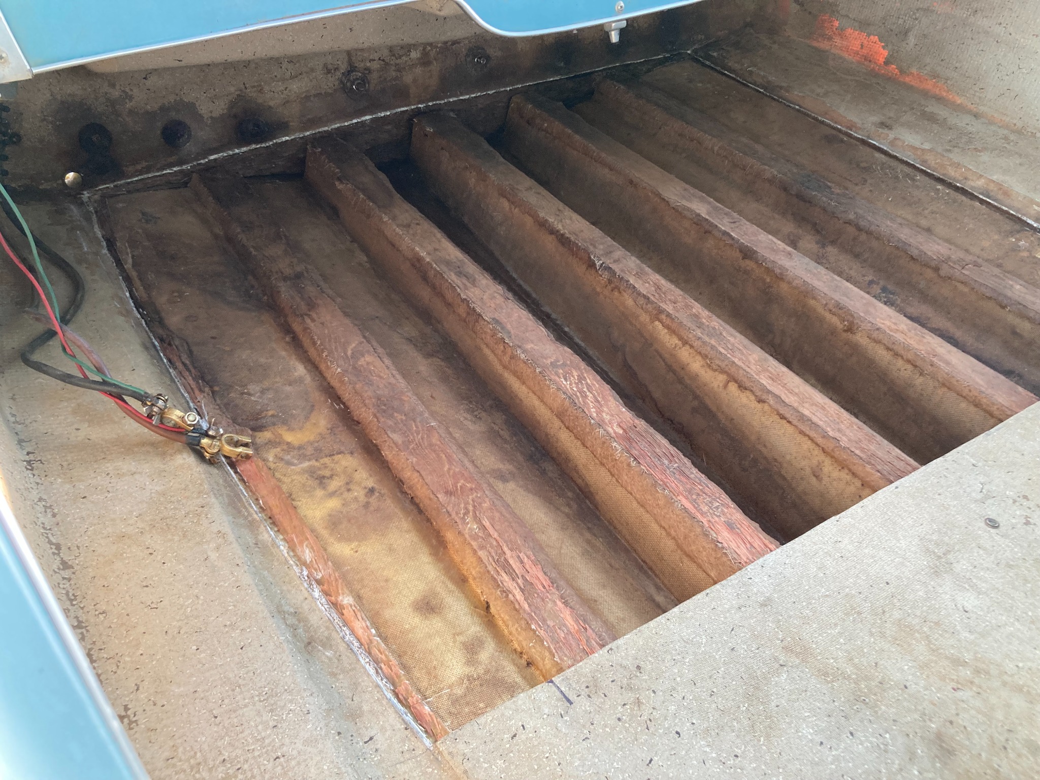

Finally got to work with the floor repair, was lucky enough to get the call on a kidney transplant the same month I planned to take a week off work to start this project. Also got lucky with fiberglass stringers! After my research I was sure they were going to be wood.

That is a little beauty for sure. Could have been a late 62 given the fg stringers.

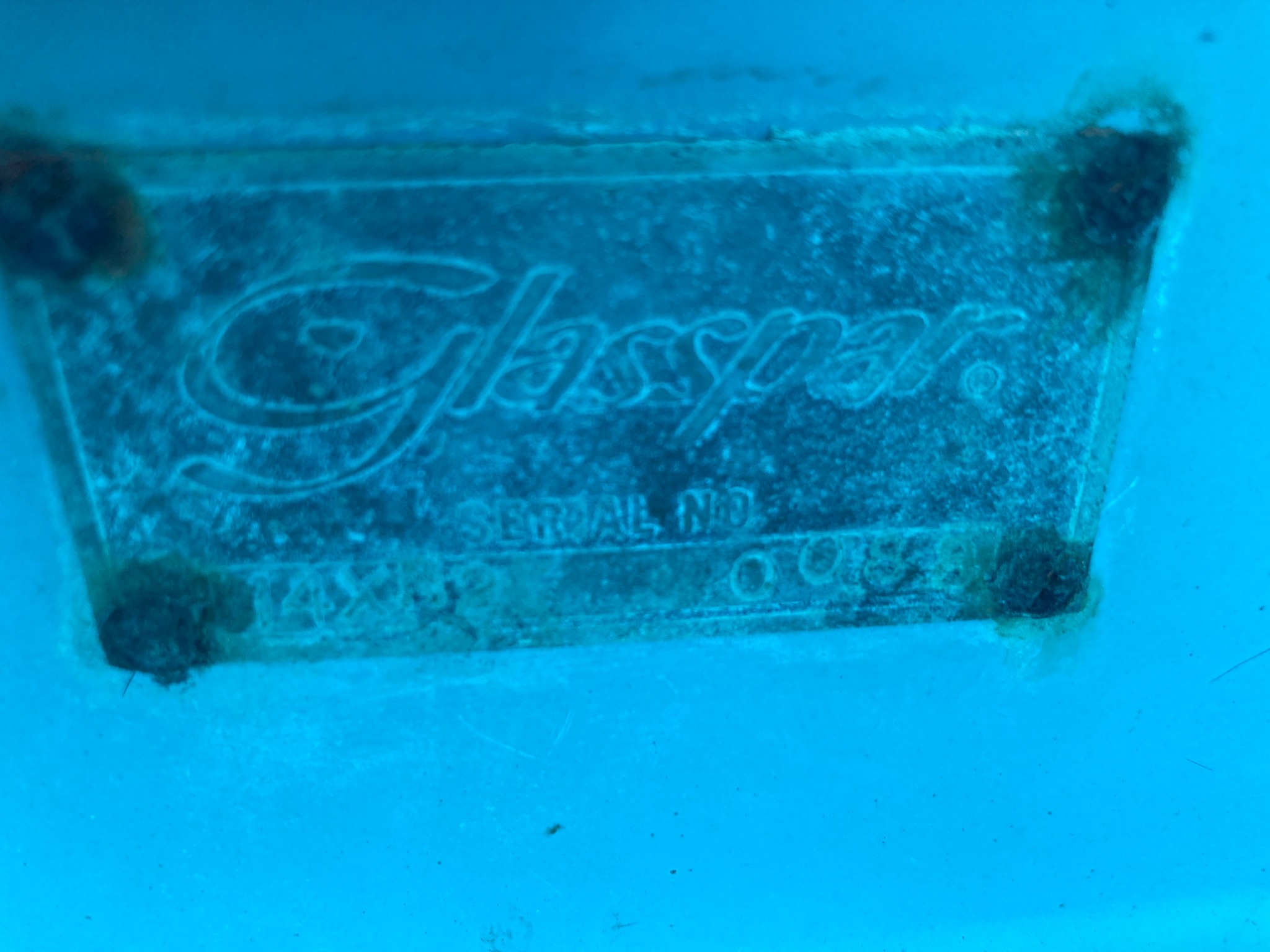

What do you think of my new 62 Marathon? 3 years 2 months ago #148402

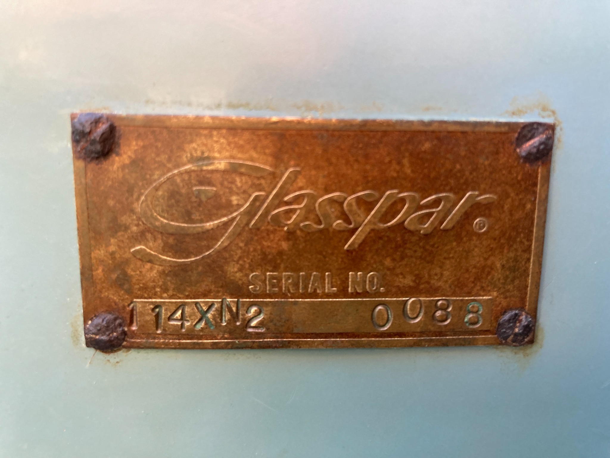

Thanks! I'll clean up the plate and get another picture of it tonight.
Pretty hard to read right now but it might be 14X220089
What do you think of my new 62 Marathon? 3 years 1 month ago #148408

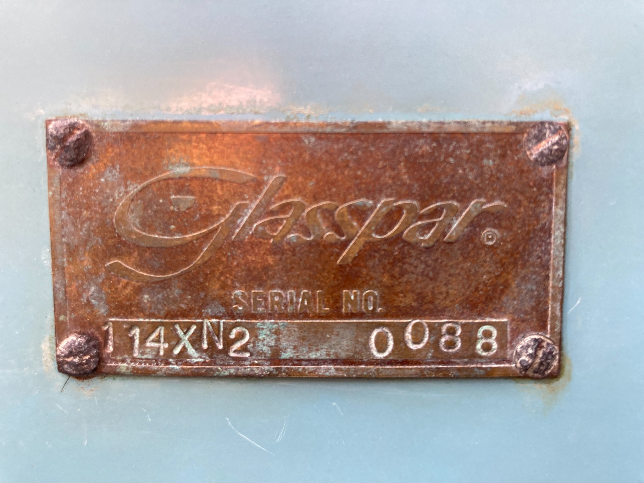

Got the serial number plate cleaned up. Thought it was aluminum!
What do you think of my new 62 Marathon? 3 years 1 month ago #148409
Looks like 1 14XN2 0088
Not sure on the first 1 but the rest designates it as 14 foot hull built in Nashville in 1962 and was the 88th boat off the line.

What years did Glasspar use fiberglass stringers?
What do you think of my new 62 Marathon? 3 years 1 month ago #148434
I believe 63 was the first year for fg stringers on Sedans and G3's.

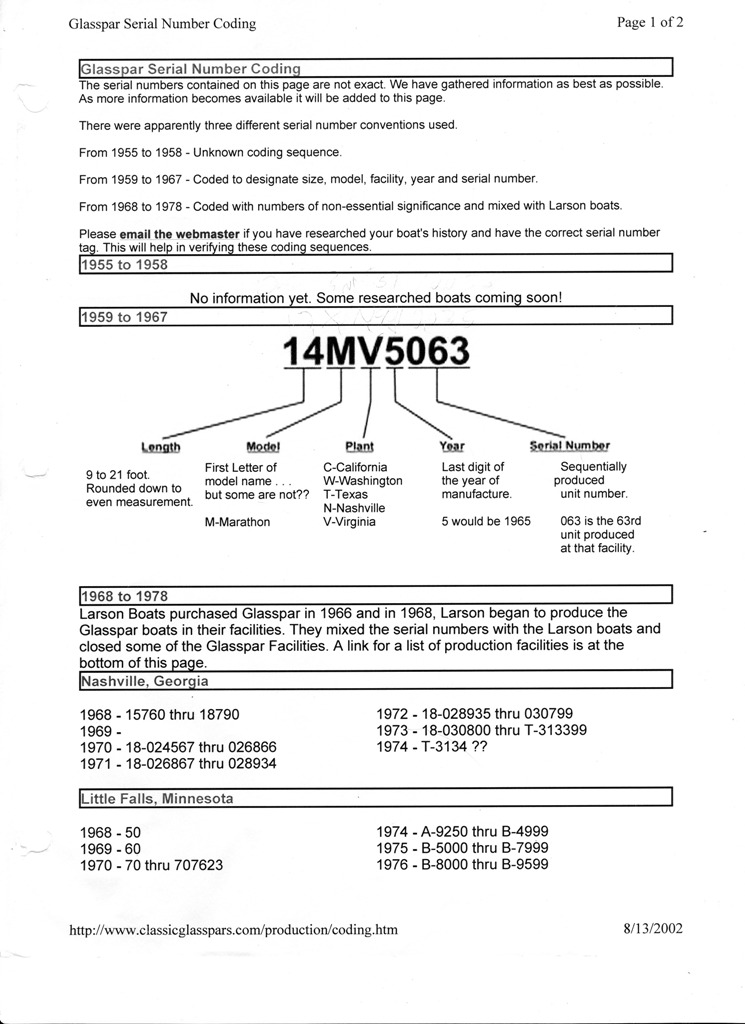

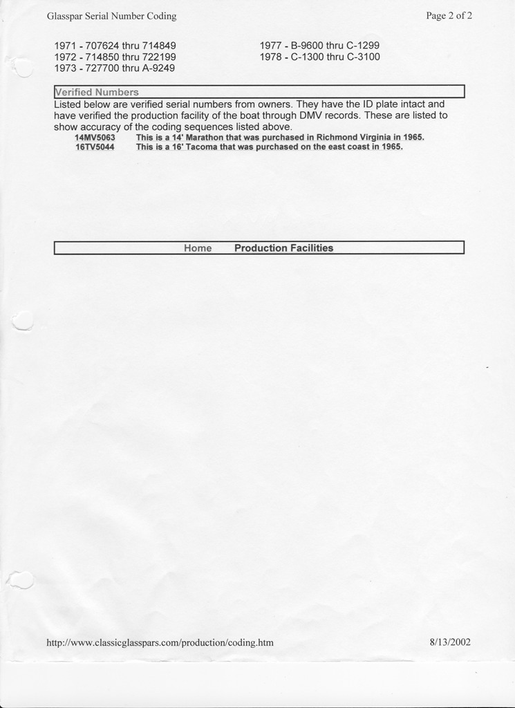

I just joined the site. I was involved with Kelly back in the '90s when he started this website. Kids and life happened and I drifted away. Anyhow, "14MV5063" is my boat's serial number! I seem to remember working with someone on decoding the Glasspar serial numbers back then, probably how mine ended up as the example.
I think the first "1" in the serial number here is a simple mis-strike. It was off out of position and so they re-adjusted and started over to the right. judging by the unevenness of the other letters and numerals, the person embossed the serial number might have been a newbie or not very skilled.

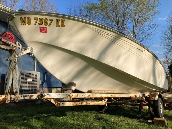

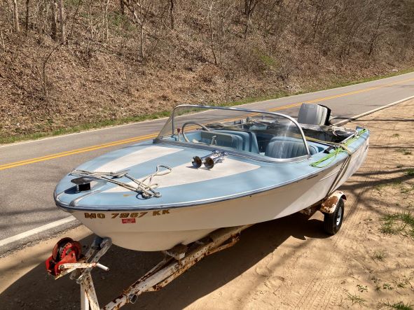

With the right prop matched to the load, the 1965 Johnson 75HP will do about 32 mph according to the "Sea Speed" speedometer at 5500 rpm. The boat was stored in a carport the first three years my dad had it, then an unheated garage for the next five years, then in a climate-controlled basement garage for the next twenty years, then in my unheated garages for the next 29 years. That should add up to 57 years, with the first year being unknown storage by the first owner. There was one summer in the early '90s where my dad put it on consignment at a boat dealer's lot and it didn't sell. That really was where most of its weathering and age occurred. It's not bad, but it's more than it would have been if he hadn't done that. The component that took the worst beating in the sun is the red Johnson Electramatic shifter knob. I've found "NOS" parts but they are not "correct". The original was a true red and the later ones are almost orange and don't look right. The newer "NOS" ones also have a mold line on the outside that's not present on the original on this boat. The upholstery in the boat is original pearl ivory except for the splash well cover that was redone in the '90s and needs re-doing again. The steering wheel is the Attwood "rope" style that originally was bright white but has since yellowed.
The Tee Nee trailer is not in good shape. My dad bent two cross members one time pulling in the boat on a makeshift riverside ramp on the Rappahannock River. The welds on one of those members broke and I re-welded it but the welds broke again. I installed two 1/2" threaded rods fore and aft of it and that has it stabilized. I'm pretty sure it's a 900 lb. model (have never found any markings on it, although recently I saw a photo showing the number plate might be on a cross member ahead of the axle). By my calculations 900 lbs. is not really adequate:
Boat Hull 460 lbs.
Engine 246 lbs.
Battery 45-50 lbs.
Fuel 20 gallons 125 lbs. (my dad installed a plastic 26 gallon tank under the splash well in the early '90s...way too big and I never put more than 20 gallons in it).
Gear 100 lbs.
Subtotal 981 lbs.
These are conservative numbers on fuel and gear, but it shows how the trailer isn't really heavy enough. Even if I restored it (not really a project I want to tackle), it would still be too light. So, I've been looking at new / newer trailers to see what might be a good fit. My idea is to frame up supports under the boat, pull out the old trailer, and roll a new one back under it.

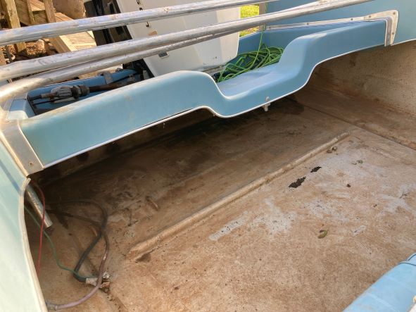

You might notice in some of these pictures that the transom is forward of the rollers and appears unsupported. That's how it's always been since it was delivered by Glasspar, but once someone pointed that out to me on another forum, I moved the winch strap pylon sternward about 1-1/2" and that took care of the issue.

That's neat that you know all of the history. That's a great looking boat! I was wondering if there would have been a cover or something for under the splash well in '62. There's some sort of hardware on the splash well and floor but the rest of whatever goes there is missing.

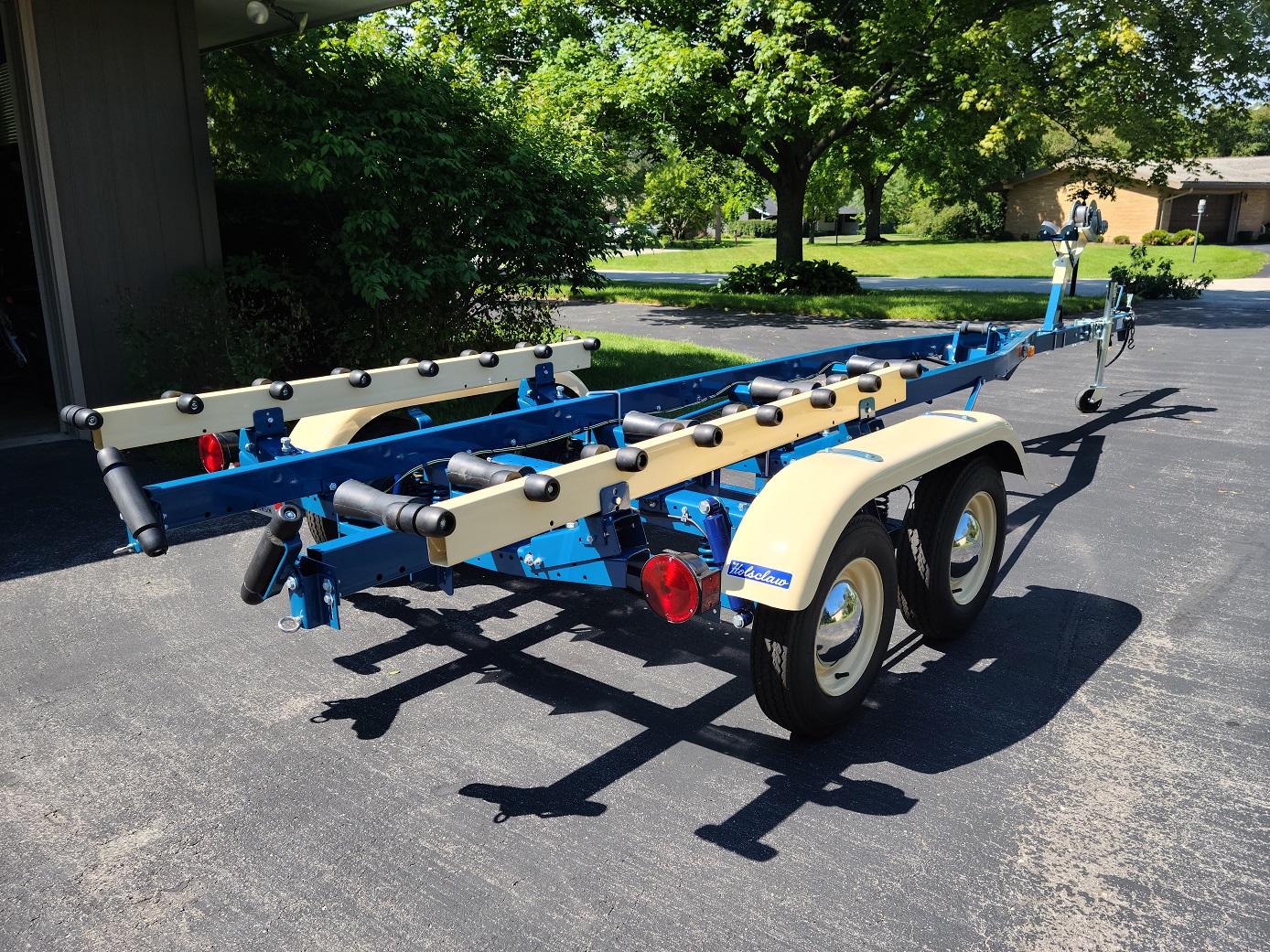

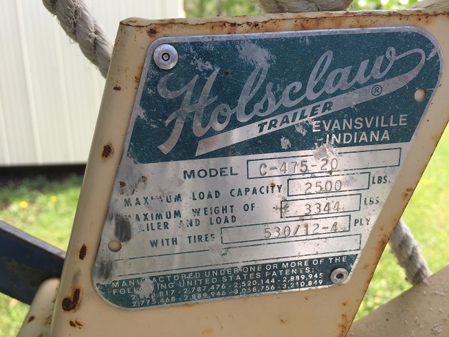

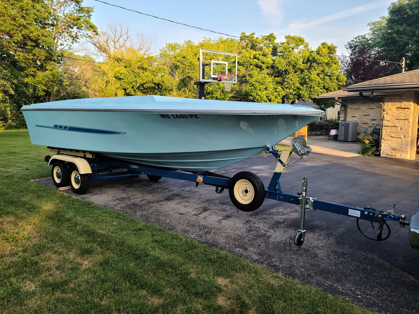

Beautiful boat and hope the project turns out to be enjoyable and something to look forward to. Related to your trailer, you might consider your weight rating is tied to the tire technology of time of manufacture as opposed to the frame/roller/spring combination. I just completed restoration of my Holsclaw trailer. You can see from the original capacity plate, the trailer capacity noted is based on tire load ratings.
The modern version of the 5.30 - 12 made by HI RUN is 6 ply and rated at a maximum load of 1045 lbs. This potentially adds over 600 lbs of capacity to my trailer. Other Holsclaw trailer enthusiasts agree the various trailer load ratings were tied to wheel/tire combinations and the frames/spring combinations were the same thoughout the load range. I don't intend on using this extra capacity, but it will give me piece of mind when towing a boat loaded with fuel and gear.
I understand a new trailer offers you piece of mind.
You might also consider increasing the scope of your project to include restoration of the TeeNee Trailer. The boat and trailer have been paired together for 57 years after all......just a thought.

Beautiful job on your trailer! That does provide some inspiration for restoring the Tee Nee. The Tee Nee does have the advantage of being considerably shorter for storage than comparable new models, but the short tongue and tall height also mean the tow vehicle has to get closer to / into the water to launch. The original fenders / brackets cracked and had to be removed in the '90s. The only replacements I could find were a larger radius, which needed larger wheels to look right, which of course raised the height of the trailer a few more inches.
Did you remove all the hardware on your trailer and take it somewhere to be sandblasted and painted?

The Glasspar production code I posted came from the now defunct classicglasspars website which was built by Mike McKinney.

I don't think I knew Mike, or if I did maybe I only knew his username. That's a nice resource for Glasspar production codes. I do remember contributing my boat's info for the Marathon. I thought / hope other Glasspar owners would add more codes for the other plants besides Petersburg.

Yes, I dissassembled the entire trailer and had it media blasted and powder coated. I kept it all original except for the addition of modern electric brakes. It's all posted over in the 70's Discofiber section. Some of the members accurately commented on my mental state as I made my way through the process. (for instance, I replated all the hardware in my basement over the winter) The trailer is currently nicer than the boat.......

I just read through your trailer restoration. First of all, thanks for documenting it so thoroughly. Secondly, what dedication! You went to the limits to preserve original parts and authenticity with great results. Well done!
