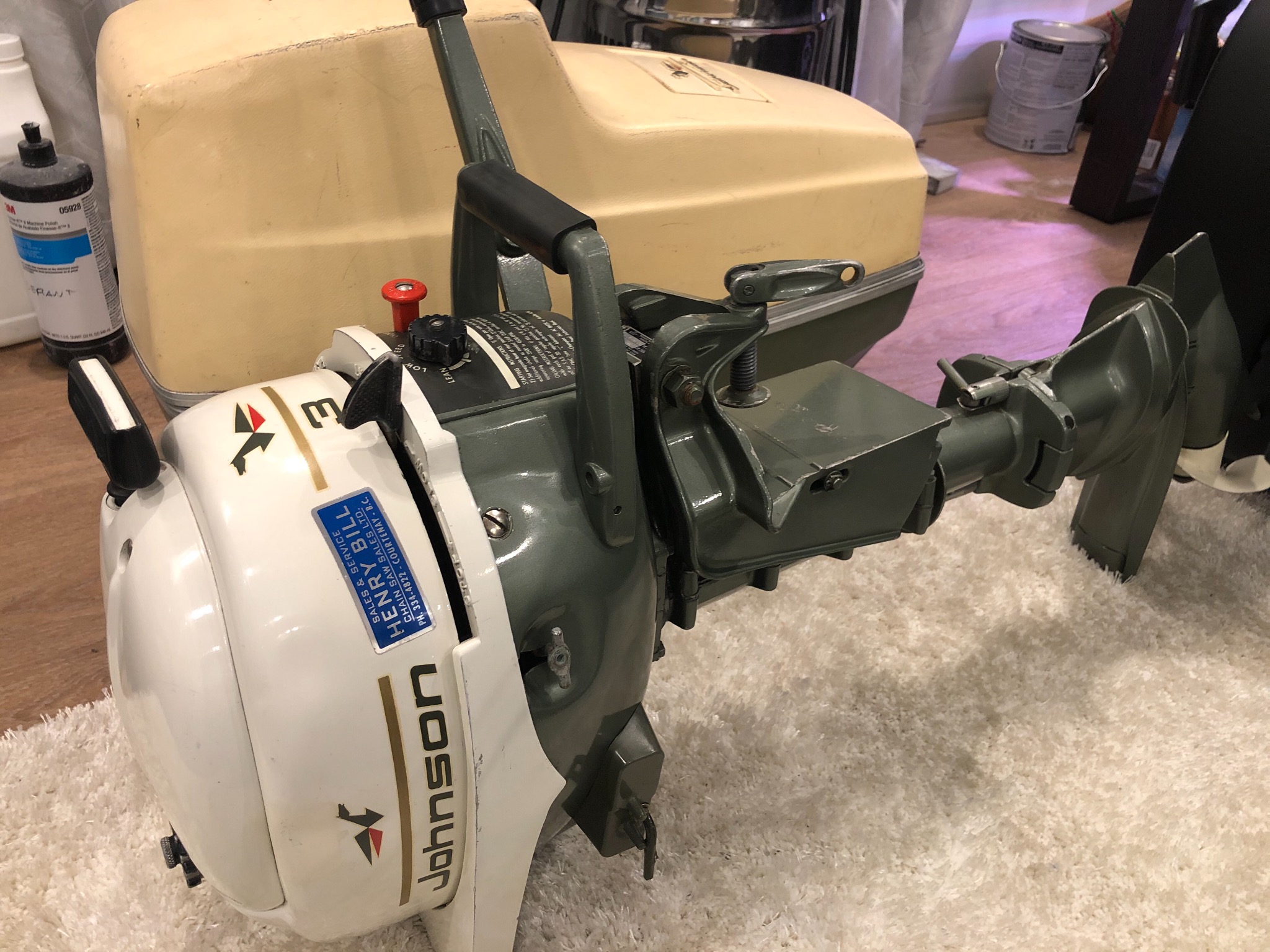

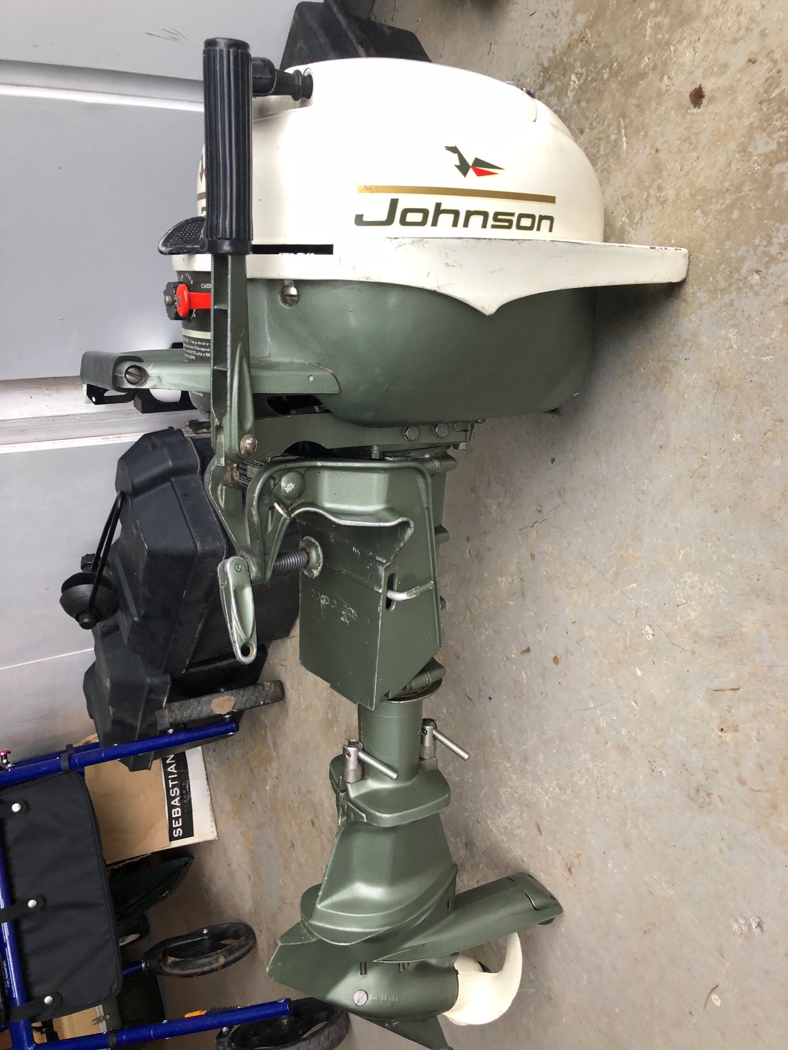

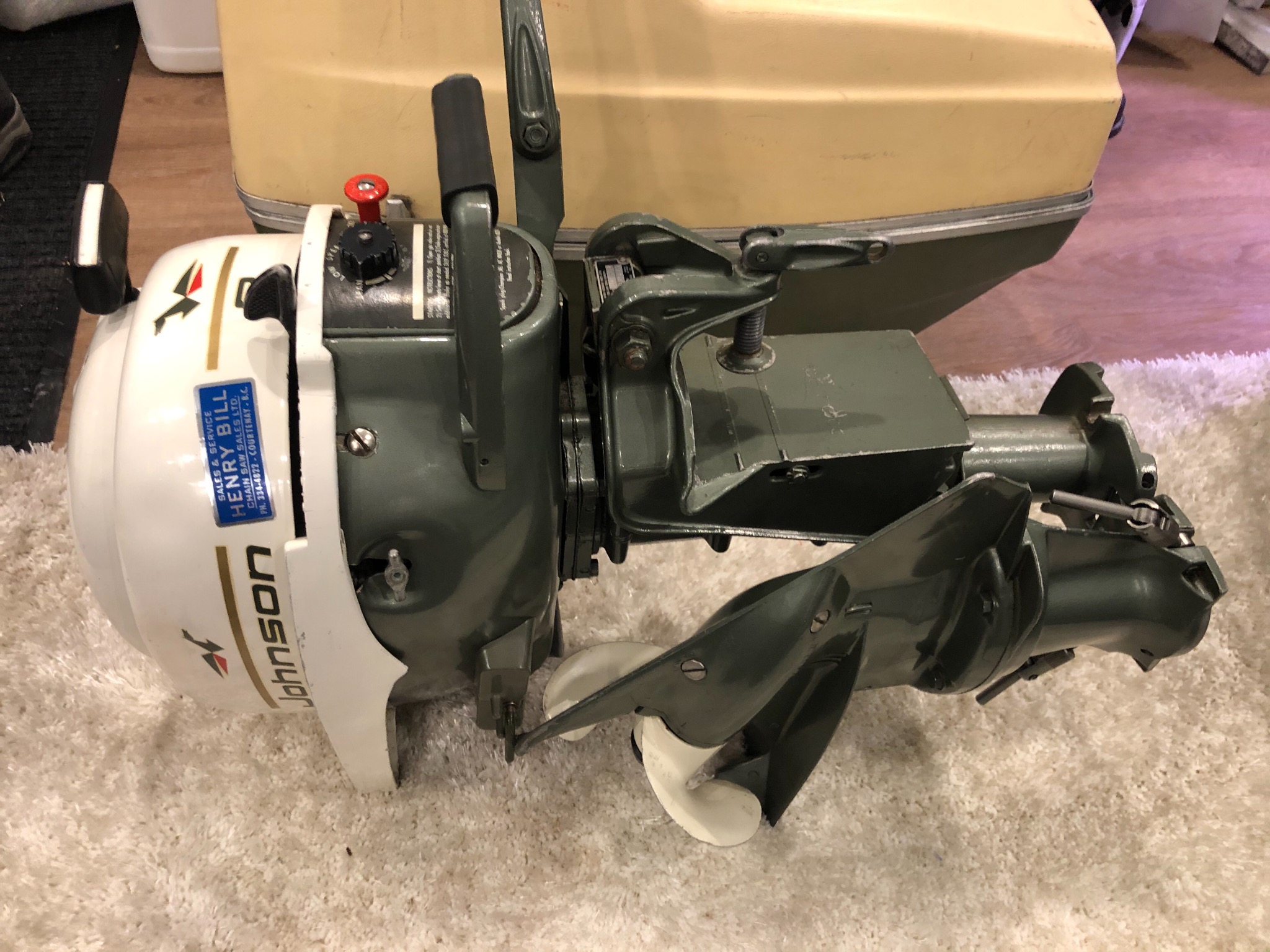

Saw this for sale on Craigslist and lucky enough to get it for $250 from original owner since new he haven’t start it for 20 years . He said it is only use in fresh water when he had it now he is old and can’t use it anymore. I like to try to fire it up but what should I check first, it’s a 3 hp don’t know the year .
What should I do before I start it up 4 years 9 months ago #146083
A folding 3hp with the case. Looks to be in good condition, at least cosmeticly.
Spray some fogging oil down the carb & into the cylinder. Pull it over several times to get it distributed throughout.
Check gear oil to be sure there is some.
Check for spark, old coils sometimes crack apart.
50:1 oil ratio.
See it it fires.
Very likely carb will need cleaning.
If it runs, check for cooling water from the exhaust relief ports & for any fuel leaks.
Expect to replace water pump.

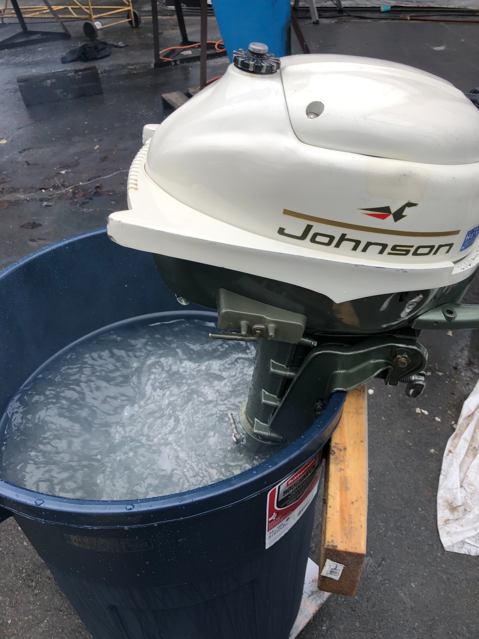

Got it ran with 5 pulls don’t seem gas leak and sound good but where do I check for pee hole
What should I do before I start it up 4 years 9 months ago #146092
Is any water coming out with the exhaust? I don't know if there is an actual "pee hole" on these small Jonny-rudes.

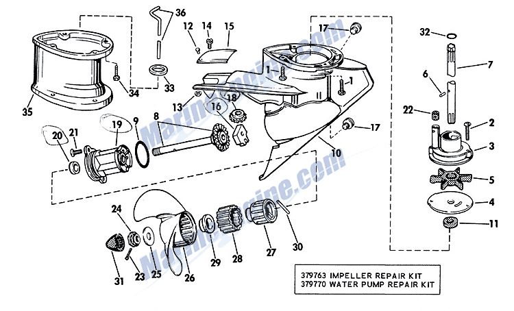

It should be just above the lower unit. Find the model number and go to www.marineengine.com/ . They have exploded views of most engines so you can see generally how they go together. I have attached a picture from marineengine.com that looks like your motor.

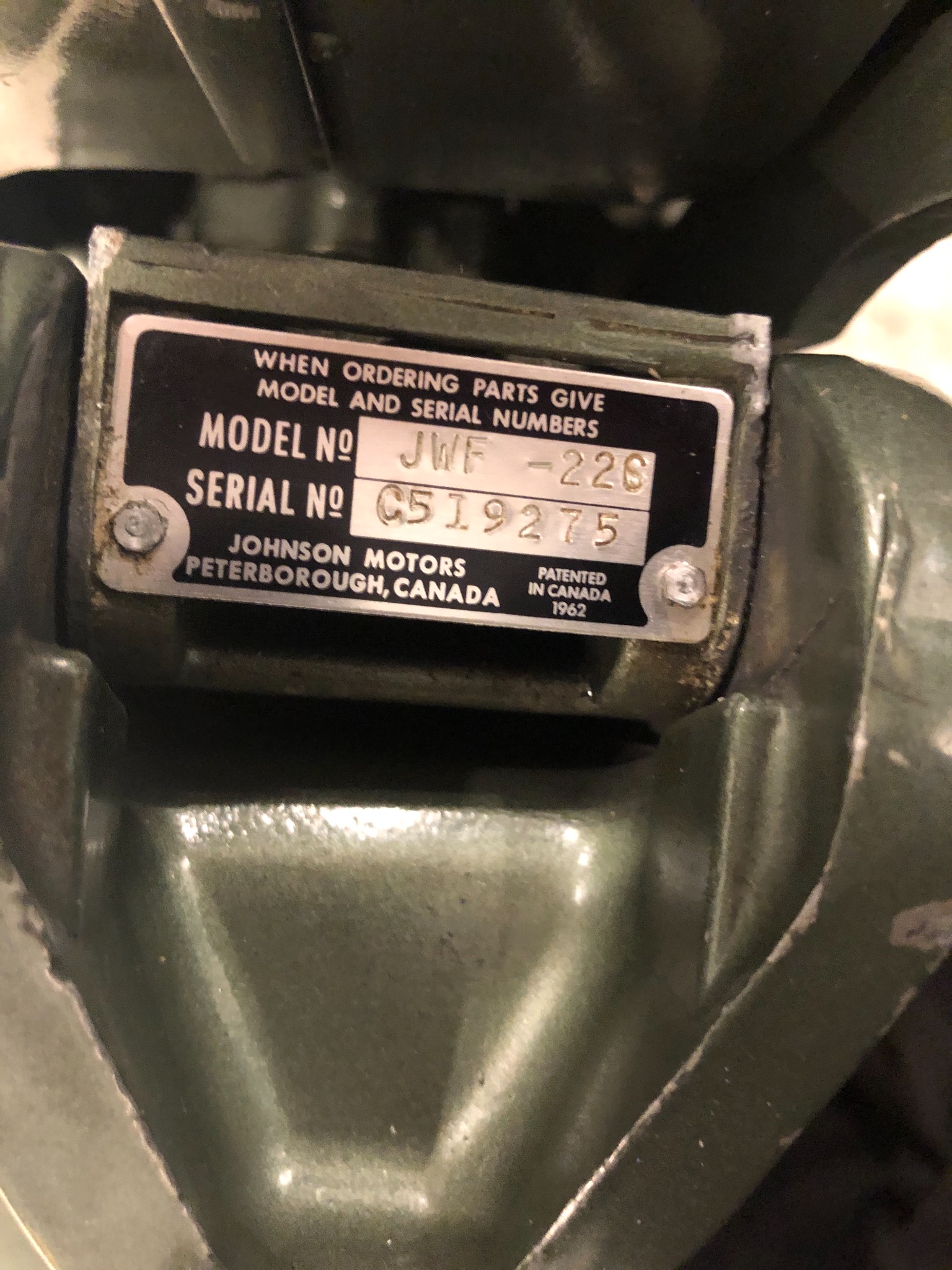

Also, give me a model number and I will tell you the year. It looks like a 65-66-67. If the engine were mine I would be running it on a 24:1 ratio since that series still had the old 3-ring pistons and plain bearings. You will never lose an engine due to using a bit more oil.

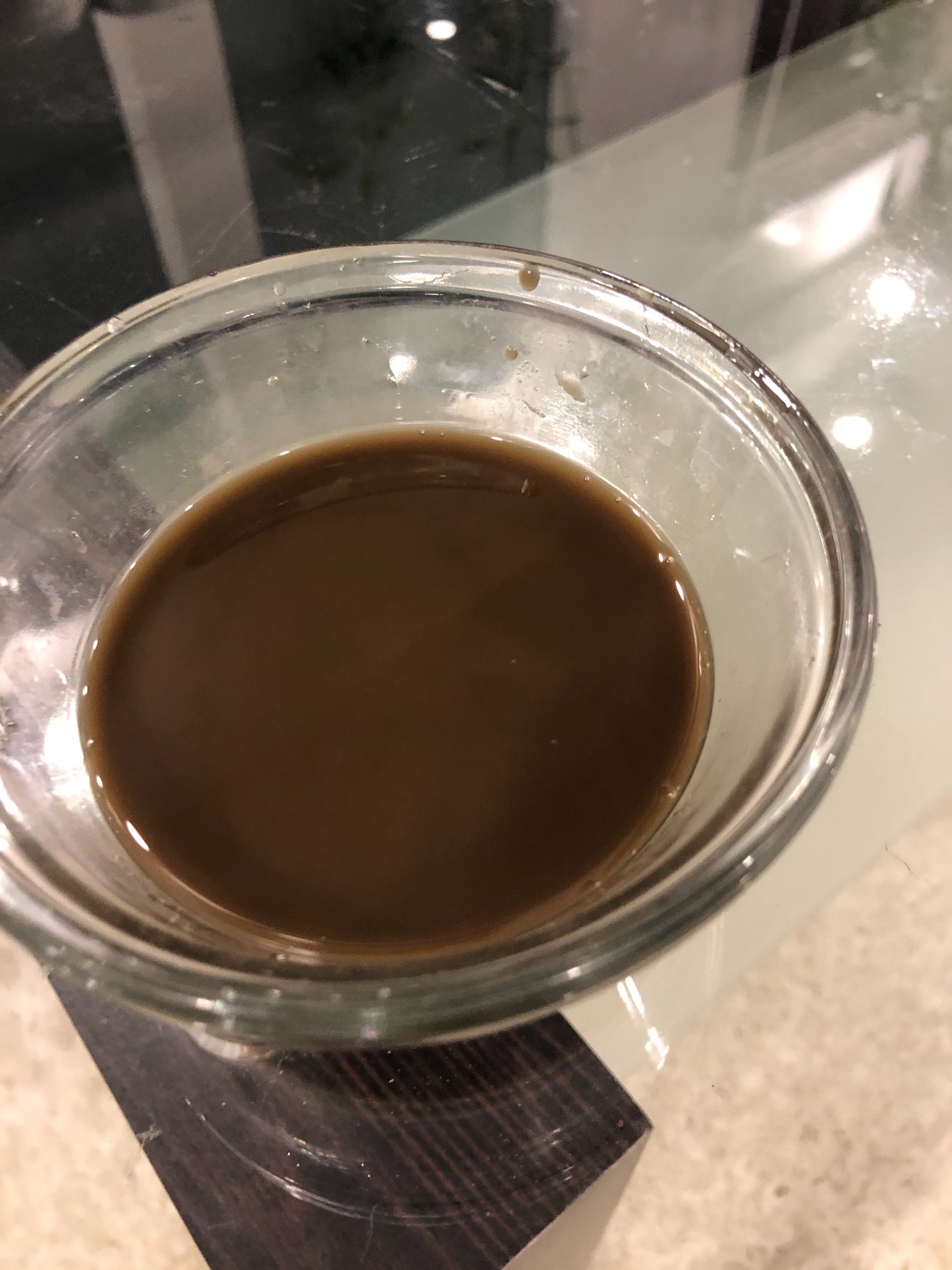

Saw then all , what oil do I put in if I want to change the gear oil ? I got the old oil out not to much in there but color doesn’t look right it’s not black or clear it’s brownish
What should I do before I start it up 4 years 9 months ago #146105
Brownish may be okay and may also mean a small amount of water in the gearcase that has been there for a while.

A JW-22 is a 1967.

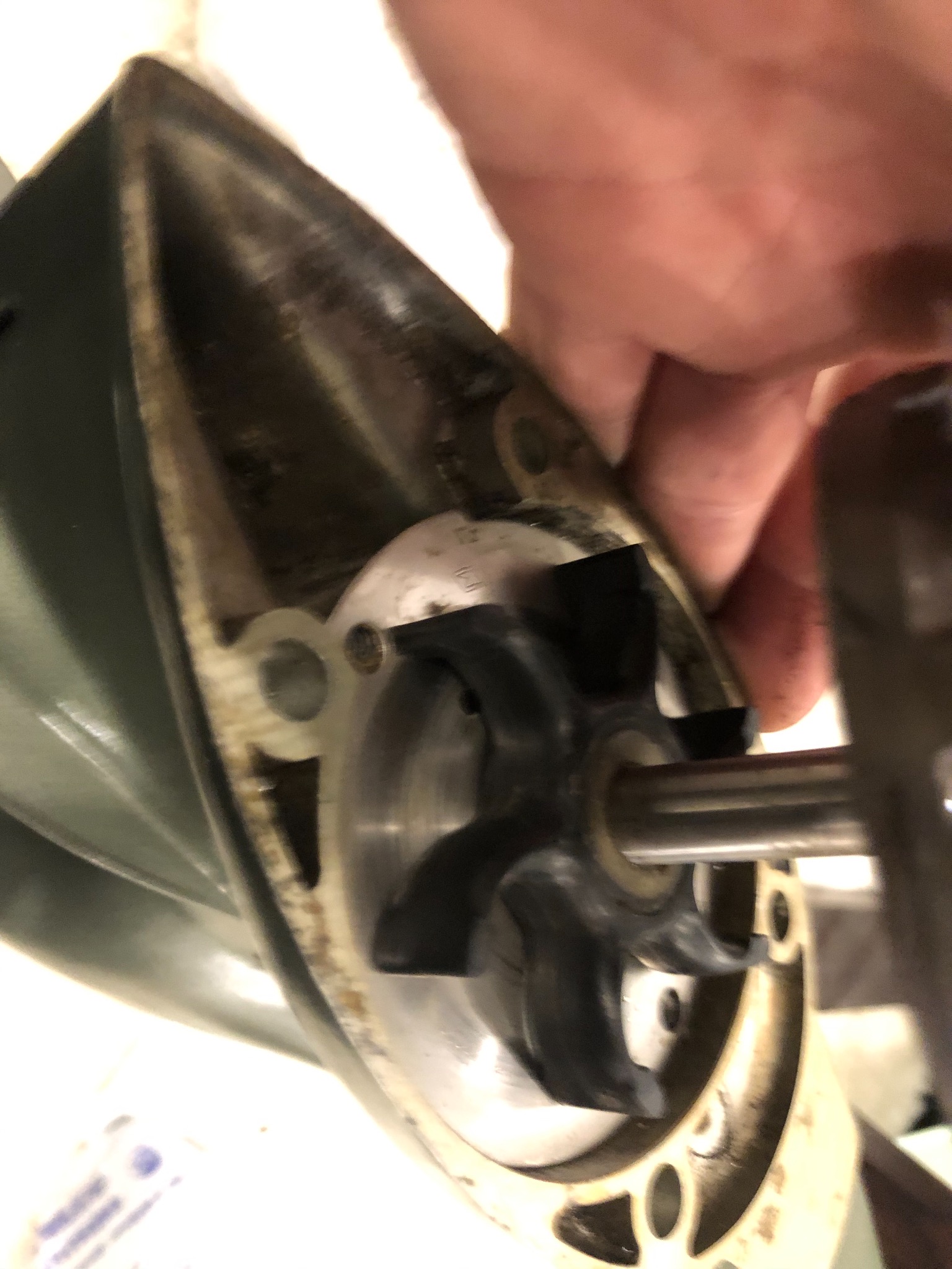

What should I do before I start it up 4 years 9 months ago #146110

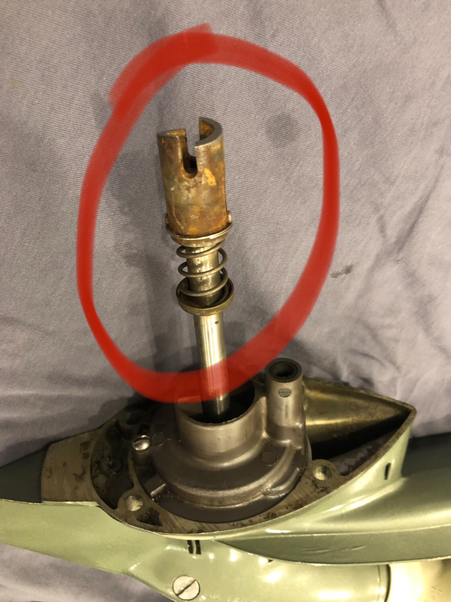

it looks like there is a roll pin that will need to be tapped out with a small hammer and a punch. Light taps should get it and don't lose your pin! Your photos are a great reference for putting it all back together correctly.
With that being said take note of the direction of the curl or bend in the blades on the old impeller. Your new impeller will have straight blades, it is imperative your push the blades the same direction when reinstalling everything or the pump will not work correctly and you will destroy the new impeller if ran for any length of time.
What should I do before I start it up 4 years 9 months ago #146113
If you have difficulty removing the coupler pin there is another way. You can simply slide the driveshaft up and out of the gearcase. The downside of this is that the 3hp is about the only engine that is a son of a gun to get the pinion gear lined back up to accept the driveshaft again but patience always prevails. If you do this then the impeller will slide off the bottom of the shaft. Watch out for the small impeller drive pin. Do not lose it and make sure it goes back into the assembly. Always liberally lubricate the impeller housing screws on assembly and wipe the inside of the impeller housing with a small amount of lubricant as well. With the housing straight up and down rotate the driveshaft clockwise to get the blades to load into the impeller housing correctly. Hold and press down on the housing while you rotate with the other hand. Piece of cake this way.

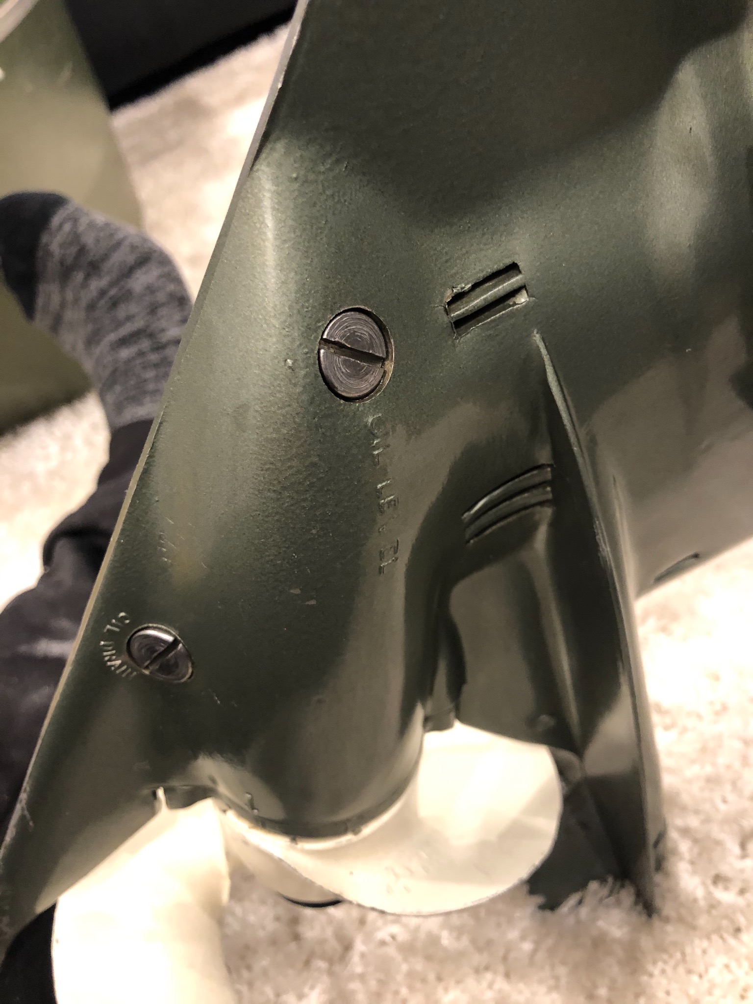

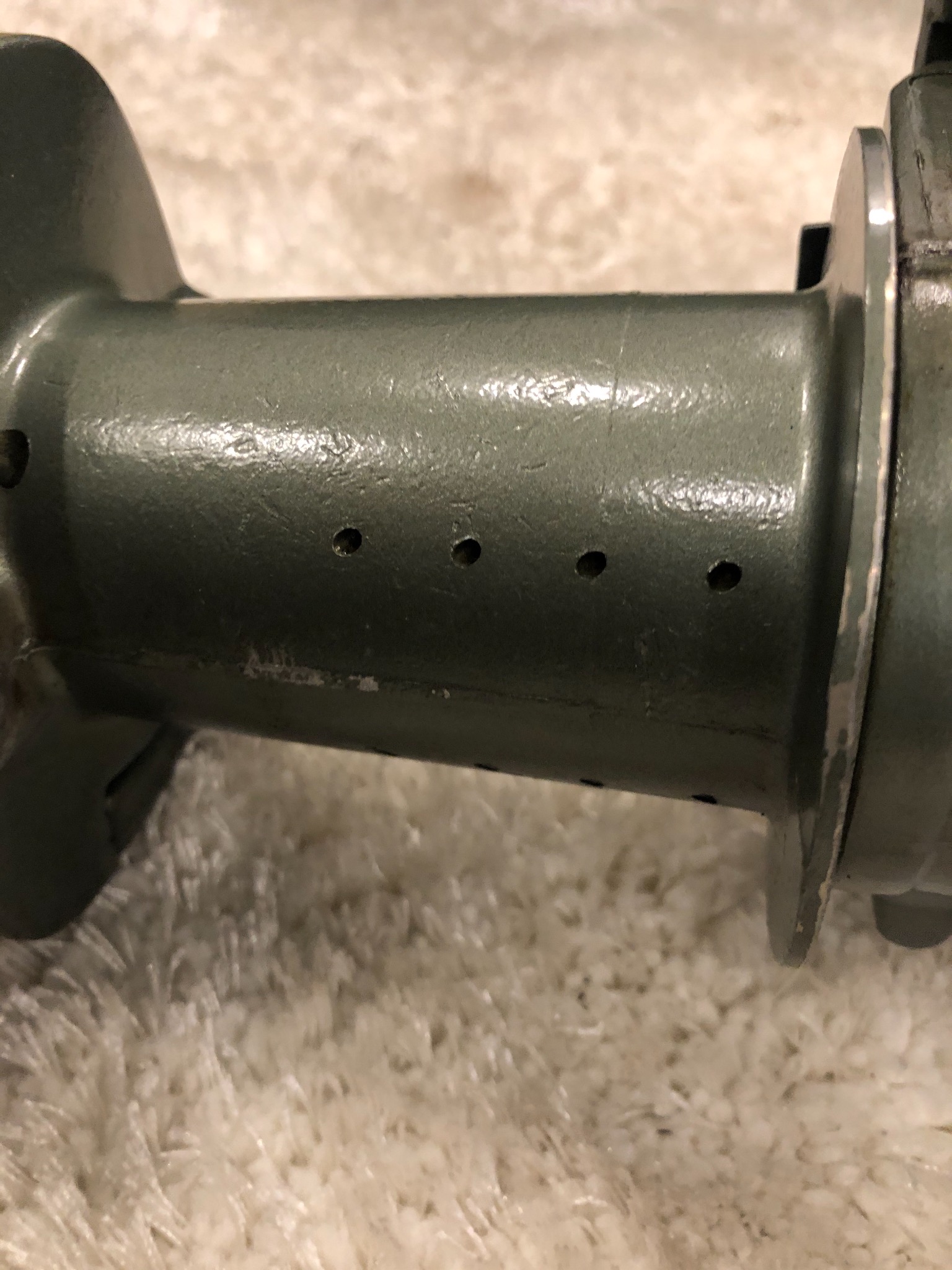

commando wrote: Got it ran with 5 pulls don’t seem gas leak and sound good but where do I check for pee hole
One of the pics you posted of the center section (aka exhaust tower) has 4 holes drilled in it, water coming out of the discharge side of the block should be forced out of those holes, in a fine spray. You can also feel the cylinder head or the block to see if the powerhead is getting really hot. It should be lukewarm (except the exhaust manifold cover, it'll get quite warm). If the block is too hot to touch, that's way too hot.
