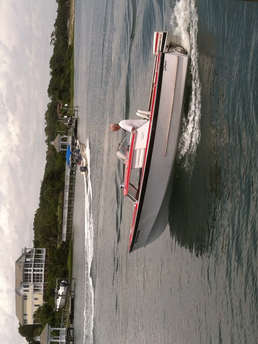

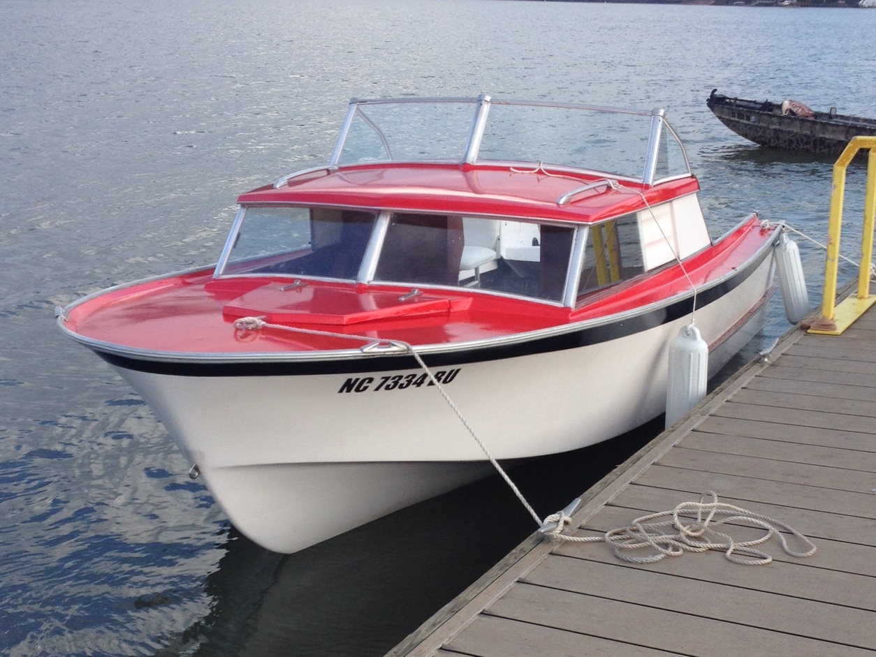

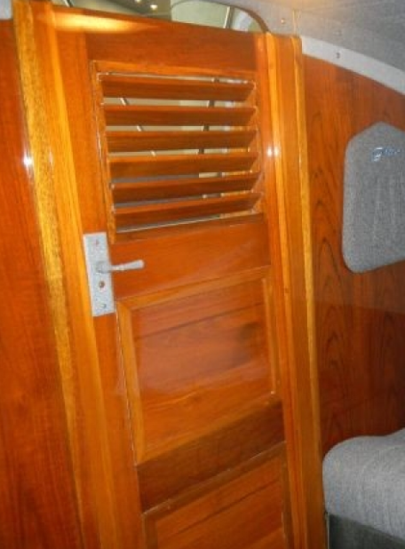

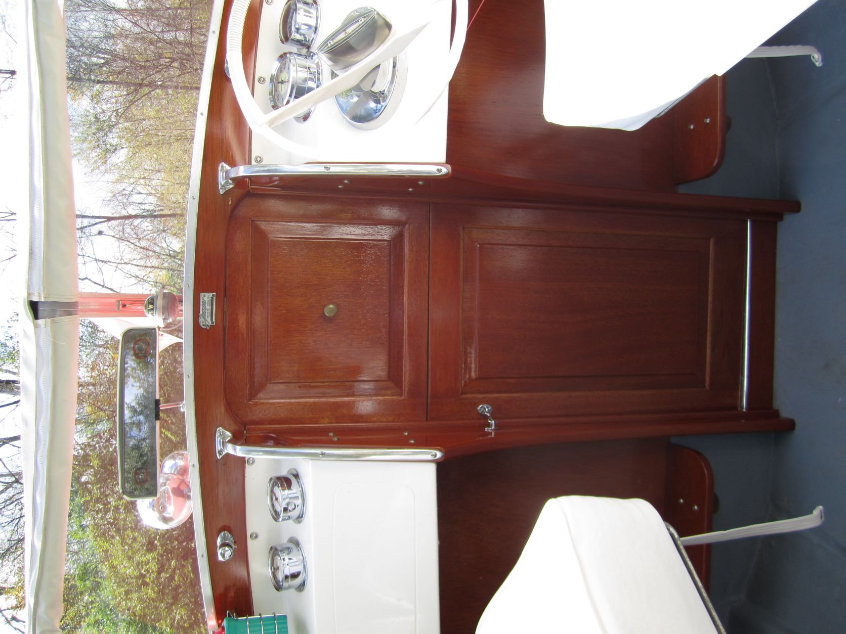

Hello Dan,

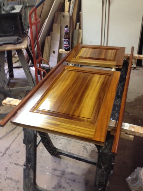

Sounds like you prefer to keep it original. Replicating the paneled door will require some cabinet making skills and tools.

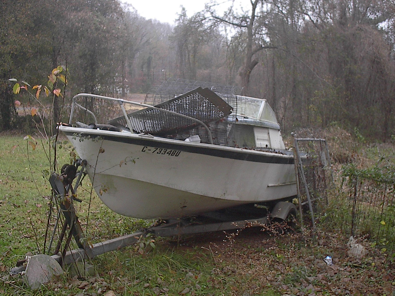

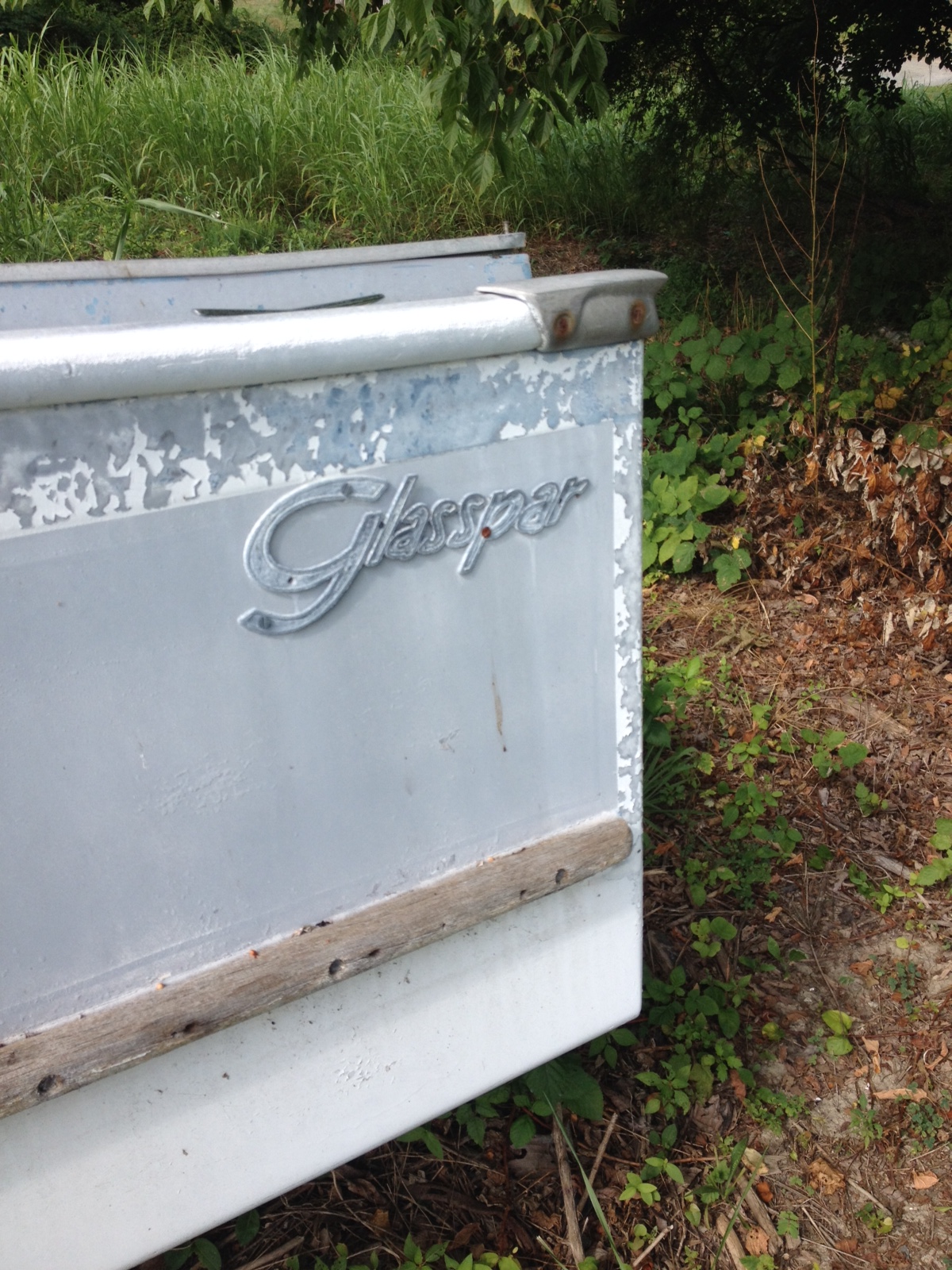

My friend John down in NC found this old sedan and brought her back to life.
It required replacing every board foot of wood due to termite infestation.
He happened to find a vintage mahogany stash and was able to replicate and replace every stich of wood.
John from NC is an engineer and works with wood as a hobby.
His door is exquisite
He also highly recommends a Sammy or two when the woodworking gets rough.

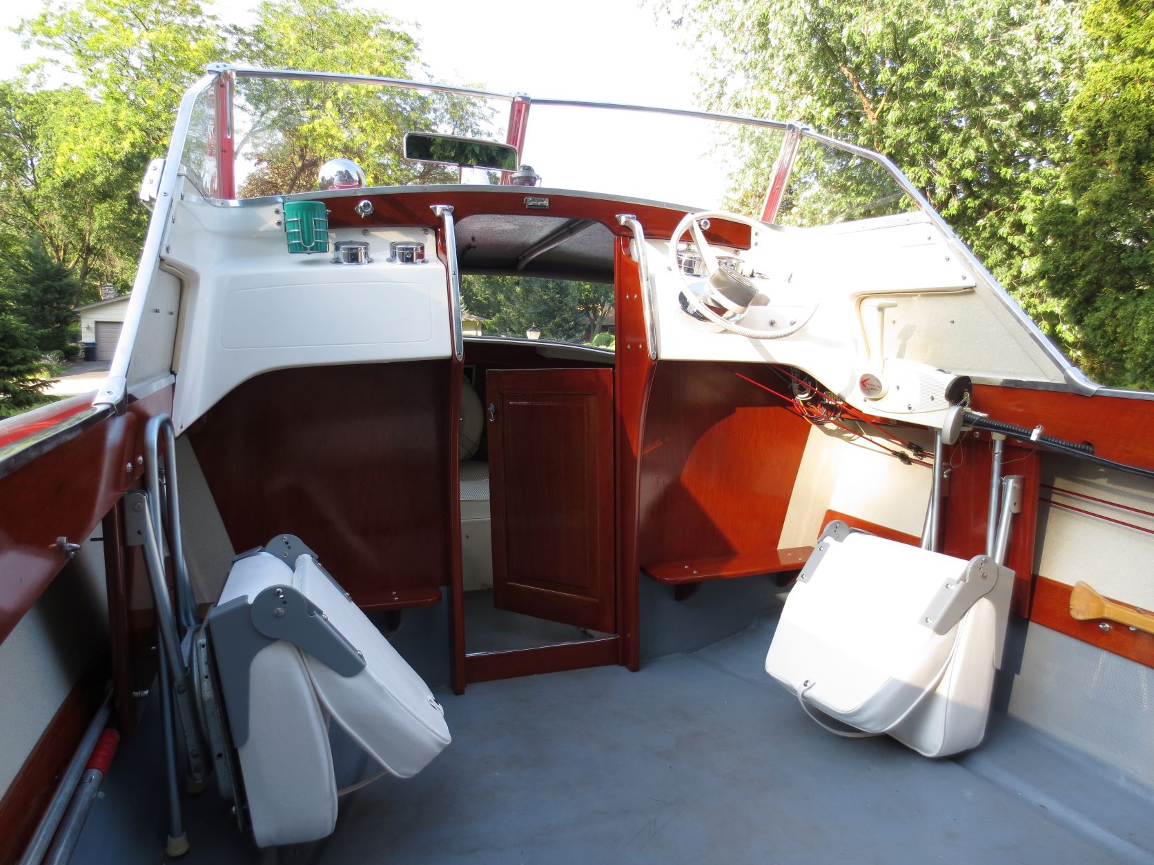

John from NC has had a yearning for Sedans after first seeing one as a young man in 1962. I want a set of those deck chairs for Mama Mia!
Years later that dream was fulfilled.

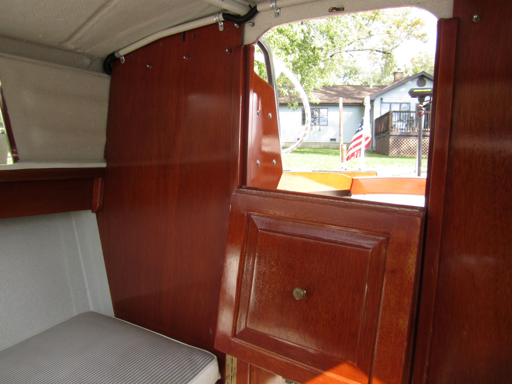

Okay SeeDan...this may be more detailed than you need or want but like Terry said, it sounds like you want the original style door. Also, I think it would be helpful for others to see full measurements of the door for posterity. I can't tell you how many Seafairs I saw with missing doors when I was looking for one, so for a person interested in a full on restoration, I think it is good to document these things so others may properly replicate them. That's what this forum is all about. Others have certainly helped me. So here you go.
The side of the door has a half lap joint where the top half and bottom half of the door meet. This allows the upper door to swing in to the cabin with the rest of the door still closed.
Like So

Also there are knobs on both the inside and outside....both are attached on the same through-door threaded rod. Centered at the top of the upper door is a ball catch to hold it to the cabin roof header.

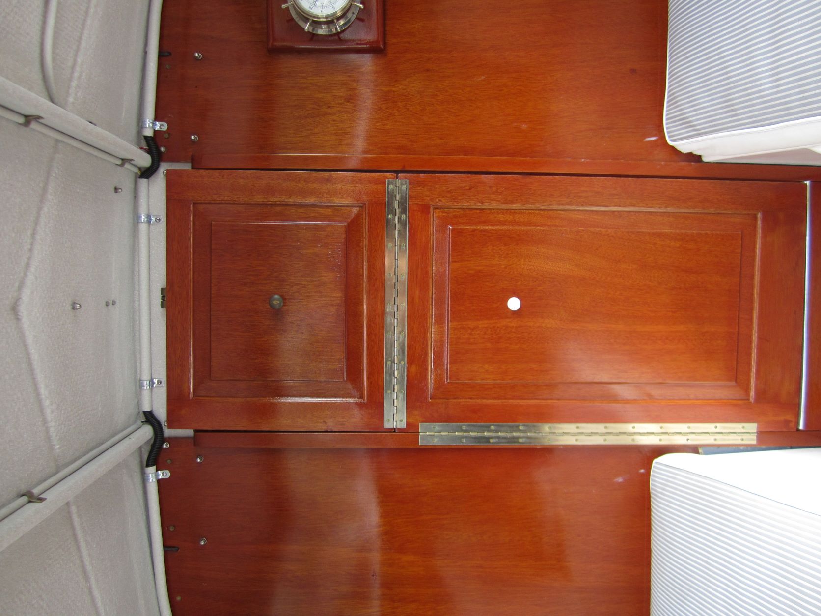

The door on Mama Mia is original to the boat but I replaced the hinges with a piano hinge.
One tends to really lean on that door when underway and entering or exiting the cabin.

Now I’ve got door envy. Ugh! Thank you Eric for the dimensions and drawings. I like the idea of keeping to the original style and having the top portion flip down for airflow and conversation. I’m in the process of building a wood working shop; pad gets poured on Thursday and the building arrives in about 3 weeks. This will give me some time to source the wood. Terry, your friend John knocked it out of the park his cuddy door. It’s so nice I’d put a life jacket on it each time I cruised the boat. As mentioned I will post some pictures this week of my project boat along with two additional Glasspars of mine. Can anyone really have too many vintage boats? Nope.
