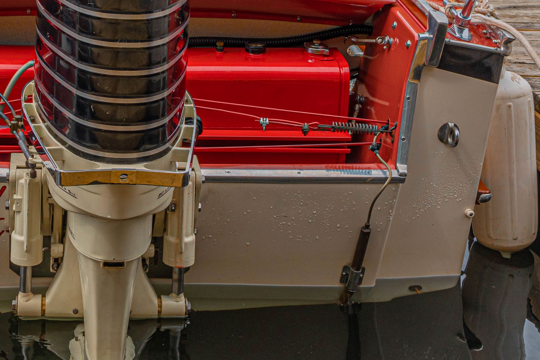

I knew I had a valve on the speedo line at the transom and assumed it was a damper valve. When knob is turned CW you don’t get a reading. Its a simple needle valve.
But as you mention they refer to it as a bleed valve.
This instruction sheet refers to it as useful in bleeding the lines with a through hull pickup.
So, I don’t know if you need it with the transom pickup. Looks like they sold the speedo kits and did not include that valve.
